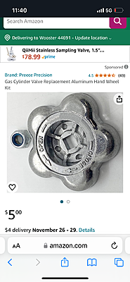

ID:	621390 Might go this route:

      And try to connect it to the a remote line ASA on/off “spinner”

        That might be a more usable route (and easier to service on the field). Some of those remote ASA have a setscrew holding the knob, it would be easy enough to make a little adapter to mount that valve knob instead.
