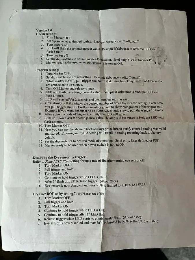

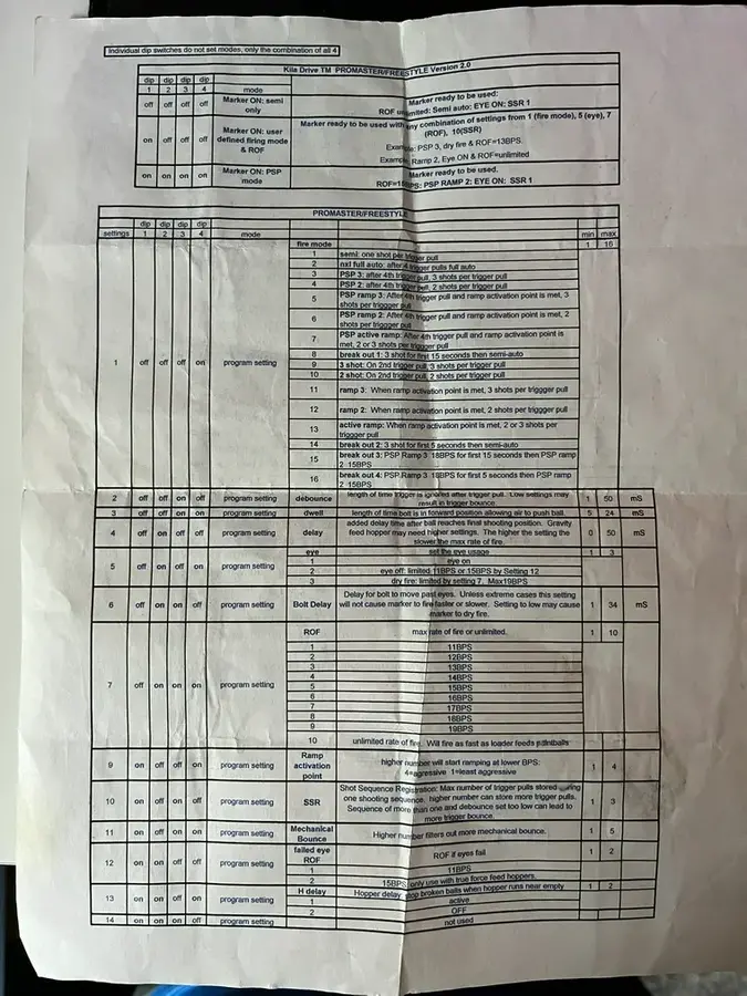

ID:	637880 Click image for larger version
ID:	637881 I had a kila board in my Promaster
                i played a local tournament and impact ref the event, I had Bart get a ref to check my gun twice thinking I was ramping. They could’nt get it to ramp lol
                stock board
                kila board below the stock board
