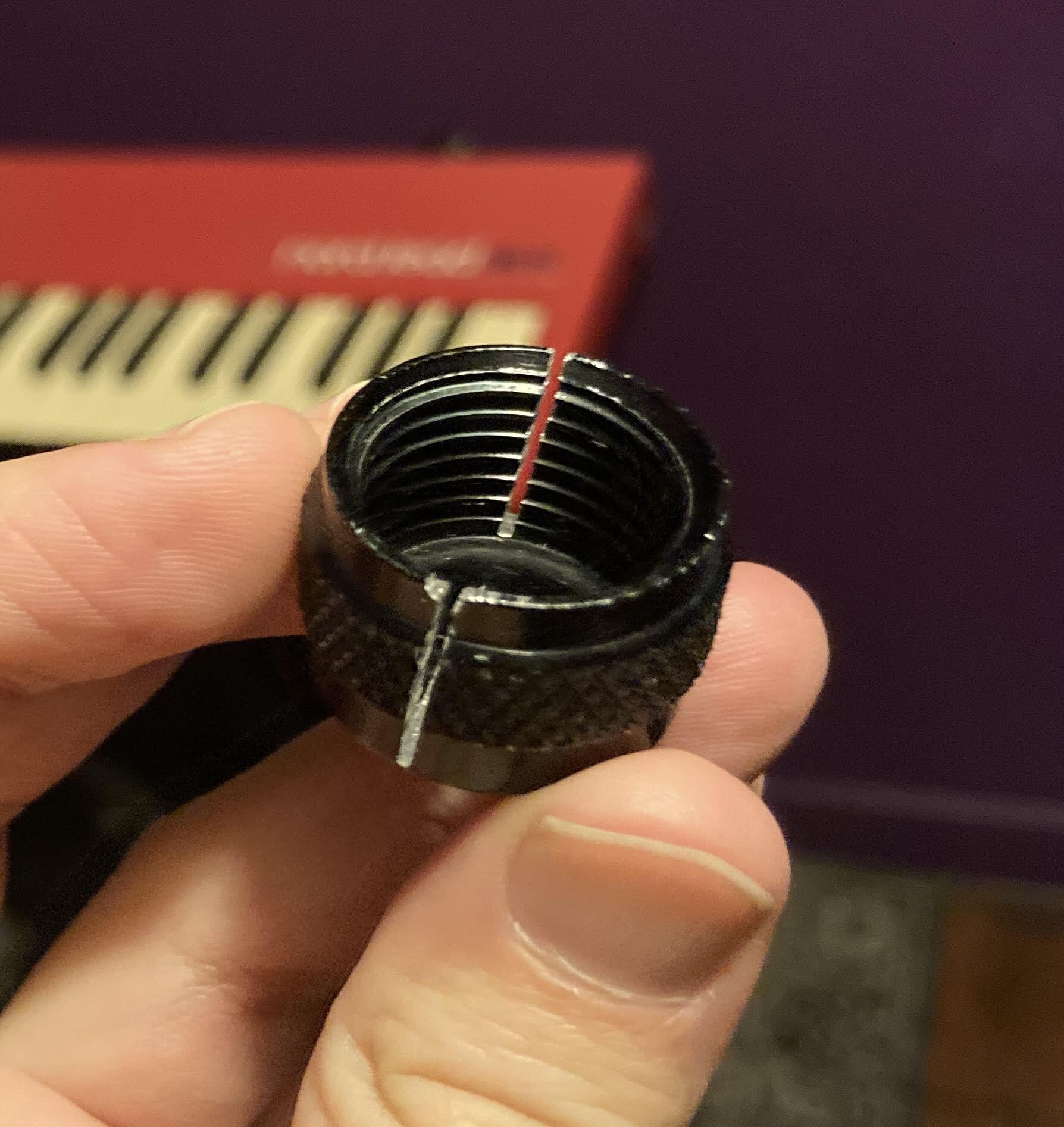

        I took an old aluminum tank thread protector and cut a slot through it with a hacksaw. Thread that on, clamp some vice grips to the thread protector, and voila! No need for fancy thread pliers etc.
        A strap wrench or soft jaws in the vice will be helpful for holding the base if the above trick isn't enough.
        Click image for larger version  Name:	qweqwe.jpg Views:	0 Size:	277.7 KB ID:	640762
          This is clever

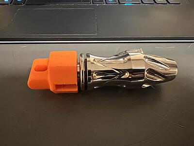

              Staunchy just put this on his website and I picked one up to try it.
              https://stanchy.com/collections/tech...h-safety-block

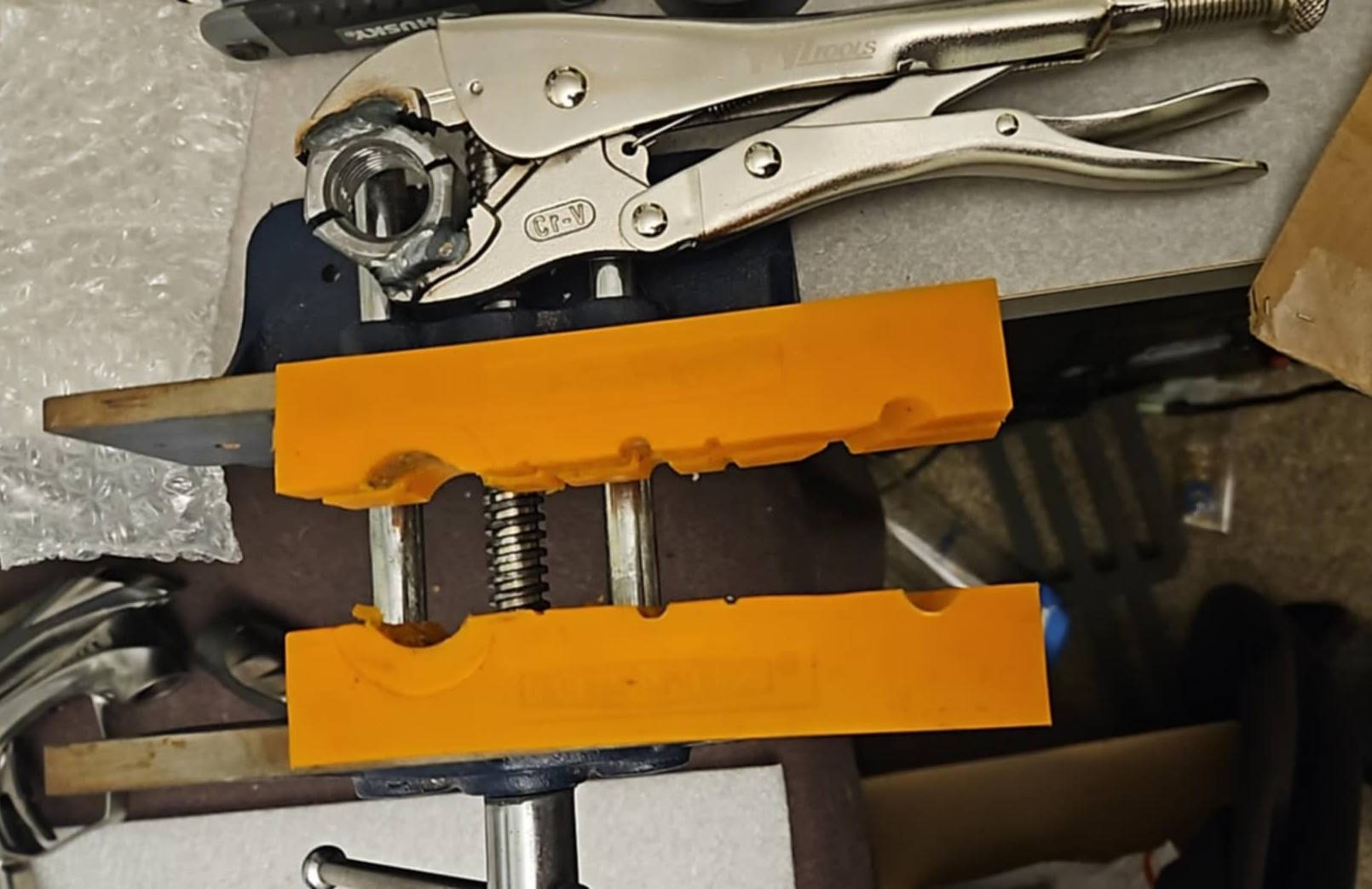

                  i've never had luck w/ strap wrenches and prefer something more... definitive, so
                      I have one of these on order. There was a guy on one of the autococker FB pages that was making some and I couldn’t pass it up… even though I will use it all of 1-4 times probably ever haha.

                      I tried the Staunchy thread protector tonight and it worked great. 👍
