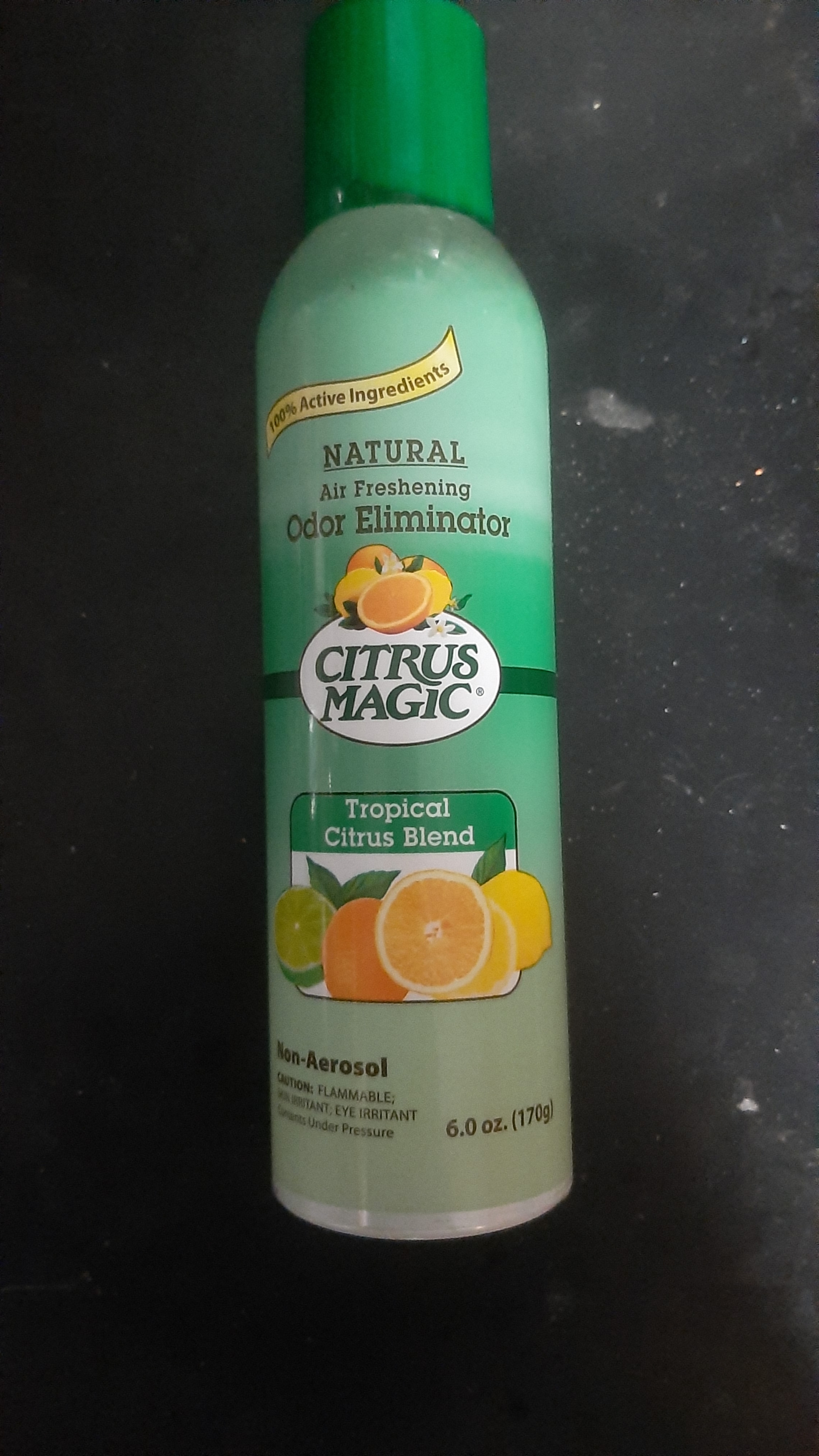

                • capitalpaintball
                  • 309
                  • Coventry, Rhode Island
                  This is what i use . You can get it in most markets on the Click image for larger version
ID:	662772 air freshener isle
