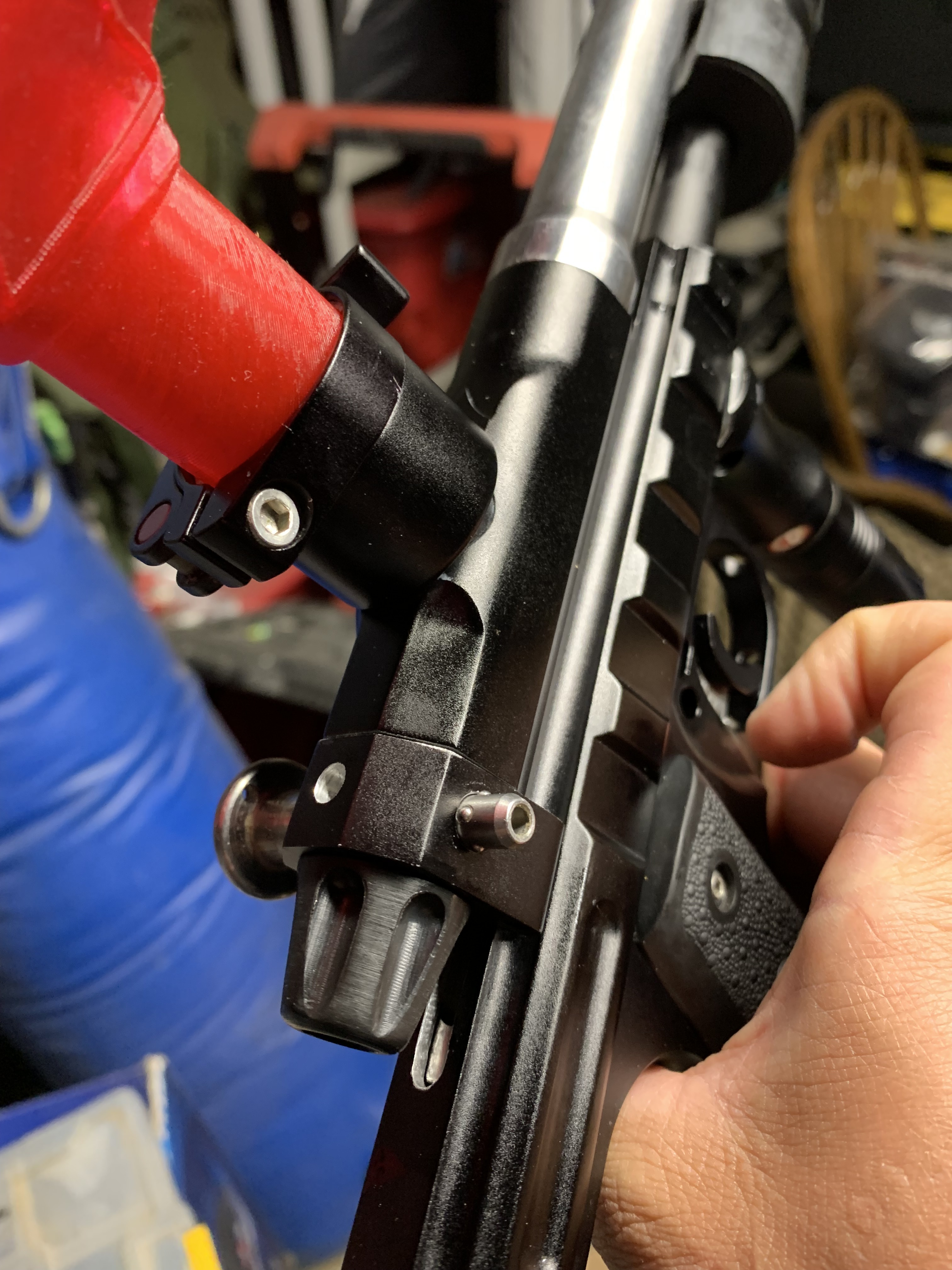

    My brother has had this Carter sniper for a few years and everytime he brings it out for the few times a year he plays it’s always performing horribly. Finally he let me take it home to look at it and what a mess.
    off the bat it’s slightly midgited but not to the point that it needs custom length springs. The valve slightly over travels maybe an 1/16 past the proper position for the valve retaining screw position when the valve nut is tightened. Everything seals and the gun cocks and shoots.

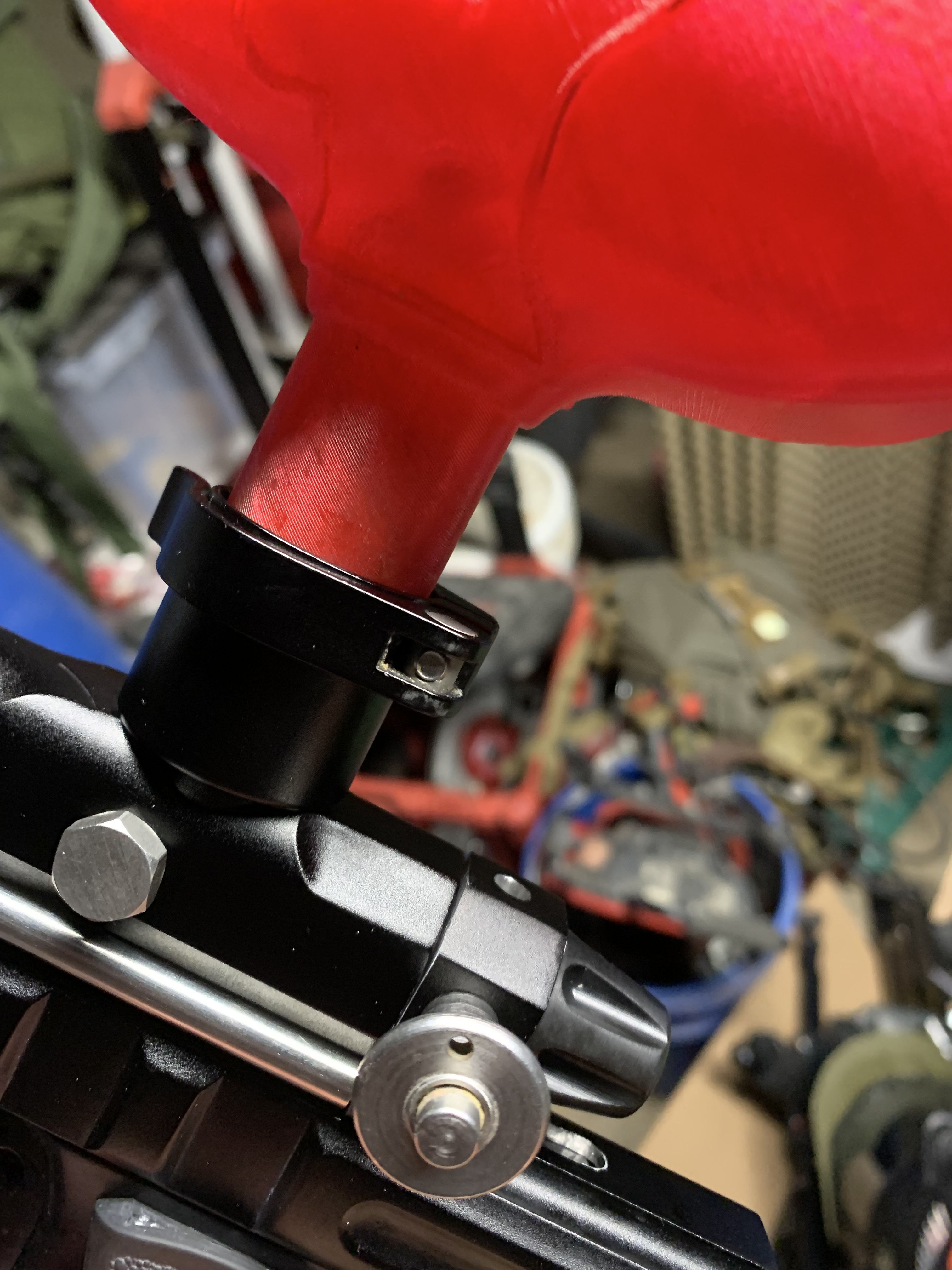

    now for the really bad. The body isn’t milled to standard half block specs. The back of the top tube is cut at a slight angle so it’s not completely flush with the sled,The slot it cut too short.The top tube is slightly too long in combination with the sled having too much material in front makes it so the bolt barely closes flush with the end of the feedneck. The ball doesn’t even load into the barrel it sits in the breech on a close bolt causes a ton of blow by around the bolt and also launching the ball right into the bore sizers which causes constant barrel breaks or hook shots. The bolt has no orings and possibly bored out too much to add them but maybe thinner orings will work , it also has a huge transfer port for no reason other than I think to not deal with actually lining up the holes properly. Of course it’s all match anodized a satin black which I’m sure wont be easy to match plus if anything in the body has to be cut it’s going to be raw.
    If anyone can brainstorm and think of the least intrusive and least expensive way to fix this if possible. I would like to think a proper length sled would get the bolt to the proper position so I can use the Carter bolt and keep the aesthetic and most of the original parts. The only issue being that the original holes for the bolt pin might be too close to the edge of the new sled. So it would have to be redrilled for a vertical pin
    im thinking worse case scenario, cut to standard half lock specs, new sled and bolt w/ orings and standard specs, and possibly and 11/16 bore, not that the lower tube is a priority at this point. I just want it to be usable

      Seems like the simple solution is a custom bolt.

        The only issue with just doing the bolt is that just making a longer one would mean it wouldn’t cock far enough back with the current sled and body slot to load a ball. Right now it cocks just enough to load a ball with the short Bolt

      Can the sled be turned around? It looks like that would move the bolt slightly forward, if the "mushroom" end doesn't stop it.

          im thinking take the bulk of the material off the front of the sled and take a hair off the back of the top tube. It should at least get the ball into the barrel, seal the breach more and not change any of the cocking geometry

          It sounds like it needs three things: Either a custom valve body, slightly lengthened from typical 9/16" specs, or just bored out for an 11/16" valve. The cocking pin slot needs to be lengthened, and a new bolt made.

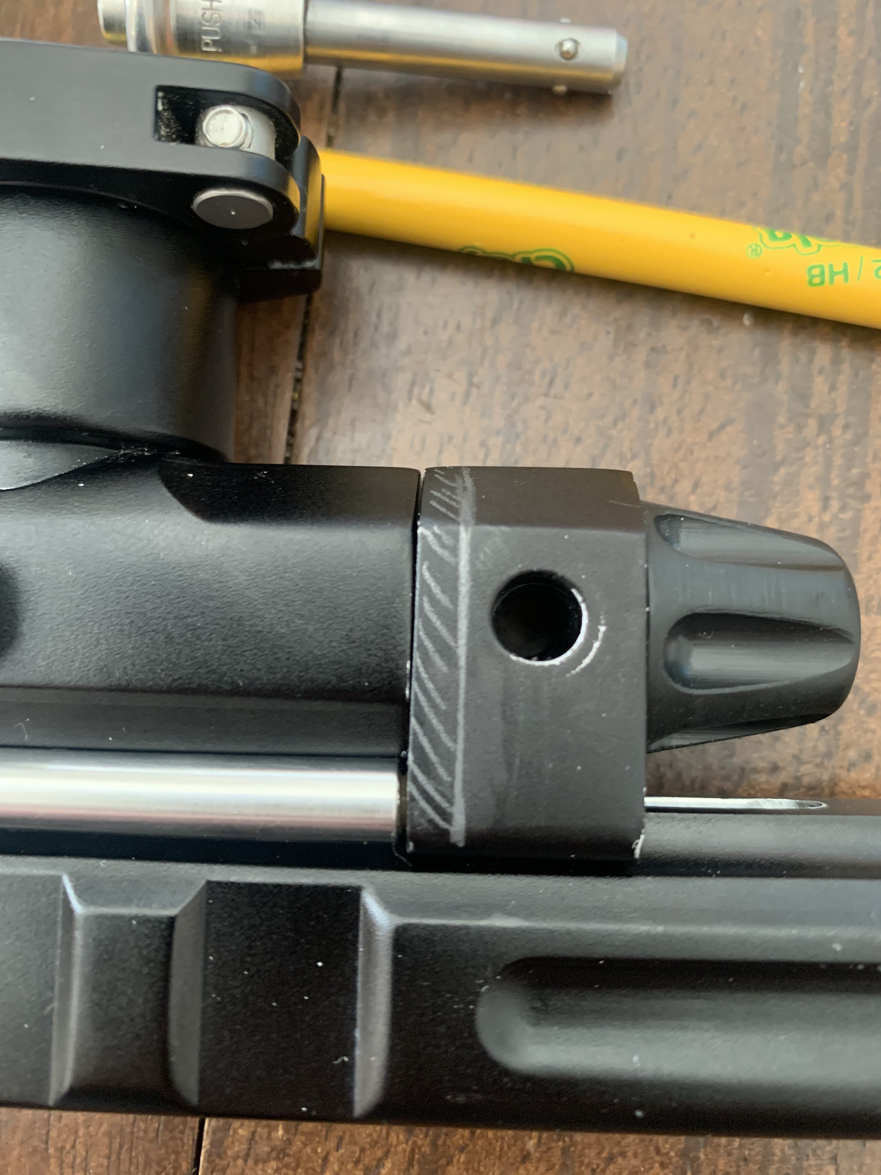

            Ended up milling the front of the back block/sled and lengthening the body slot. I didn’t touch the body at all but you can still see the gap at the top of the body where the cut isnt straight

              Was probably the easiest way to fix it.
              looks good
