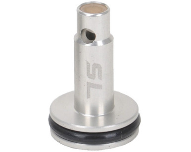

        I just googled to get a pic of the DM seat and found out that ANS carries them for .99 apiece. I'm going to buy a dozen and call it a day for those. Here is a link to the one I just had to replace on an ego:
        https://www.ansgear.com/Planet_Eclip...SABEgJPXPD_BwE
        When you've replaced them with orings or gasket, did you just match the height of the original?
