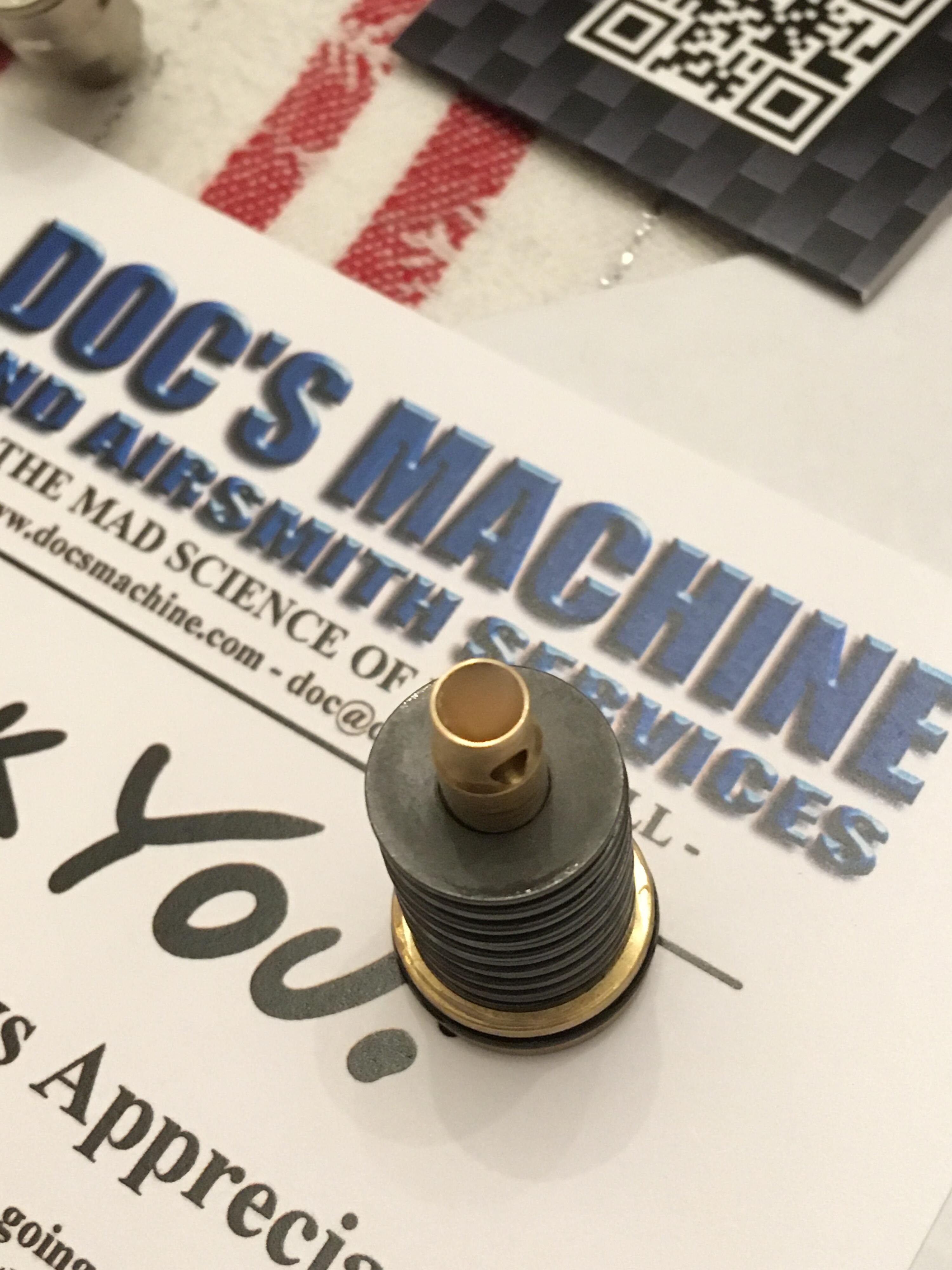

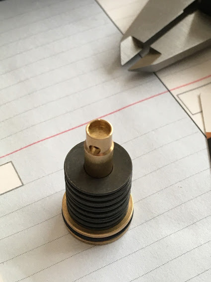

    I've got a regulator piston that lost the seal on the tip of the stem. Does anyone know where to get a replacement? Or can I make my own? I can punch out discs of material. I just need to know what it's made from.
    This is my piston.
    This is the part I need.

            Yeah, I've found plenty of regulator seats for sale, but no PE ones. I'm hesitant to buy something else to just see if it fits (although since they're only a few bucks, I should probably just go ahead and do that). I do have a random assortment of old regulator pistons from various tank regs that have died on me, but most of them are too small to fit in the PE piston.
            If I can't find something that fits, I guess I can at least buy a whole replacement piston. They're $30, but that's still cheaper than a whole new reg.

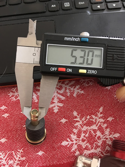

              Tell you what....does anyone else have a different kind of piston (Autococker, spyder, etc.) that they could measure for me? Look like the tip of mine is 5.3 mm in diameter. If someone else has a similar size, then maybe the regulator seats are interchangeable.

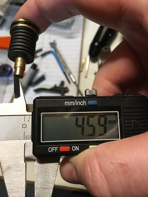

                Can you get a measurement of the actual seal? Like an ID/bore of the end of that brass piece?
                That looks a lot like the old RG-1/Equalizer piston, and the seals I made for those are approximately 4.6mm. I have a ton of those laying around, and even if the seal's a little larger in OD, I can punch more as needed.
                  If you want, send me that piston and I'll make a batch.
                  Doc.
                  You're spot on, Doc. 6.4 mm ID. Do you ever get tired of being right all the time?
                    -It's a burden, all right.
                    It gets easier when somebody shows a picture measuring 4.6mm but types it out as 6.4mm.

                      Looks like the reg seats from Doc are a perfect match for the Ego reg piston. Do I need to super glue them in there?

                        -No. They're supposed to be a light press fit; that is, they shouldn't fall out if you turn the piston over.
                        In use, air pressure, air flow and the spring pushing it against the seat, all hold it in place.
