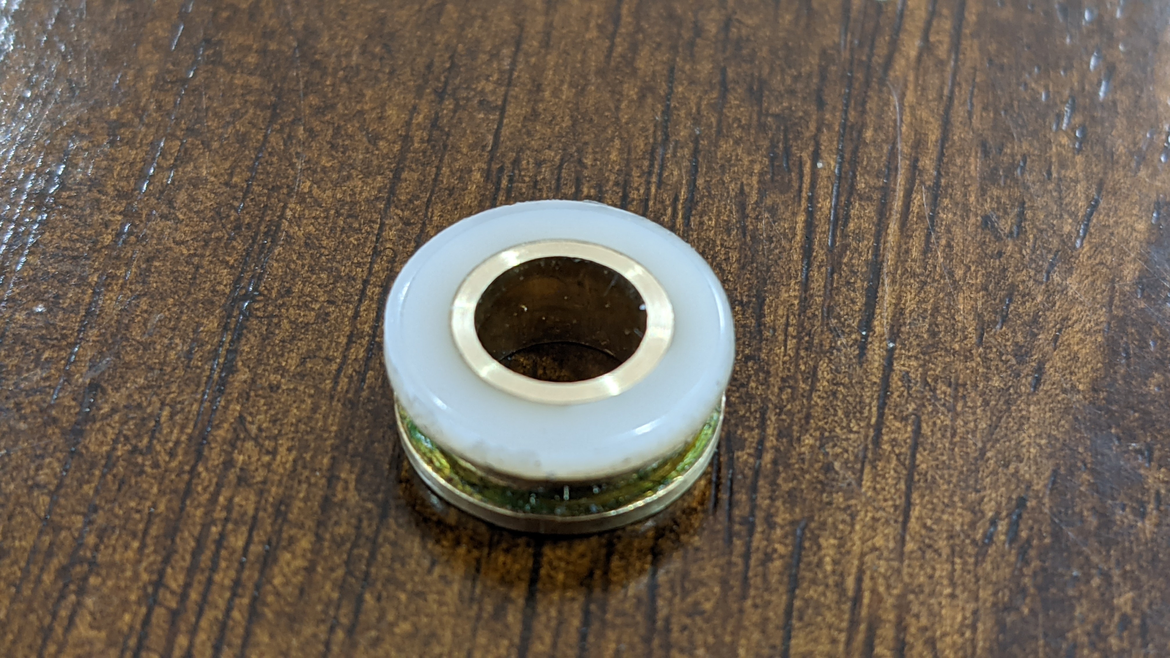

            Okay, I dug out and dusted off my collection of Montneels... and it would seem I only have one complete valve.
            I've had two in-parts Z-1s for a good number of years, I may have taken them in trade for other work. I've been meaning to resurrect them, but with a 100% functional Mega-Z, and 'leventy million other projects, I just never got around to it.
            So I cracked open the Mega, for very likely the first time in... well, this century in all probability, and opened up the valve. Here's the cup seal in question, for those curious.
            It's a polyurethane O-ring pressed into a groove in the face of a brass disc, and then roll-crimped. The crimp is vital, as it keeps the O-ring in place. I suspect that, from what you fellows have said here, that it's not a simple case of just prying the old goop out, and pressing in a new O-ring. I have a castable polyurethane I could probably inject in there, but I believe the correct fix is to make a new assembly.
            The O-rings (which I haven't measured yet) are almost certainly off-the-shelf, so we just need the brass bit. That is easy to fabricate, and I can easily pop off a small run of them, including new O-rings and roll crimping, so you'd get a ready-to-drop-in new cup seal.
            If that works for you gents, let me know- not a preorder of course, but tell me how many you'll need. If there's enough demand, I'll set up the CNC and crank a big batch.

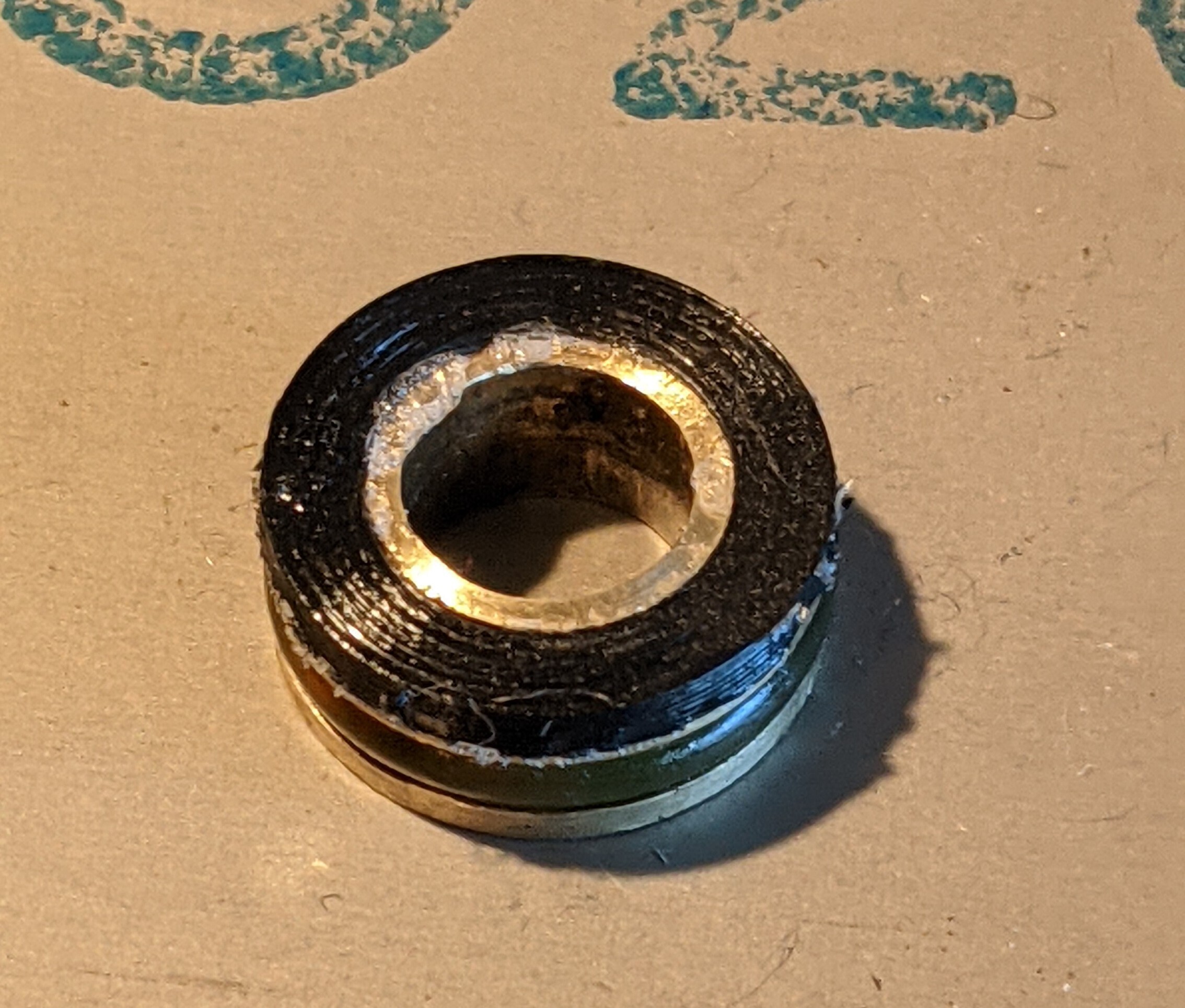

                Originally posted by Brokeass_baller
                I can get some scrap delrin at work, and I have a small hobby lathe in my basement shop.
                The ones i made out of delrin didnt seal, its a bit too hard. But the 3D printed ones did work perfectly, but it does require to machine the cupseal a bit to fit.

                And the 3D printed:
                PS: i do have the Solidworks CAD of the brass cup i reverse-engineer if there is interest.

                      Rough prototype to start nailing down some of the specs.
                      It's close, but not perfect- note that it's too tall.
                      I also don't have the right O-rings. I have generic Buna-N, and a few soft poly in the right size, but the center O-ring at least needs to be fairly stiff. I'll order some, though the holidays will slow that up a bit.
                      Once I have some proper O-rings in, I can nail down the dimensions for the brass bit a little better, run a couple test pieces, try 'em out, and then crank a batch.
