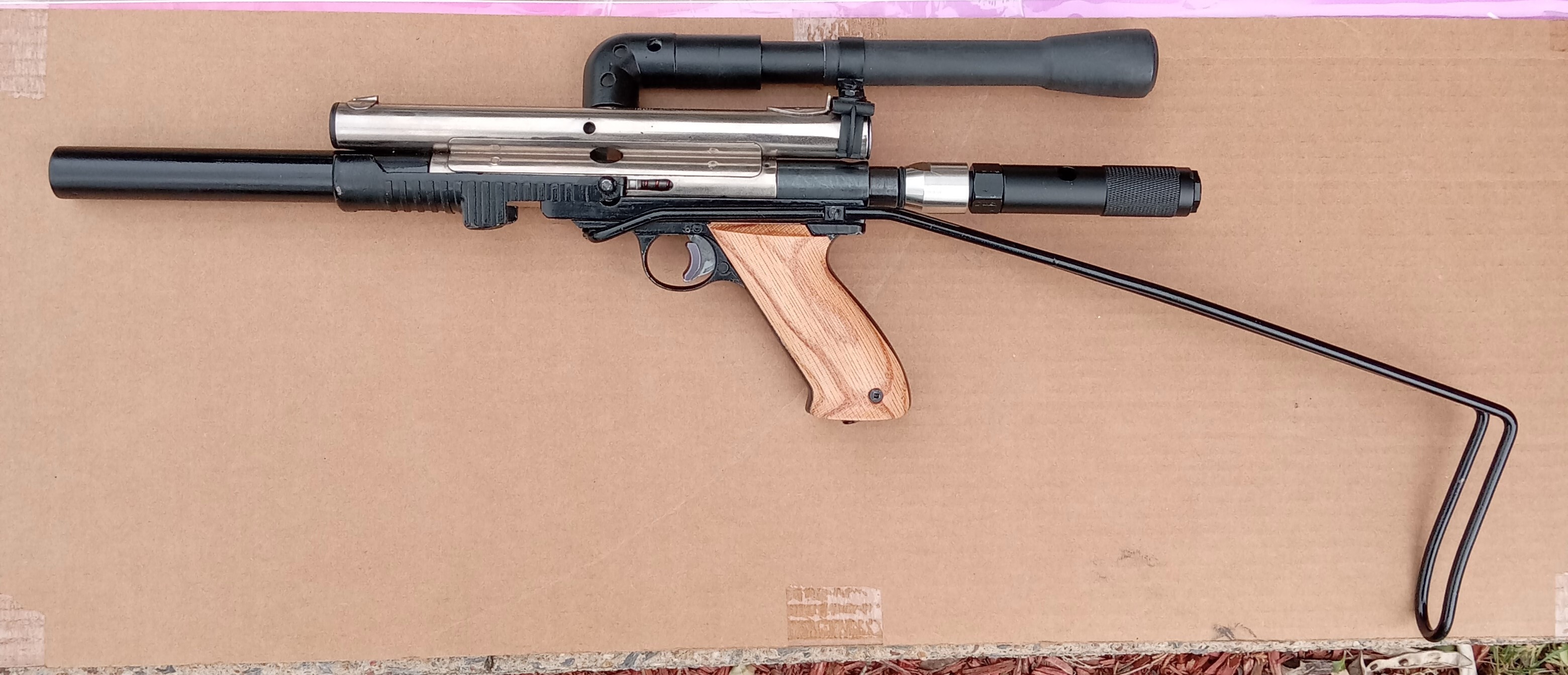

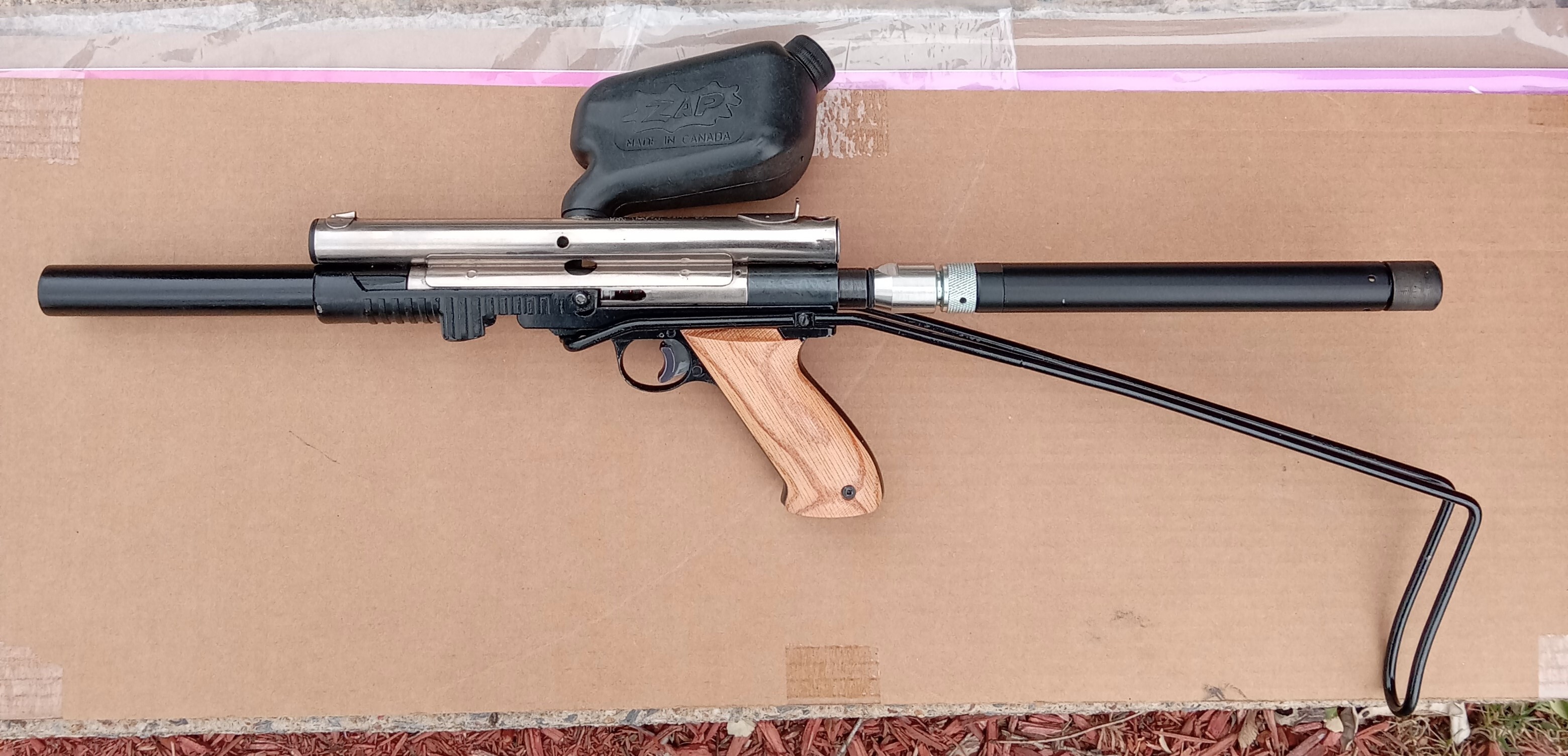

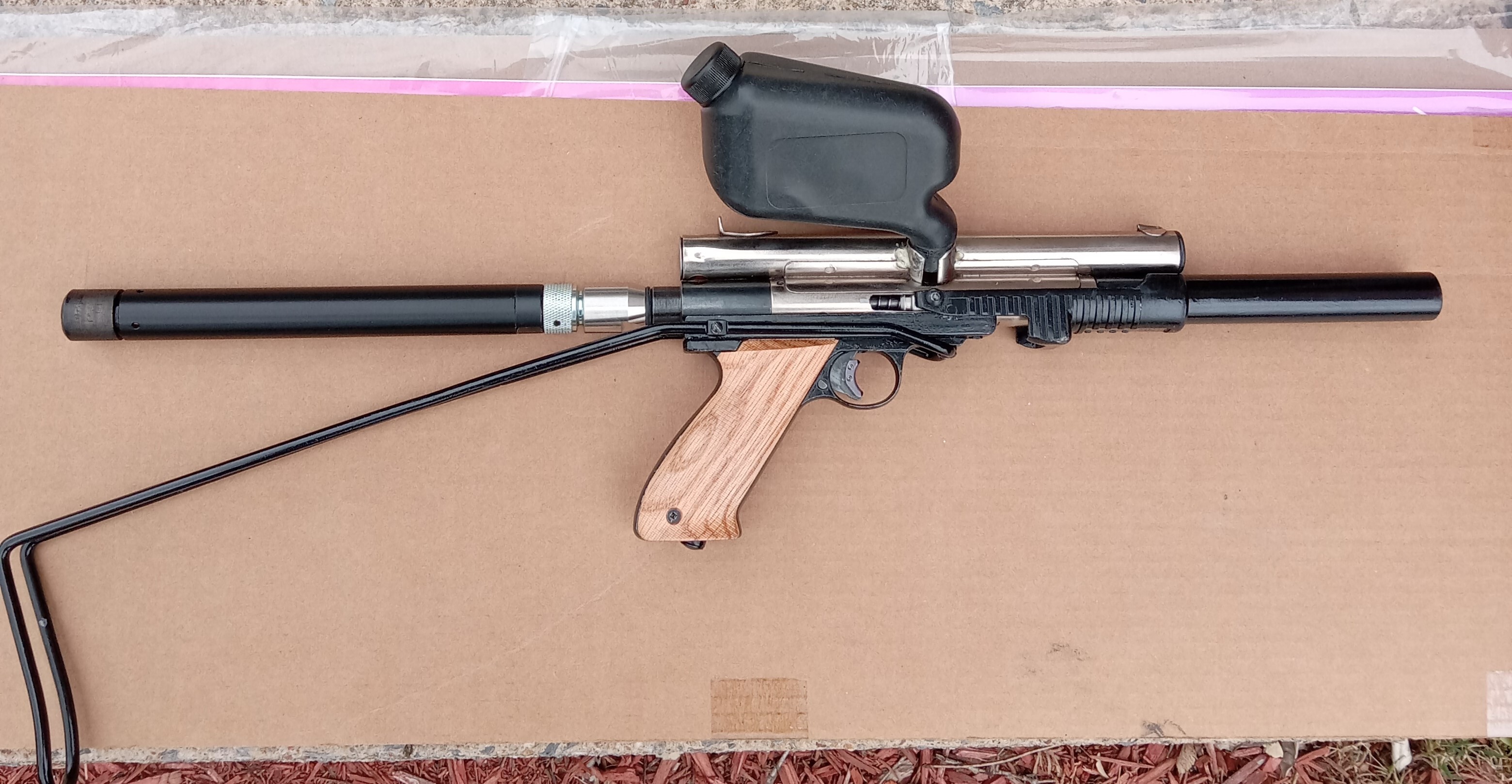

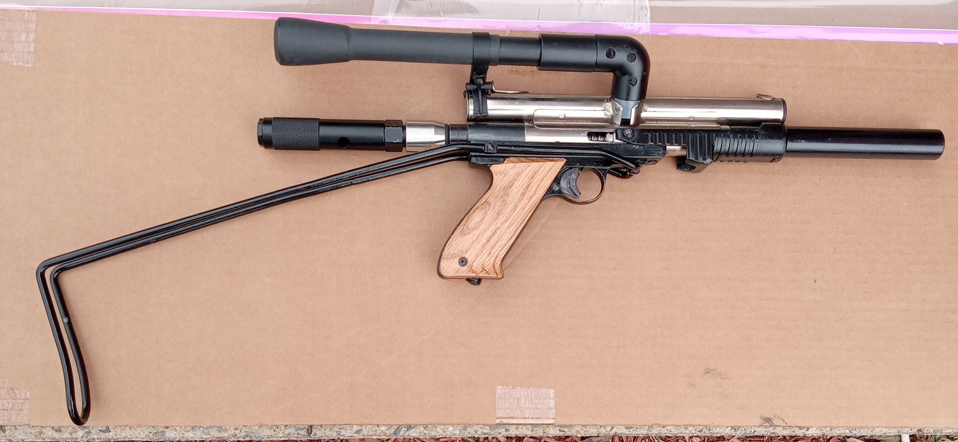

    ....on my Nelspot...
    flyweightnate made me these grips I won for Walzmas, they are awesome.
    (this is the only pump marker I have in my collection)
    Stock Class Setup
    Modified or Open Class Setup
    Specs on the 007
    polished body
    quick strip slot
    slotted right side
    double tapped bolt
    dual armed pump handle made from broken Nelspot pump handle
    CCI Paintball red main spring
    Lapco #6 powertube
    Lapco valve retaining screw
    Black Magic valve cup seal
    WGP trigger shoe
    Nelspot wire stock
    7.5” extended barrel
    back bottle adapter
    12 gram bucket changer
    Airsource dual 12gram changer
    JT Paintball airgun to paintball asa adapter
    welded in hopper adapter
    Zap pocket hopper
    horizontal feed adapter​

    Love it! How does that dual 12gr changer function? That thing is crazy!
        It was actually designed for Airguns, the end screws off, and 2 CO2 Cartridges go in butt to butt (1st one inserted facing in, 2nd one inserted facing out). There are puncture pins at both ends.
        The tube has another tube inside, gas from 1 Cartridge flows directly into the ASA, gas from the 2nd Cartridge flows between the inner tube and outer tube and also meets at the ASA .
        The only reason I was able to make it work on a Paintball Marker, was because I found an Airgun to Paintball ASA Adapter.
        With the Nelspot Stock I could not fit a small CO2 tank on there, this was the alternate plan. Turns out, 2 Cartridges are just enough for the 50 round hopper.

          That's brilliant. Thanks for explaining it!
