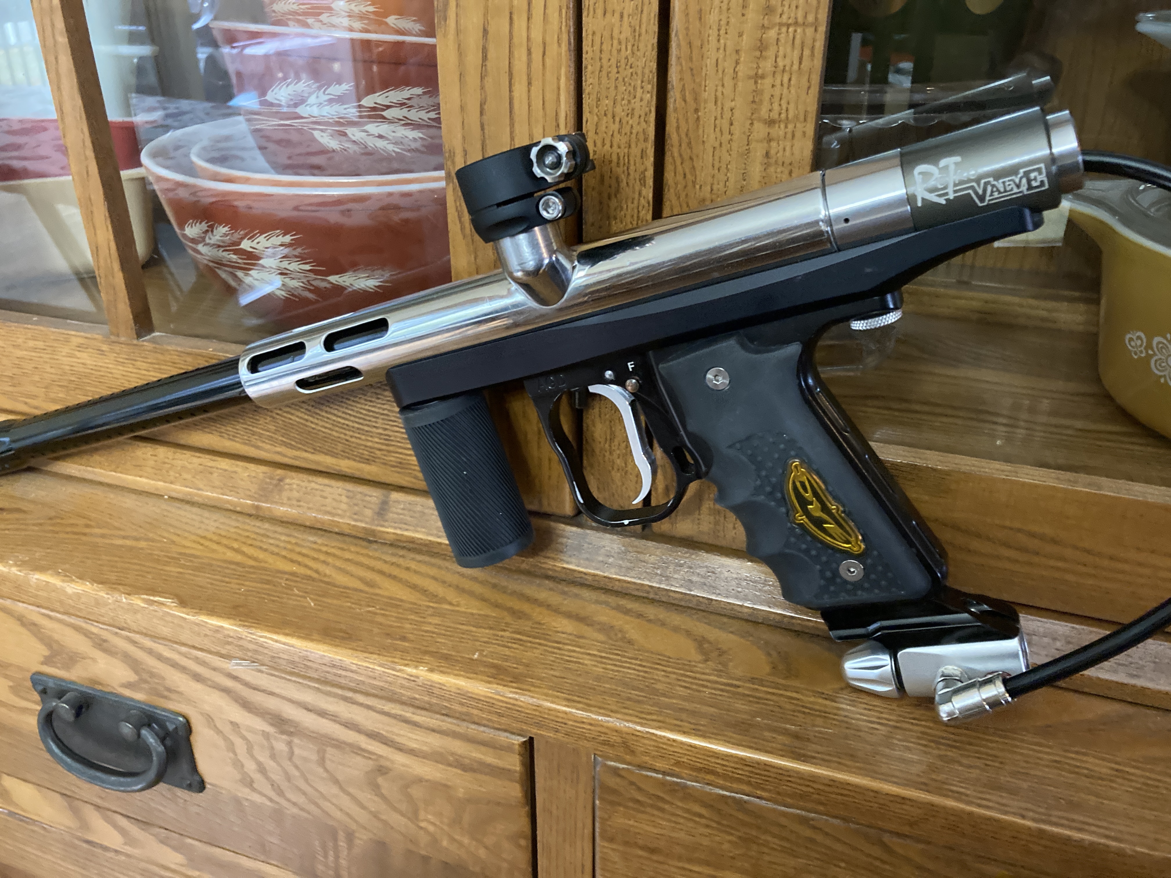

    Original tester detent still going strong. It lives here right now:
    Well over 10K shots on the original detent.
    I have also installed a handful in customer mag rebuilds and every person has been thrilled with them.

        My original detent lived through another big game where it was loaned out. This is the gun I lend out for casual play these days. It is trouble free and easy to understand. Shoots any paint good and doesn't break balls.
        Updated shot count.
        Updated picture of it's home too: Click image for larger version
