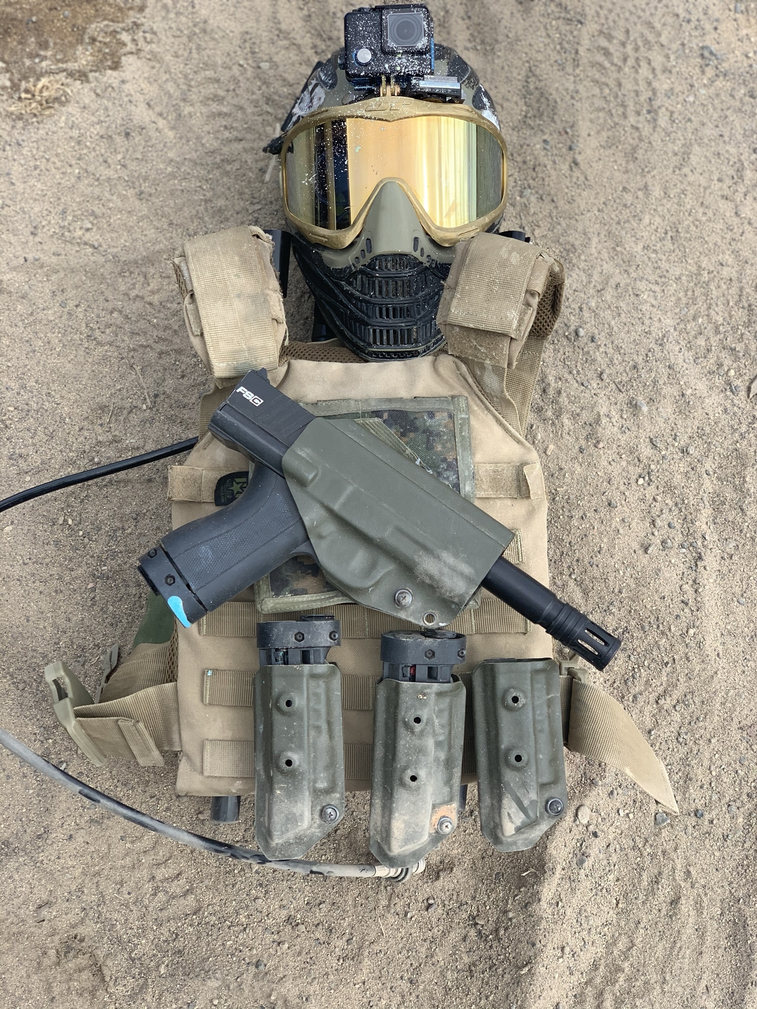

ID:	471213 I’ve run cO2 on 98s and A5, a really long time ago. Got the job done but wasn’t perfect. I made the switch to hpa and space guns pretty quick.
            I do use cO2 on occasion with my FSC. A lot in the back yard too. It shoots FS really well.
