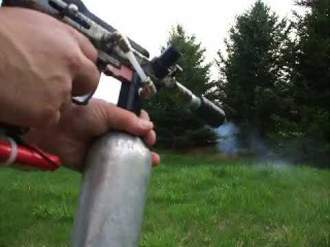

        I was able to dig out this 20 year old video:

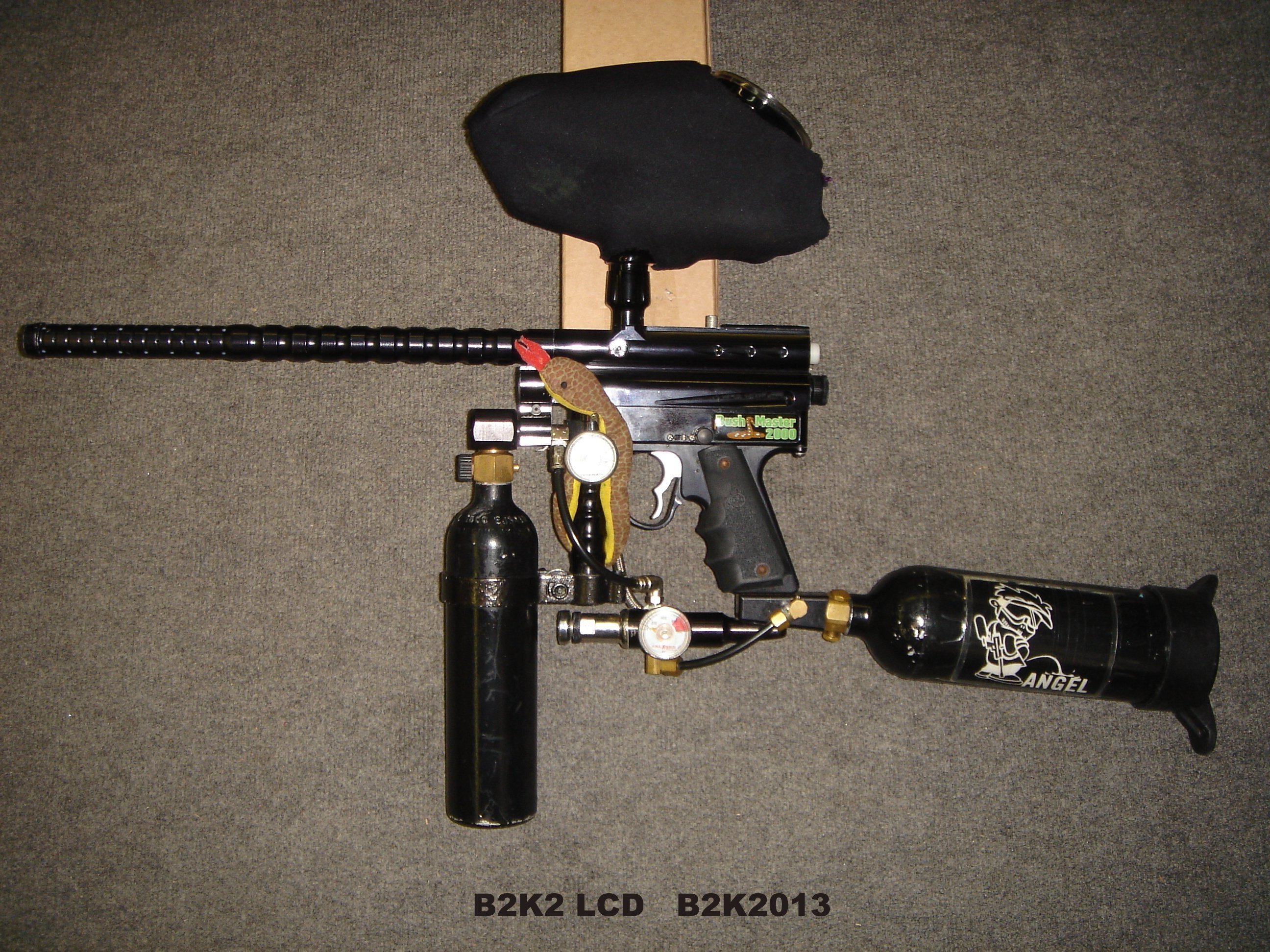

          If I am playing in the woods I run co2 on everything. I have shot co2 on the is B2 since 1999. Anti-syphon 20oz into a secondary reg set to 600psi. Gun runs at 350psi. The second vertical bottle was because I needed more air at the time, its no longer on there because I dont shoot that much paint anymore. Click image for larger version

          • Myrkul
            Myrkul commented
            Early B2Ks are also just straight up monsters though. The later models I've worked on lost the magic some how, I've rebuilt at least half a dozen B2k4s and a few defiants, and they are just meh. The og B2K though... Unquestionably my favorite electro. They are wildly underrated guns across the board and just keep working for almost ever.
          • Brokeass_baller
            Brokeass_baller commented
            This is the most beautifully overcomplicated thing I've ever seen in my life. 2 ASAs, just to run a bottom line reg, so you can use a vertical expansion chamber and plumb a second tank off the front of it? Wonderful.
