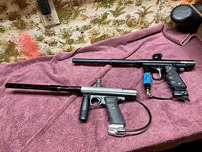

      attatched a pics of both my classics. Ones a power feed classic. And the other is essentially upgraded to be a RT ULE custom but still running a classic valve with LEVEL 7
