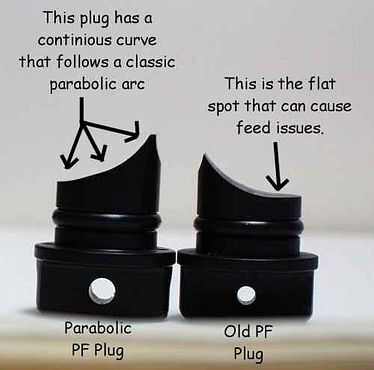

      By the way, if you're using a power feel, make sure that you have the newer style plug with a parabolic curve to it. The older design can lead to feed issues, especially with a force feed hopper, which might seem counter intuitive. I'll try to insert a picture here.

        Long story short, you're going to want the right powerfeed plug, the more modern long-nose lvl7 bolts, and you're going to want to use an angled ASA with foregrips (expansion chambers) to keep liquid out.

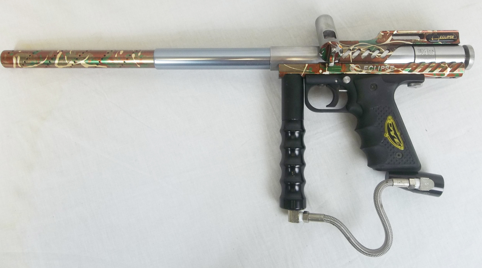

        Here's an example of a mag that's setup to play well on CO2 (angled ASA and foregrip).
