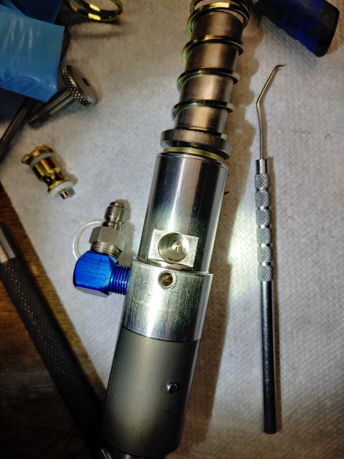

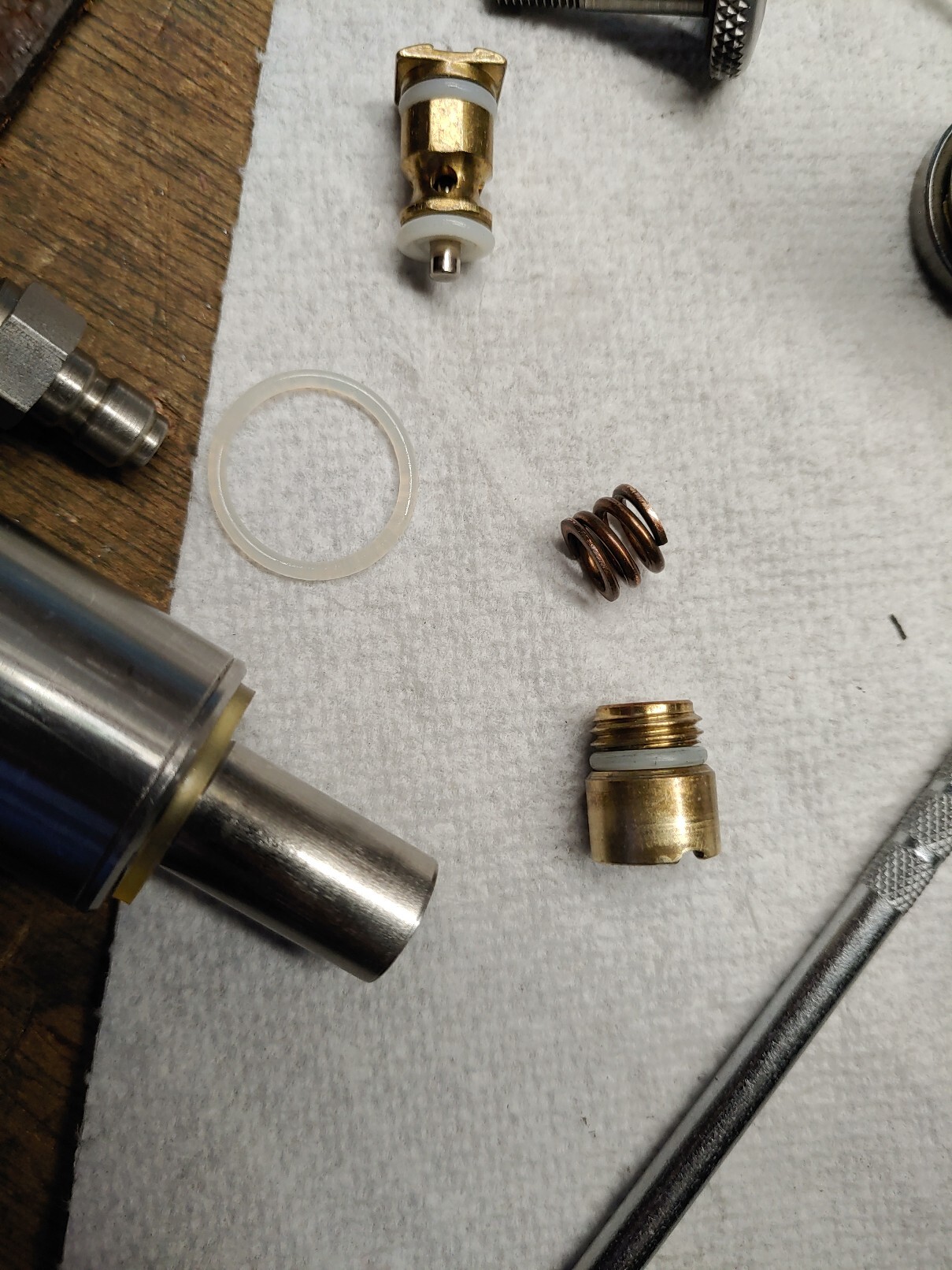

    Today I rebuilt my emag valve that worked fine, but orings were breaking apart..it was time.
    This emag valve had some unusual things inside:
    -there was a spring in the power tube(unlikely to be from the factory)
    -there are two on/off oring(inner and outer orings) on top of the on/ff assembly around the pin, not a quad ring
    -the power tube portion of the valve body was unscrewing
    There is a 750 pin
    Anyhow, after rebuild I aired up. Immediate gush of air from the barrel. Also noticed the sear/trigger did not go forward.
    I swapped a power tube spacer from a working valve, no effect.
    I made sure the power tube assembly on the valve was snug.
    When I pull the on/off assembly, the pin and orings are suck in the valve, the assembly itself comes out. Too tight?
    Anyhow, I'm not sure where to even start now. All new orings throughout this entire thing and it worked fine before. In about ready to give up after so many hours now.

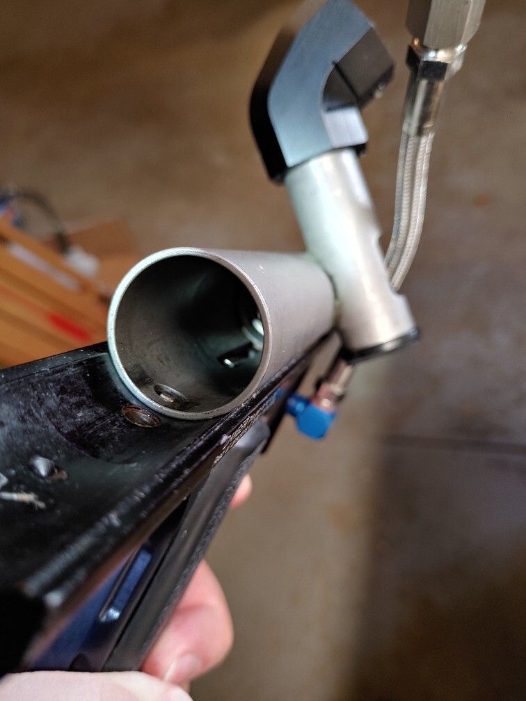

        Since you said that the trigger would not go forward, and there is air going down the barrel, the on/off is not sealing. Either the o-rings are not sealing (top of on/off pin and o-rings inside the cavity), or the trigger is mechanically limited/constrained from pushing that on/off pin up to seal against the o-rings. This led me to believe that the rail bushing was missing.
        Can you post a picture of your rail and trigger/grip assembly?
    • dano_____
      Tinker Tinker
      • 316
      Dont worry about it not being a quad ring. The standard Teflon ring works fine for a non-emag frame and the quad is oy.necessary if you're using email lowers. Not too tight, though I usually insert the big oring in the on/off and then the little oring before pushing the assembly in. I make sure the pin isn't stick up and into the orings like you have pictured. Then when it's all inside the valve, I push up from the bottom enough to allow the valve to be inserted into a body. Make sure you use a good amount of oil on those new rings.
      As for the powertube, the spring is the old way the orings were held in place. You appear to be missing that oring for the bolt to seal. It should go oring, spring, then screw in the powertube tip. They were replaced with spacers at some point due to springs wearing out.

        • Advanced
          • 73
          Secretweaponevan
          I confirmed the bushing is in place. Took a picture showing down the body, can see the sear inside.
          This worked fine before I did the rebuild on the valve. I'm using a intelliframe w/750 pin.
          Thoughts?
          I am waiting to get air on Friday, but have replaced the orings again for the on off and also the body and also on the regulator nut.
