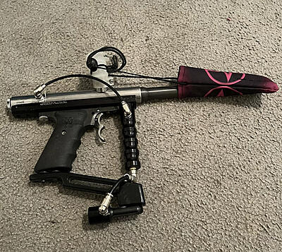

1st time automag, what do I need to know?
  • Tinman74
    • 393
    Just purchased from eBay and I’m planning on using it June 25th.
    1. How do these do with rec ball paint?
    2. Can I use CO2 with a remote?
    3. will a halo be too strong? I also have an eggy and a ricochet.
    4. what are the must haves? I read something about premium urethane orings?
    any help is appreciated. I’m hoping my 1st attempts with an automag will ba a good one!

            That's a nice looking mag. Your mileage may vary with that cut grip frame and double finger trigger. I tried one just like that on mine, but the trigger didn't engage the rod consistently and gave it a weird feel. I ended up reverting back to my original frame and single finger trigger. As superman and rawbutter will tell you, the trigger/sear geometry in mags is a more complex and precise thing than its apparent simplicity would lead you to believe.

              • Tinman74
                • 393
                I ended using my fleet of Piranhas because they like Co2 and forgot I had this in the garage. The first time I put air to it from its eBay owner and zero leaks, it shot reballs off co2 in the basement. Should I be surprised or are these things that good? I got this mag 6 months ago and never touched it. I’m impressed
