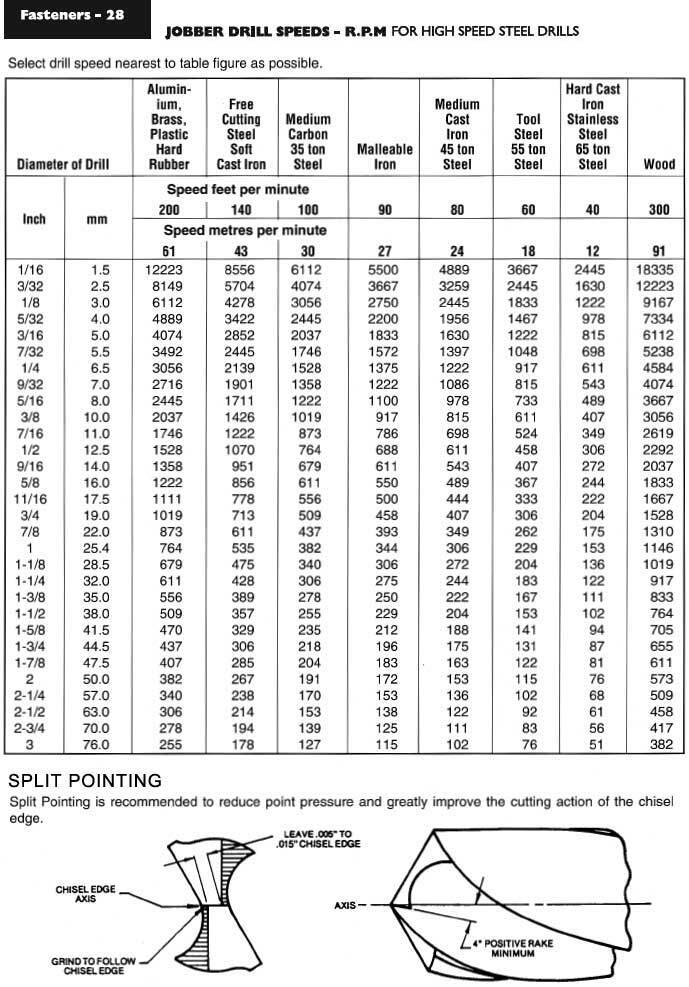

    For Stainless, you want a slower speed.
    6-32 tap drill size is a number 36 (.1065")
    go about 900-1300 RPM
    Edit. Here is a simple chart that you can use without having to calculate the speeds Click image for larger version
