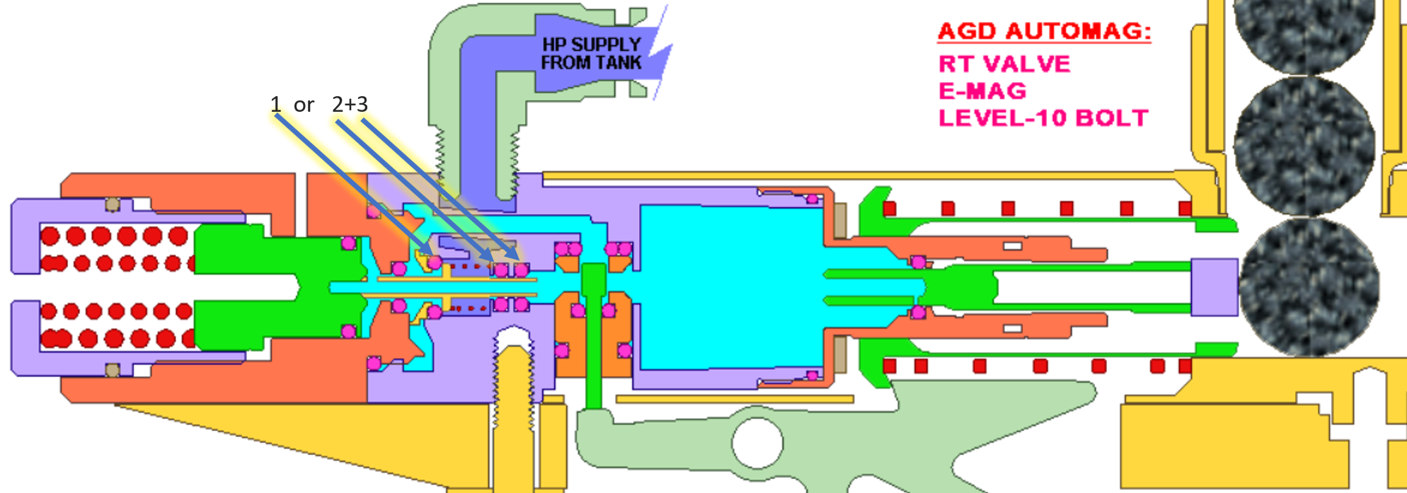

                  In theory, causes for a hot shot could be either:
                  1. A reg piston that doesn't move freely. This could be caused by debris in or around the reg piston or spring.
                  2. Per the attachment, a leak from either o-ring 1, or both 2 and 3 at the same time.
                  It looks like tank pressure increase wouldn't cause a hot shot.
                  My money is still on something in the hopper, bore, or barrel that's compromising the shell.

                    If #2 or 3 are leaking, it would leak out the tiny side hole, right? Regardless, like you state, if they don't allow consistent/free movement of the reg pin assembly, it could cause a hot shot.
                  • Siress
                    Siress commented
                    If there's a vent between 2 & 3, then yes. Why vent it, though? I'd probably seal that vent up good and tight to have the redundancy of 2 orings over 1.
                  • nak81783
                    nak81783 commented
                    The vent is for safety. If the aft ring goes, it vents out the side to signal there’s an issue. The forward ring is still there to keep tank pressure (albeit venting) from entering the dump chamber. Without the vent hole, you’d never know there’s an issue, and if both rings failed, you’d have a path for tank pressure to the dump chamber after the reg seat has closed.
                    Can’t have just one ring there and still have the safety vent hole, because there’s tank pressure and on one side of the vent hole and dump chamber pressure on the other side. It needs two to make it work.

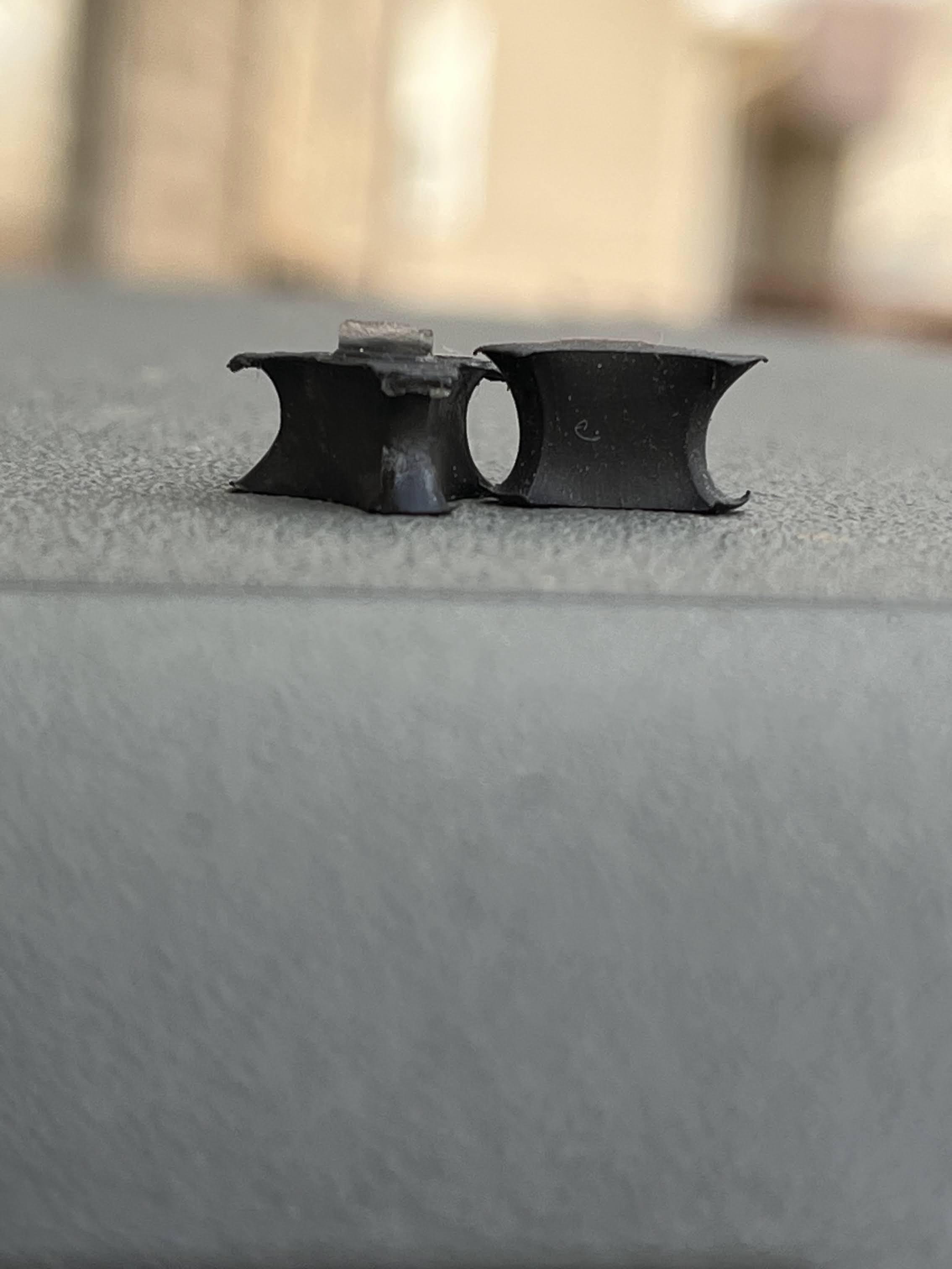

                      Originally posted by Toestr
                      My only other advice would be to make sure the foamie is still on the bolt. If it's not you could get rollback.
                      I checked this, and the foamie is still on there, but it looked flatter than I remember. So, I yanked it off and compared it to a fresh one. Lo and behold, it has been significantly compressed over the years. I went ahead and changed it, and we'll see if that helps any.
                      old v. new foamie

                      That's all I've got for now. I have to wait 24 hours for the epoxy on my foamie to dry. Then I'll do some more testing in the backyard and see if that makes any difference. I'll check things over with a chronograph too.
