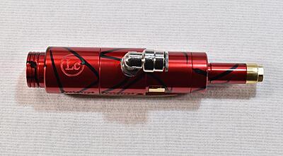

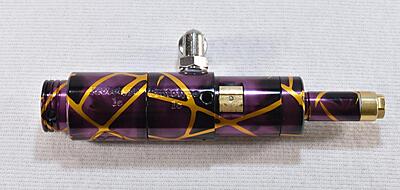

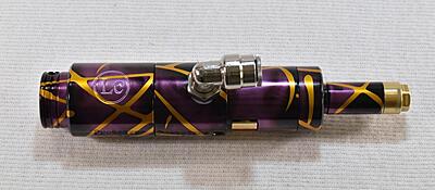

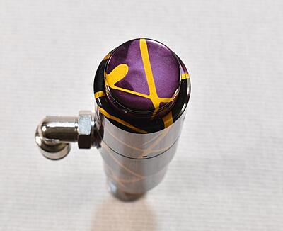

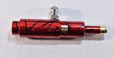

    pics of Luke's Valves

      I just saw Luke's valves on AO. Now question is will he be making RT classic version using banjo bolt and new frame with hidden air lines.

        Is an aluminum power tube a wise idea? Otherwise, I love this!
        • Cunha
          • 2115
          Luke, thanks. The classic valves shoot dead nuts but lighter weight was always worth while on them. Super cool
