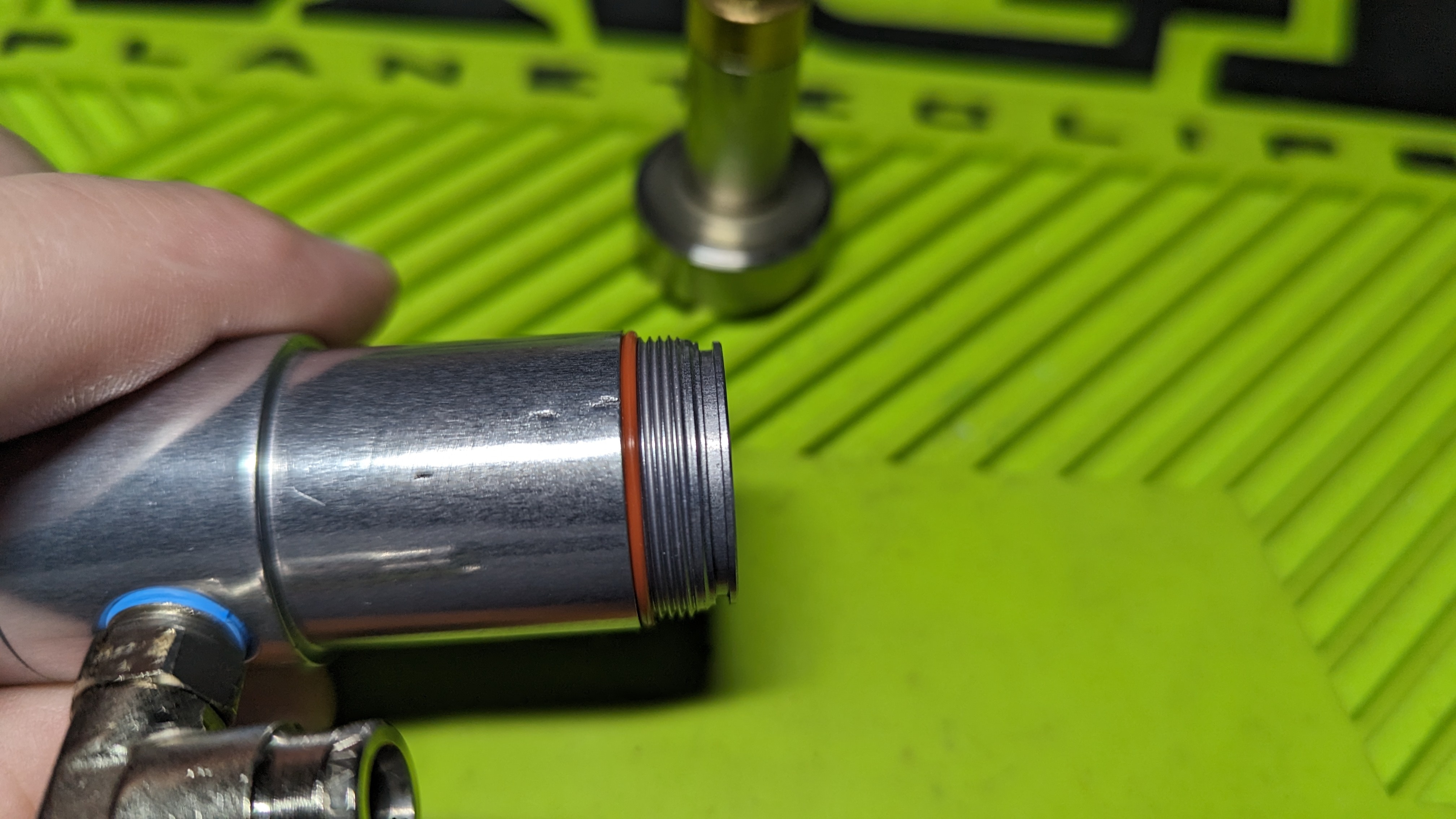

        After some more poking around... Not sure how I missed this. I think I'm missing an o-ring where the bolt guide meets the valve body, see picture. If that's true, well I'm a little embarrassed, and no clue where that o-ring went off to.
        Do you happen to know what the call-out for that o-ring might be? Click image for larger version

          That powertube is not supposed to come off and is not an oring in the standard agd kit. Your powertube should be loctited in place.

            well it came off when I got everything anodized, will look at gluing it back together.

          Used some teflon tape as a test on the power tube, the leak moved from the barrel to between the rail and body. So I believe the un-glued power tube is the culprit of my leak now.
          Will regular blue loctite CA glue work to seal that, or do I need something fancy?

            I have successfully used regular blue loctite to seal these before.

          looking at this again. that orange oring should be on the tip where you think the oring is missing. I wouldn't use glue. typically i use loctite 242.

          That oring is not even in the right spot. You need to move it up to the proper position in the groove. Loctite on the threads and dont get any on the oring.

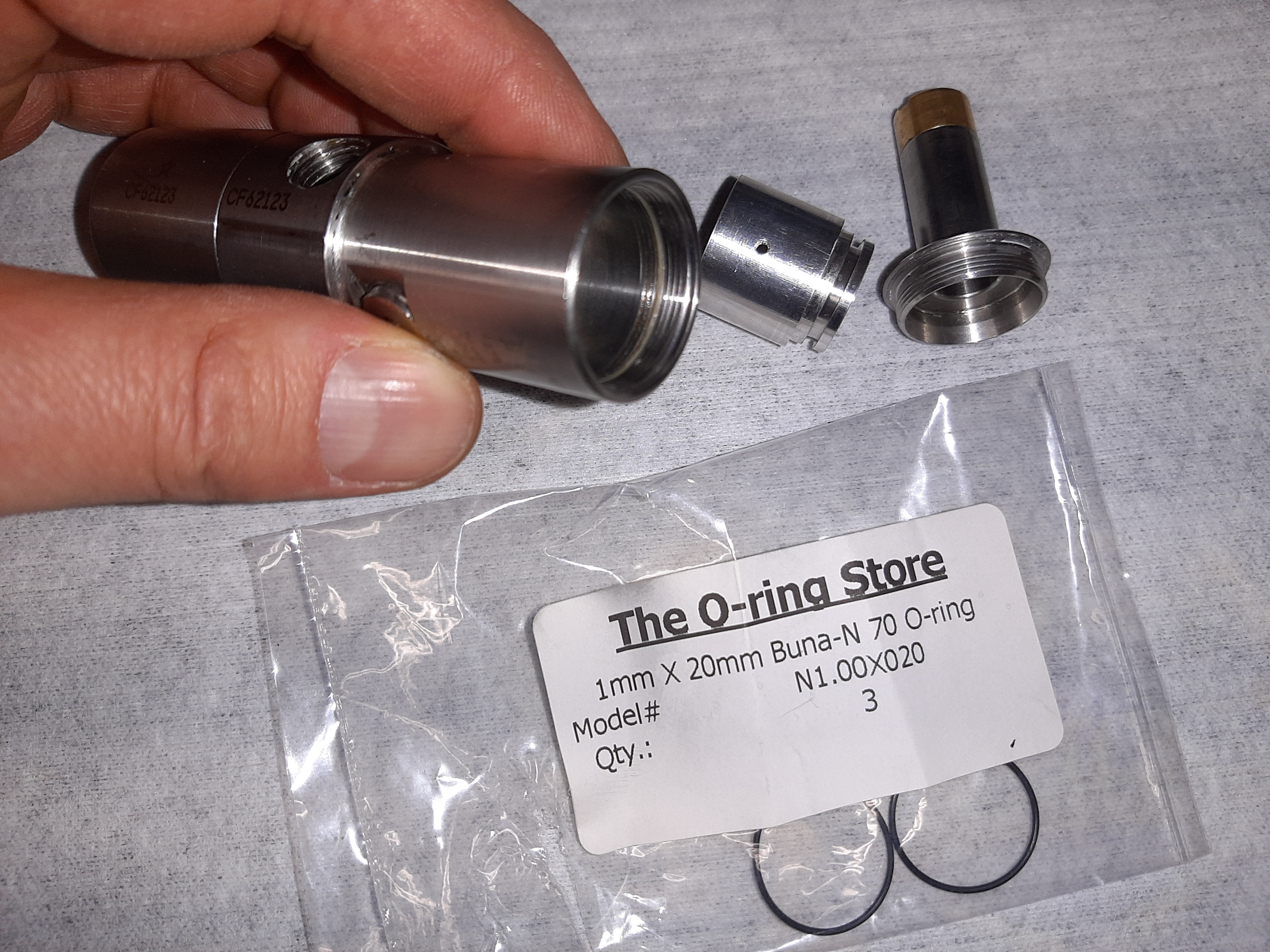

              OP's valve is a little different... possibly a level 5? So I'm not sure if it's the same, but here is the O-Ring size for level-7's

                Ops valve is an xvalve. It is the same oring.

                  I see that now. The lighting made it look like stainless at first... which had me thinking classic.
