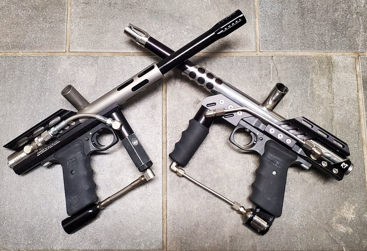

    I'm new to the Automag world and like these guns but I'm already kind of sick of how high the hoppers sit up on these things. I've noticed that on both of these markers there's nearly an inch of feedneck that could be cut off and still provide plenty of surface area for the elbows to clamp to.
    Assuming I'm shooting these guns with a forcefeed hopper, would this cause any issues with feeding? Also, is this frowned upon, either in the resale market or in the automag community generally?

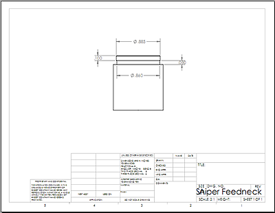

                        Same deal with steel centerfeeds?
                        I've got a pair of clamping eclipse feednecks I'm not using.

                          What's the OD of the thinner part of the feedneck? Does it have enough thickness to just cut and mill it to an Eclipse feedneck stub? I don't have the Eclipse specs, but I believe they are fairly close to Empire specs, which I do have. At any rate, you might want to just send that body to superman for a feedneck mod.
                            It's a little too thin so the method seems to be to use a small strip of metal or a series of O-rings to get a proper grip.
                            https://www.automags.org/forums/show...t-feed-automag
                            • Spider!
                              Spider! commented
                              Yes, there's some k&s hobby brass that fits well and never moves.
