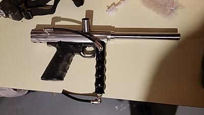

                    Looks like I am going in the right direction then - I have this sitting in my basement from a long time ago and never used it for anything. Thanks all!
