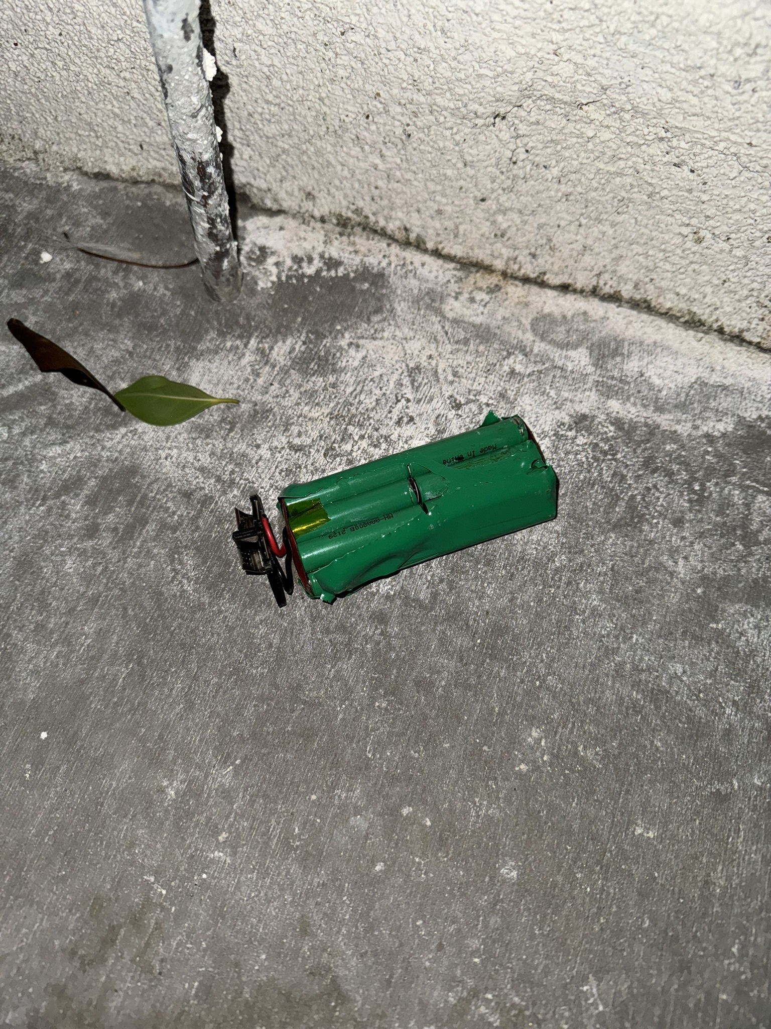

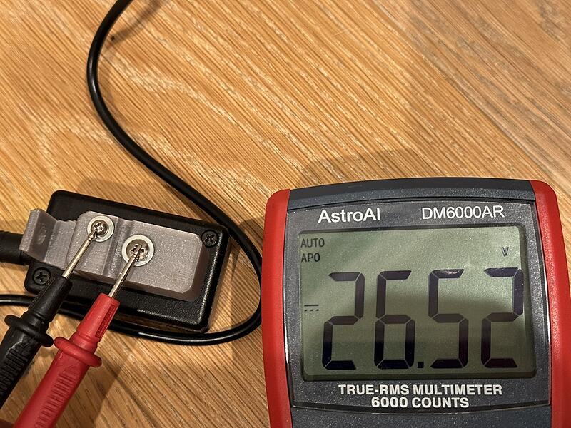

    Bought an emag here about a month ago. After some charging and tuning it shot great. Ended up sending the frame and trigger off to get anodized since they were raw. (All other parts stayed with me) After reassembling the gun, the board lit up and the noid clicked as usual. I put the gun aside and charged up the battery. After the battery was done charging I reconnected it to the gun and smelled burning. It was extremely hot but luckily I was able to get it out of the housing quickly. It smoked outside for a few minutes but never fully combusted.

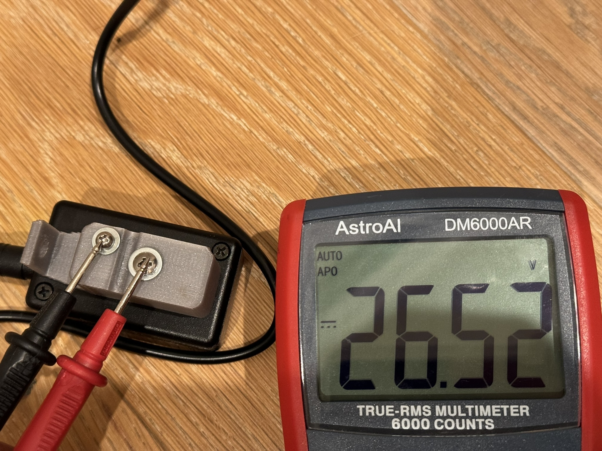

    After some confused swearing I went back to the charger and found that it is outputting 26 volts. I'm no electronics expert but this is more than likely what killed the battery right?
    What can I do to get the gun up and running again? I'm guessing the board is toast but hopefully the solenoid and hall effect are fine? Sci-Fi board seems like an easy option but where would I source a battery and charger nowadays? Maybe this is a sign I should just shoot mechanical..

    Not an Emag expert here but it is an 18v battery so I'm not super worried about your charger... I routinely charge automotive batteries at 16 to 18 V - they're 12V batteries - and alternators run at 14v, nominally, without causing issues with a 12V battery in the system.
    Sounds like you have a bad connection somewhere causing a short.
    Batteries are available from knownothingmags on AO, and Tunaman has chargers AFAIK, also on AO.
    • Grendel
      • 1980
      • Lexington, SC
      If that is an original Emag battery I am surprised it lasted this long.
      As Jordan said this is most likely a short and the short is most likely internal to the battery between jelly roll layers. That junction shunted too much current during charging and caused "thermal runaway". Testing a charger open circuit (not connected to a charging load) is not a good test of a charger and is almost meaningless. A charger meant for an 18VDC rated battery I would not surprise me to read 26VDC open circuit and I really would not be overly concerned at 34VDC open circuit. I will admit I do not have a lot of direct experience with Emags hopefully someone like superman will chime in who have way more experience with Emag batteries then I do but I do know batteries and charging circuits and when you have a battery catch on fire it usually is an issue with the battery by a far margin then a faulty charger.

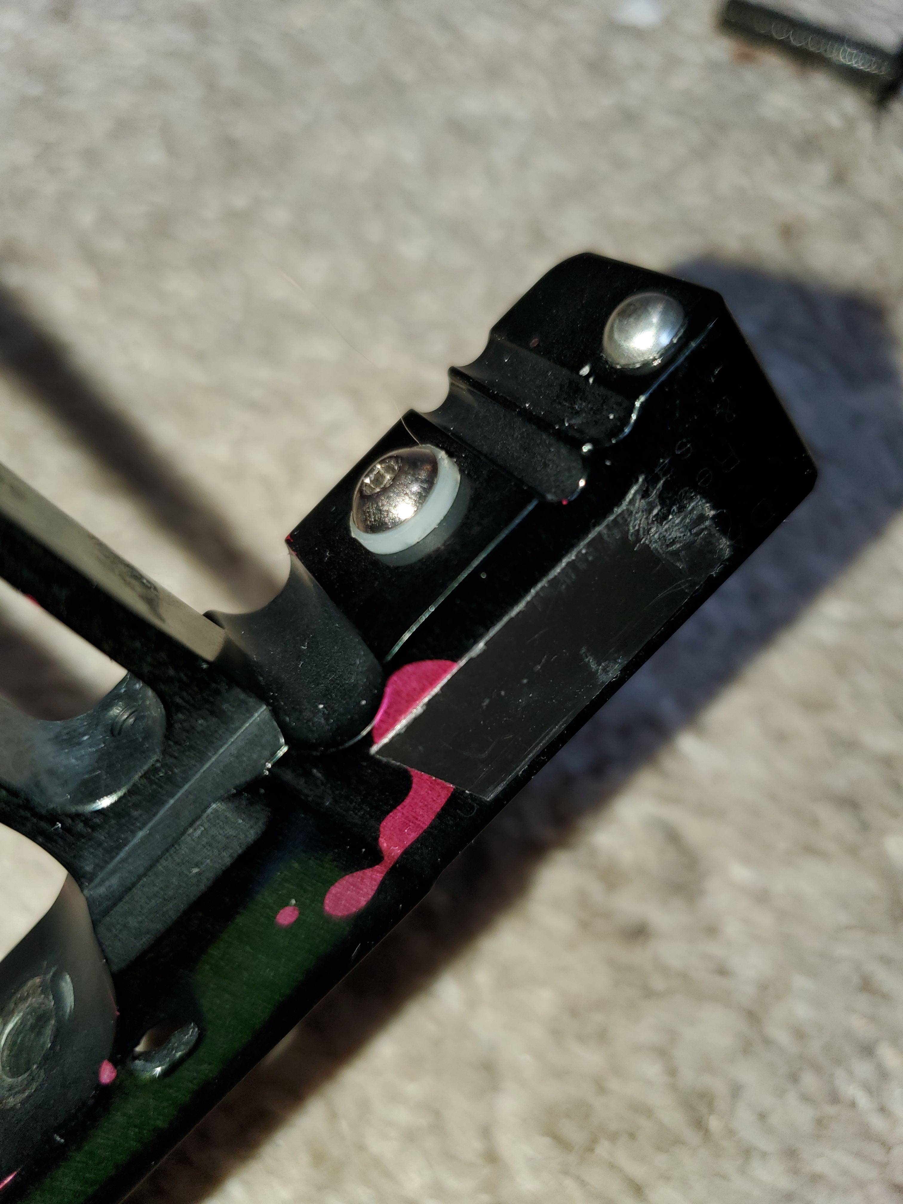

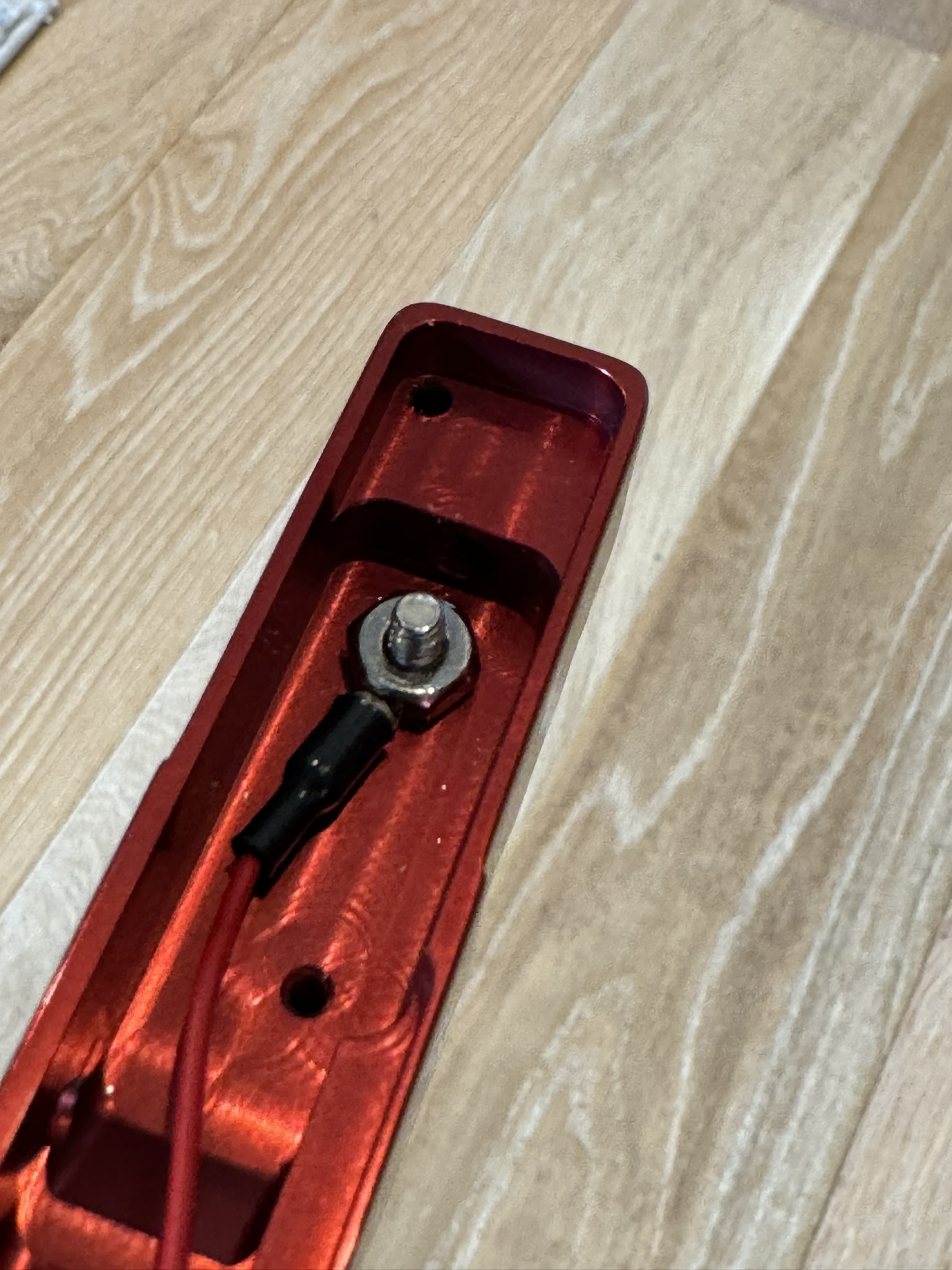

      Ill start with saying I completely disassemble my emag after every game. And clean it. Every part comes out. And i made one huge easy mistake that ended with the same results as yours. Im saying it this way because you recntly built the your gun.
      In the spring while down in Baltimore for a game I cooked my battery. Yes I got it out of the housing. Otherwise theu would have seen a grown man cry. I found on disassembly of the gun after the incident that I had missed putting the plastic washer back on the inside of the frame where the nut for the positive battery connection is. This allowed for a immediate short.
      Also make sure you have the plastic flanged spacer on the positive stud.
      While I was scrambling to get my battery out of the gun it melted the wires on the battery and continued to short. Once out of the gun and on the ground it continued to burn for a half hour.
      Washer inside frame

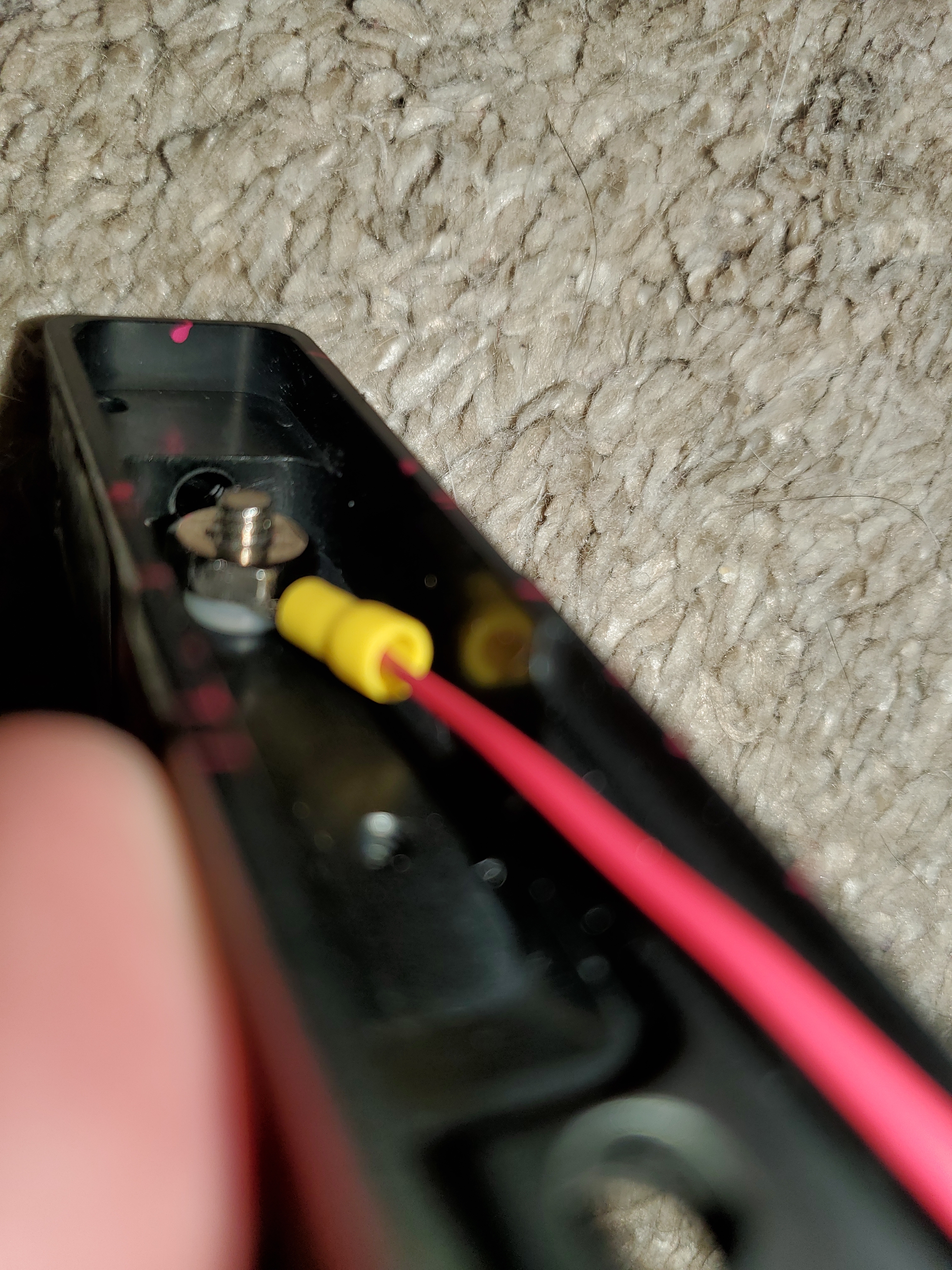

      Turns out I'm an idiot on multiple levels.
      I indeed missed putting that plastic washer back on the inside of the gun.

      Also good point made about the charger being measured open circuit. 26V measured in that manner definitely does not imply 26v in the battery.

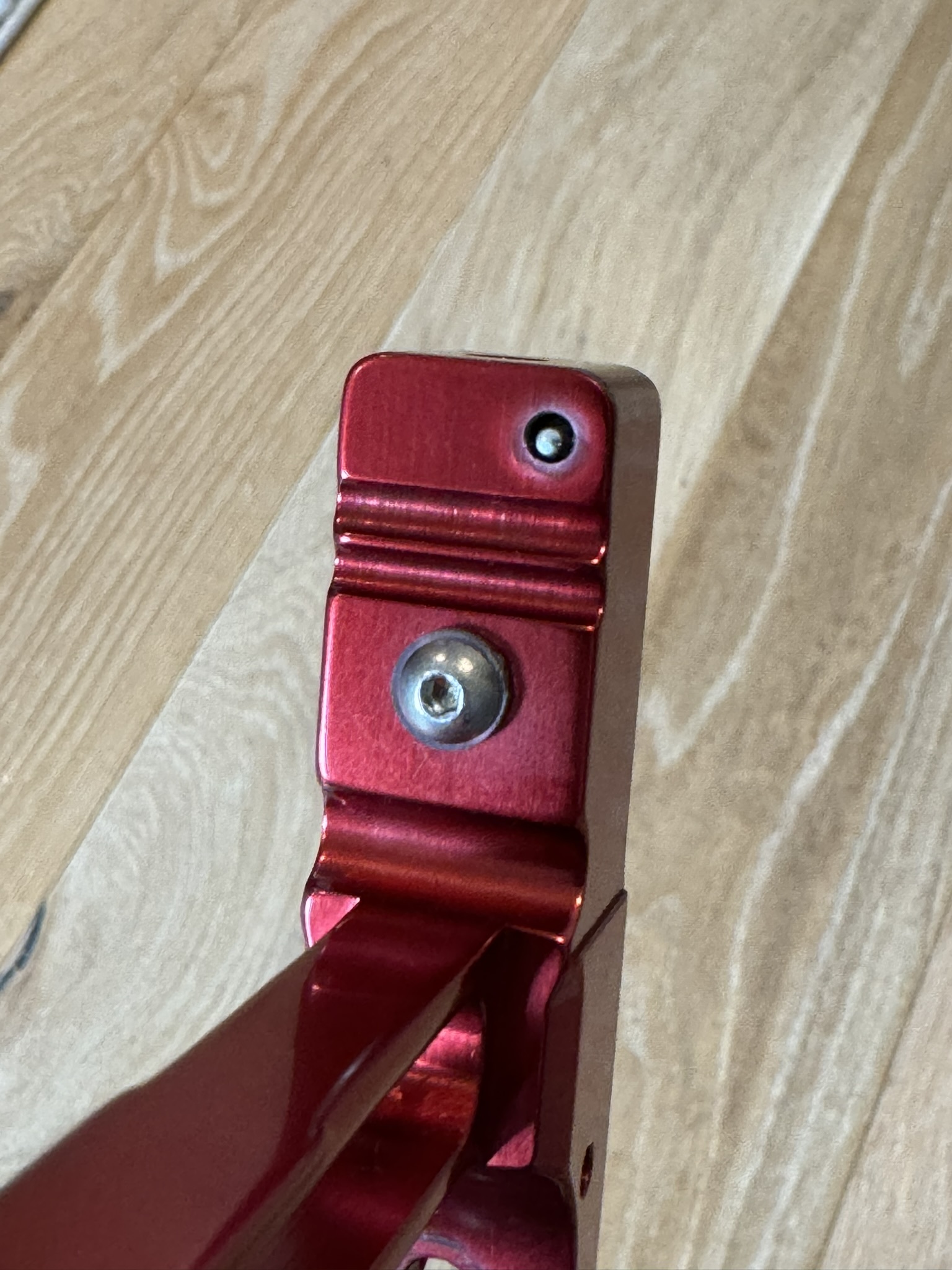

      Is it possible to get the negative stud replaced on the frame? Mine is reduced quite a bit - I'm guessing a result from the recent anodizing?

      I would contact tunaman on AO about the negative stud. I'm sure he has had to deal with them before.

        Pretty sure i have a negative stud kicking around.

          yeah I would echo that the charger testing on an open circuit probably doesn't tell much. if an 18 volt cell was actually charged to 26 volts I would expect it would have had a non passive failure on the charger. 18 volts is just the nominal voltage and it charges to about 21 volts for a full charge, 20+% overage would make it very, very unhappy very fast. not saying its impossible to fail after charging but yeah, I would be skeptical that it was necessarily the charger.
          • tunaman5
            • 335
            The AGD spec says not to re-use the negative battery terminal. The twisted "threads" get filled with aluminum and anno when pressing it in. I have found that you "can" re use them if you clean out the junk before pressing it back in.

              The battery charger does indeed put out 20-26 volts which is normal.
                Any tips for removing and replacing the terminal? I'm imagining a vise and punch type situation?
