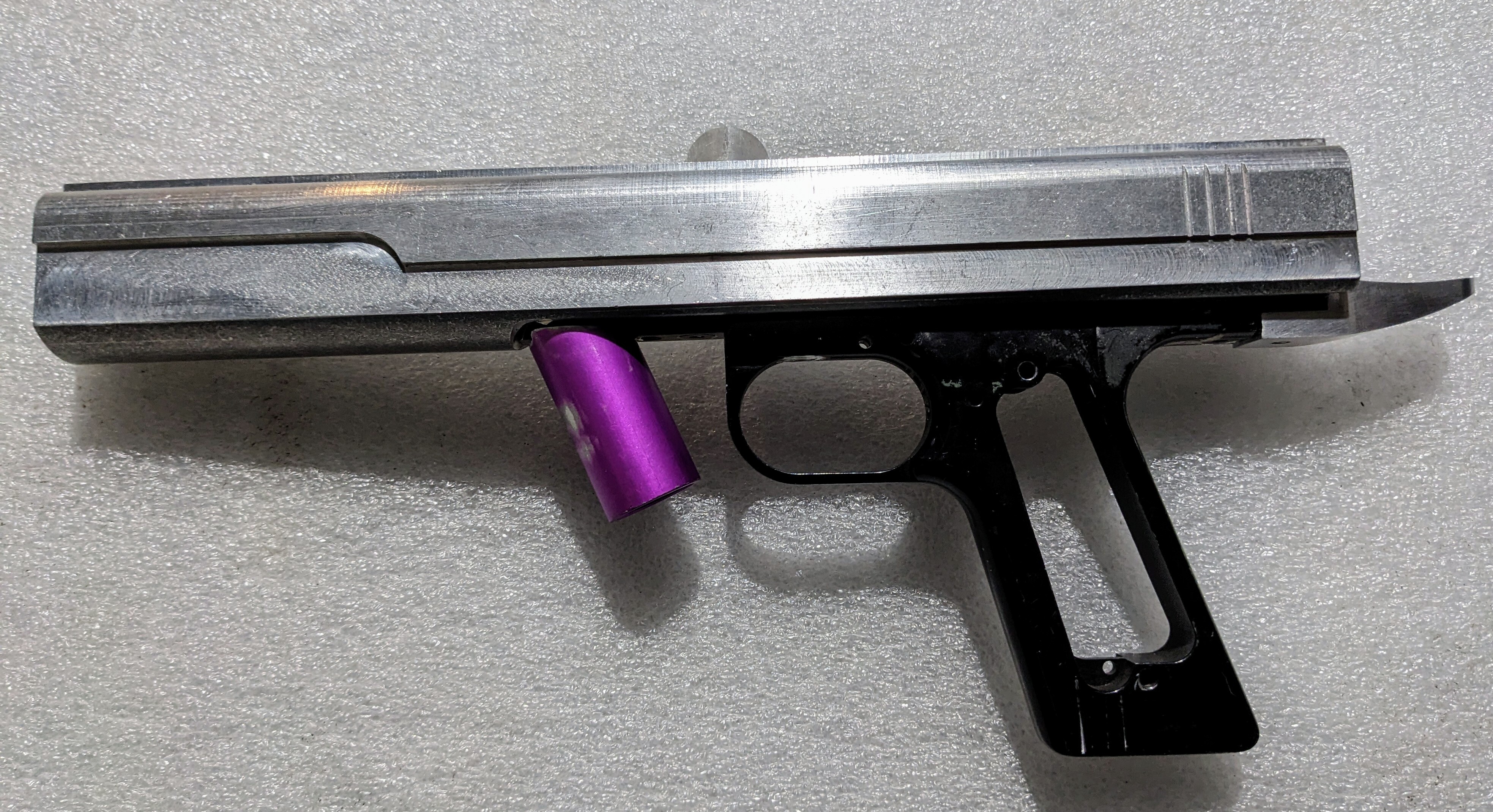

    I know it's not needed but I've felt it done one few. Mostly Carter mags. I have my buddies to look at but don't necessarily want to reglue grips if it isn't something simple.
    So.....
    In theory could I drill the back part of the sear and attach an extension spring down to a notch in the frame?
    Yeah yeah hardened sear I have drills that will get through them.
    I need the trigger on this to be less sloppy feeling and since I'm already grinding shims figured springing is the next move

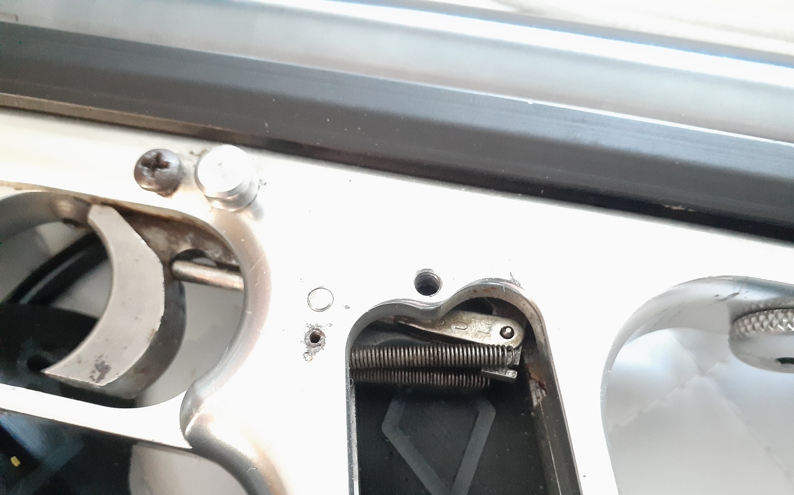

        My main Automag have a spring between the sear and one hole in the benchmark frame, will post some picture soon on how it was done. Was already done when I got it and I like the feel so kept it since.
          MCB member
          • 3511
          • Montreal, Qc, Canada
          Here is how it was done on my frame
          a pin was added to secure one side of the spring. No hole was drilled in the sear but there is a small 3/32 section protruding under the sear arm pivot and the spring is hook there.

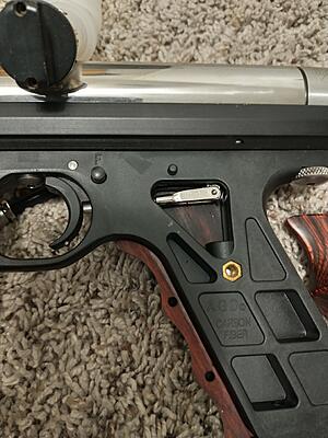

        • Spider!
          • 542
          • Houston
          This is a spring on a ult experiment. That might have been an existing pocket. It hasn't moved.
