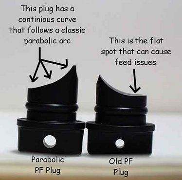

3) powerfeed plug: Make sure you have the new one. The old one can cause all sorts of weird feed problems when using a powerfeed body.
OLD:
NEW:
OLD:
NEW:
