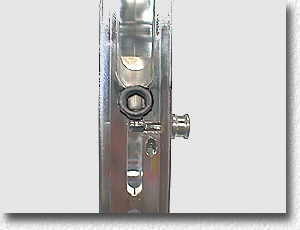

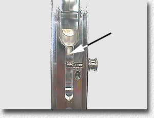

      You would have to modify the frame to add your own stop:
      The following is quoted from Terry Garrett of G3 Paintball.
      Since this frame has a guard, it is often a chore to install the usual over-travel set-screw behind the trigger. Many years ago I would drill a hole through the rear of the frame in order to could get an aligned hole to tap just behind the trigger to install the stop screw in. On frames with the guards removed it's a simple task to just drill and tap the hole. Not so when you have a trigger guard in your way.
      Photo (Above) shows the area I now use to install trigger stops on frames with guards. Since drilling and tapping a hole with a slot already in existence can be really "fun", you need to be really careful with this - especially when tapping the threads for the stop.
      Photo (Above) shows the finished project. Drill and tap size will vary with what is used for the stop. In this case it's the adjuster from an old stock AutoCocker. Hex plugs also work great. They require a 1/8" NPT thread, whereas the adjuster used is a 3/8-24. Screw the adjuster so the top surface is flush with the top of the frame or slightly below, as to not interfere with the body rail when re-assembling.
      The top of the trigger will hit the bottom of the stop, acting to prevent trigger over-travel. Adjustment is made by either tightening the plug further into the frame or by grinding the plug so that it's thinner. When drilling the pilot hole for the tap, be sure and not drill all the way through the trigger slot into the guard opening. It won't affect the operation but it would look rather horrible.....This method certainly isn't as easy to adjust as the version on the original cut frame but once it's set, there should be no need to alter it anyway. Also makes for a really clean looking installation. You ahve to be careful since you usually wind up cutting into the safety spring hole. To date, this has not been a problem....

        I like this! thank you! looking at the frame and pull I think a stop would really help reduce travel. also pretty doable with a drill press.

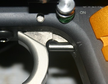

      OK I've played around with this a bit tonight. from what I gathered off an old automag forum post about adjusting the benchmark trigger you need to be a credit cards width away from teh back of the trigger with the gun aired up and the safety on. to get this I needed to go about 6 turns shorter on the rod. by my feel I like the pull a little less now. - you can short stroke it easier. is this good info? am I doing it right?

        A credit cards thickness is the standard from the tip of the rod, to the back of the trigger.
        This is how my Benchmark 2x is when aired up....
