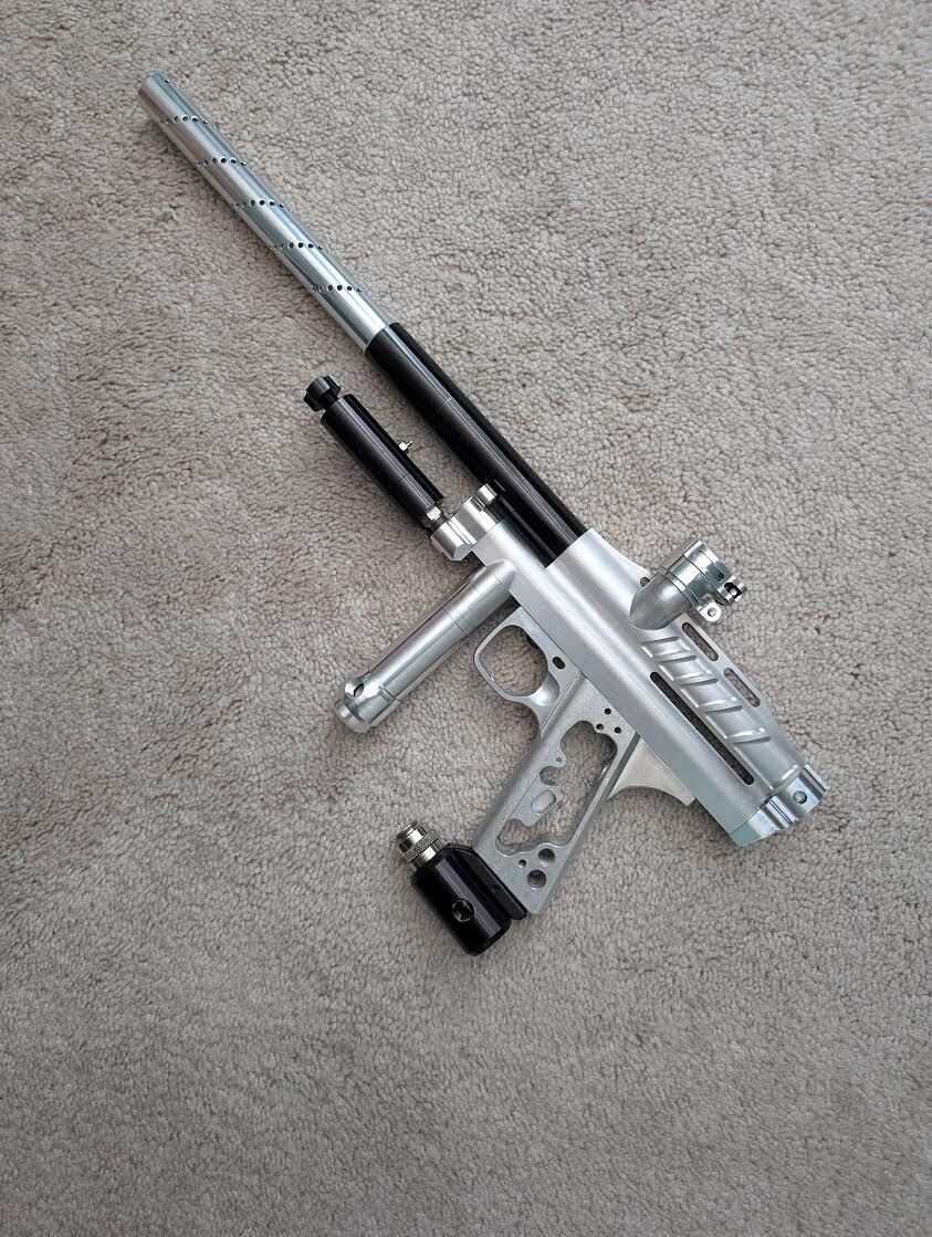

    Here's a partial mock up of the Mozak Southpaw I was going to build (will be posting the body for sale here in a few minutes, though). His vert ASA's perfectly match the OD of the Sidewinders. This is the short, but I also snagged a medium cap to play with/make a final decision. Hope this helps!
    -Mike
    • Booska
      Booska commented
      That helps a lot actually! Looks like I'll be able to get away with the short, but I might also get a medium reg cap just in case I need that extra half inch. Mine doesn't have a drop forward, so the short might work. Thanks!
    • Sottyman
      Sottyman commented
      Glad I could help! Just to clarify, that's a ST Gunfighter 1.5 frame...not sure how much taller/shorter the 86 frame you're using is.
