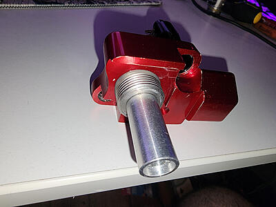

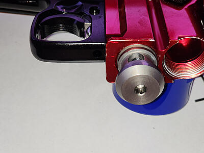

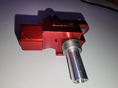

            I took it apart this evening. I am attaching pictures of the frontblock you can see in one angle where the oring has pushed out of the face groove on the banjo, and the counterbore where you can see the oring is smaller when the banjo is in the body. I am terribad with a camera forgive the images.

              I may have solved this if anyone has this issue in the future. I added a third oring on the threaded portion of the banjo before installing the front block for a total of three orings. It now seals up and no bubbles with soapy water.
              • Killshot_Kustoms
                • 90
                Easiest way to seal Merlins: remove the rear 015 oring that sits in the groove, push the bajo bolt through the front block, and slide a 017 oring over the threads. It will seal between the frontblock and the body. I have been doing this will all my Krakens, and Maelstroms.
