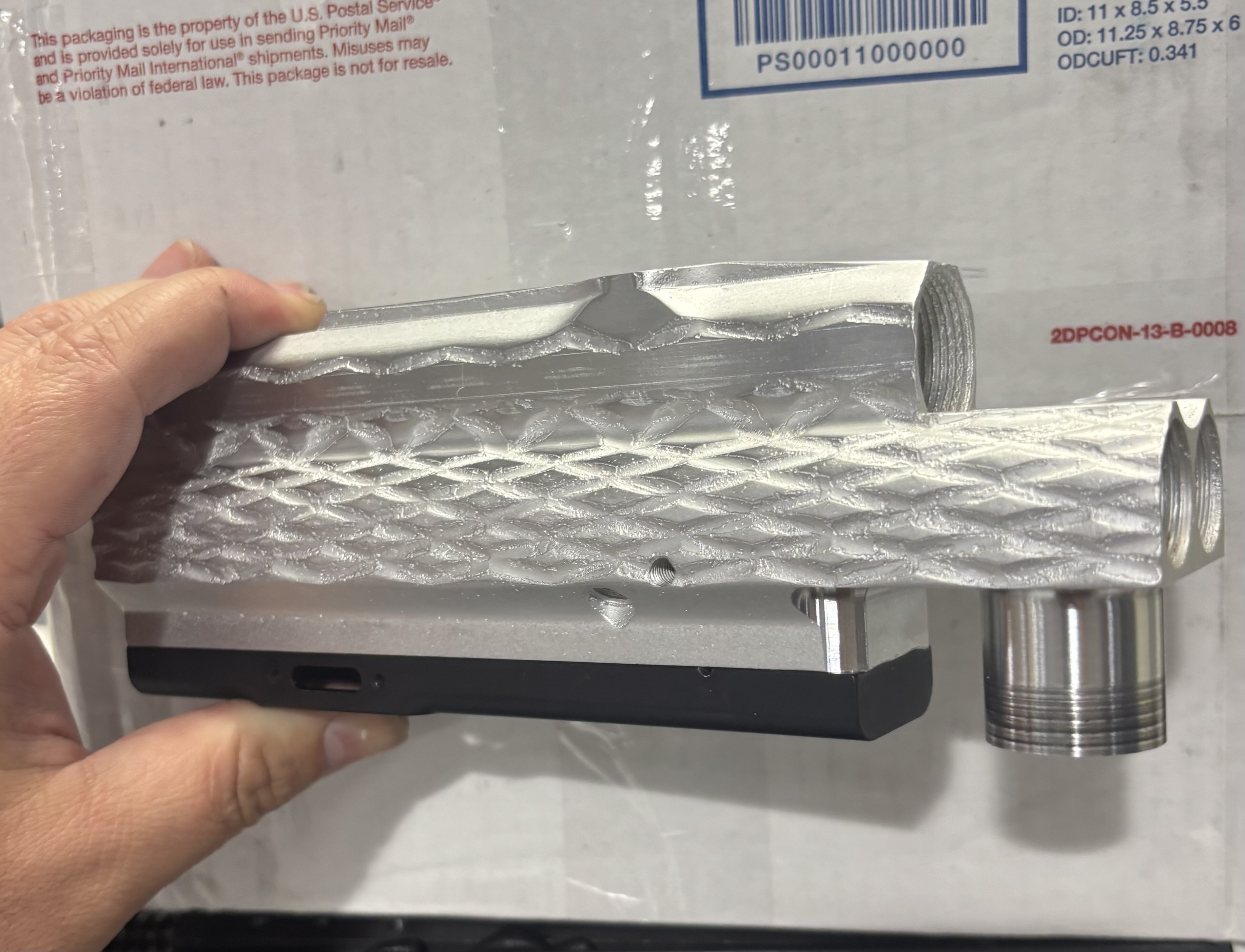

    so first thing to make and test was the FSP cut

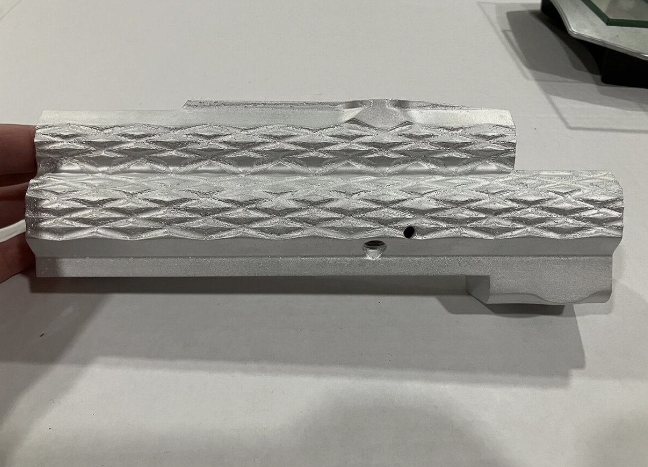

    Click image for larger version  Name:	IMG_0861.jpg Views:	0 Size:	1.44 MB ID:	669455 And then I created a file removing more material than I usually would.. top tube has a wall thickness of .06”, lower tubes .07.. looks like I could actually remove more material but I’m satisfied.. plus there’s a small remnant of the original edge milling
    Click image for larger version  Name:	IMG_0866.jpg Views:	0 Size:	4.16 MB ID:	669456

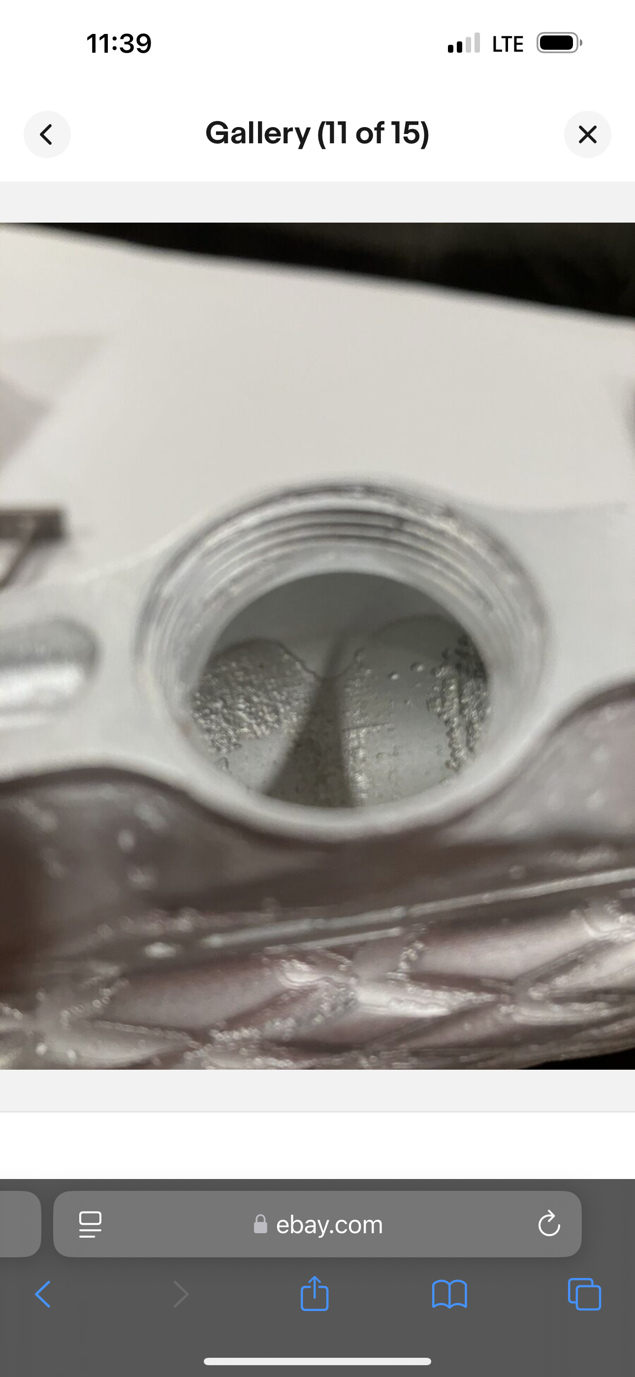

    a picture of the inside of the upper bore
    Click image for larger version  Name:	IMG_0775.png Views:	0 Size:	1.35 MB ID:	669457

    what caused the pitting? Was it leaving the stripping chemicals inside too long? Was it supposed to get sanded or sand blasted instead? Curious
    • Frmrspec
      Frmrspec
      commented
      I can’t say definitively because I wasn’t the person that stripped it or the person that had it stripped but nickel plating is usually stripped with nitric acid which isn’t as reactive as sulfuric acid… I’m betting whoever stripped it either left it in waaaaaaay too long or stripped it with sulfuric acid…. I’ve had a lot of nickel parts stripped and never had a result this bad
    I wonder if you could fill the pitting on the inside with Aluminum Brazing rod then re-machine after? Kind of a tight area but the brazing rod melt temperature is significantly below aluminum's melting point; might be reasonable to heat the whole body up in an heat treat oven or forge and use the brazing rod to fill in the pitting. It is made to flow well through capillary action like solder so it should be fairly self leveling without leaving a lot to be machined. You can anodize over aluminum brazing the only issue is you may get inconsistent color but if it is inside what does it matter what the color is.
      Ecapnation
      commented
      That's going to never going to bond or Anno right
    I debated machining it for a freak insert and bonding it in place
      This is further in the right direction than I thought I would ever see this body, poor thing has been to hell and back. I didn't realize you intended to make this thing functional again, that pitting in the top tube is definitely a bit of a conundrum, but pressing a tube in may be a workable solution.

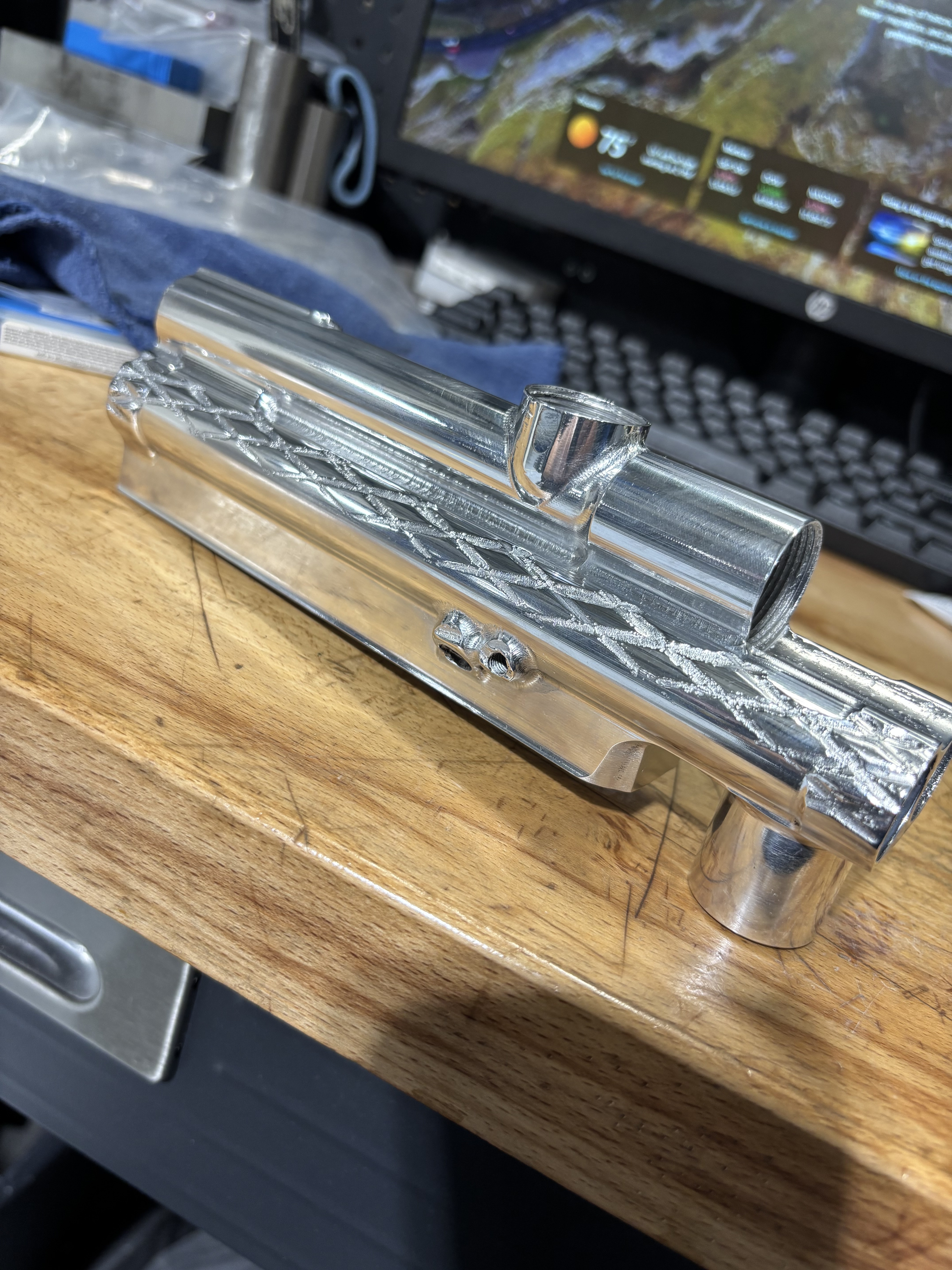

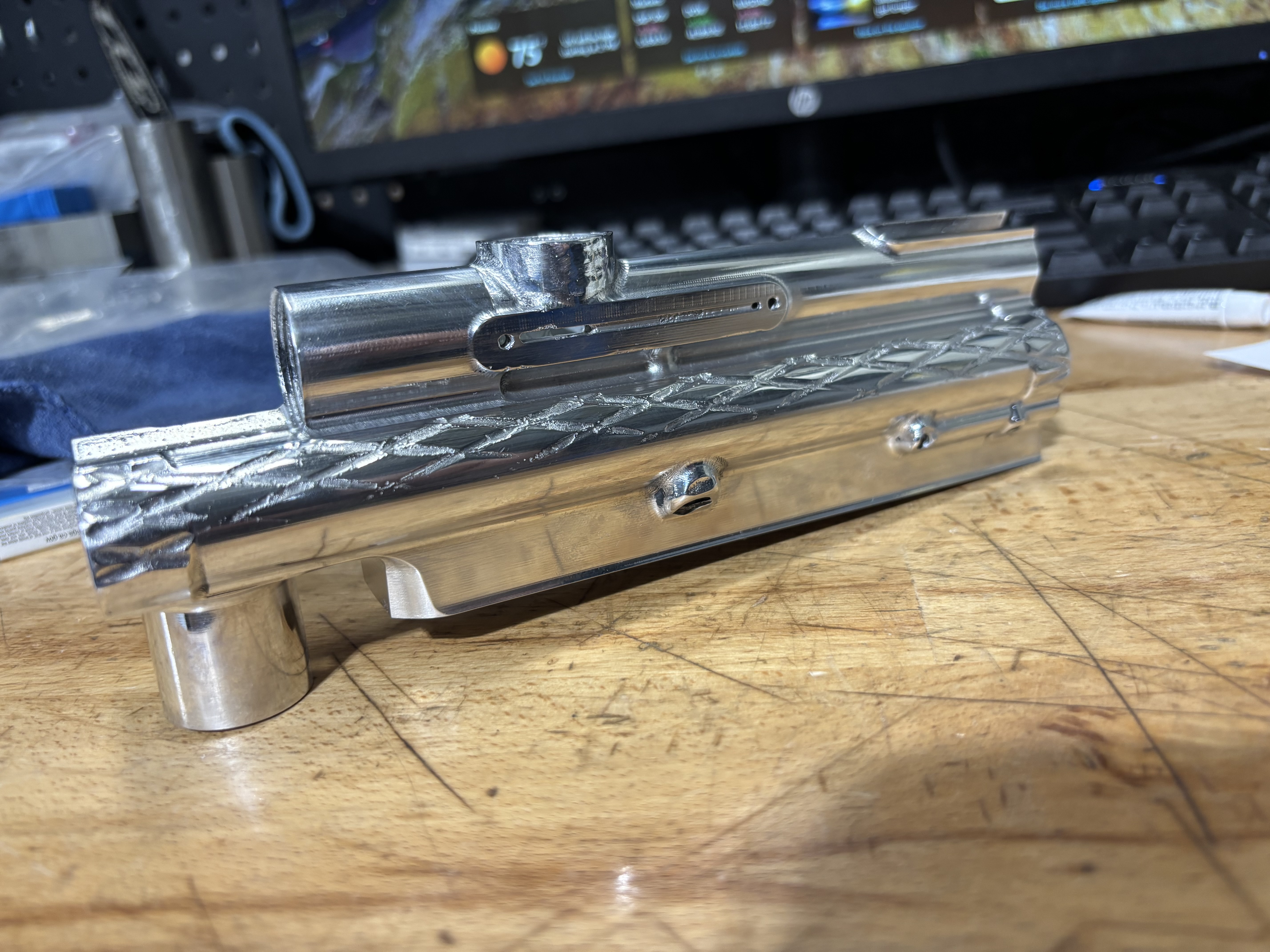

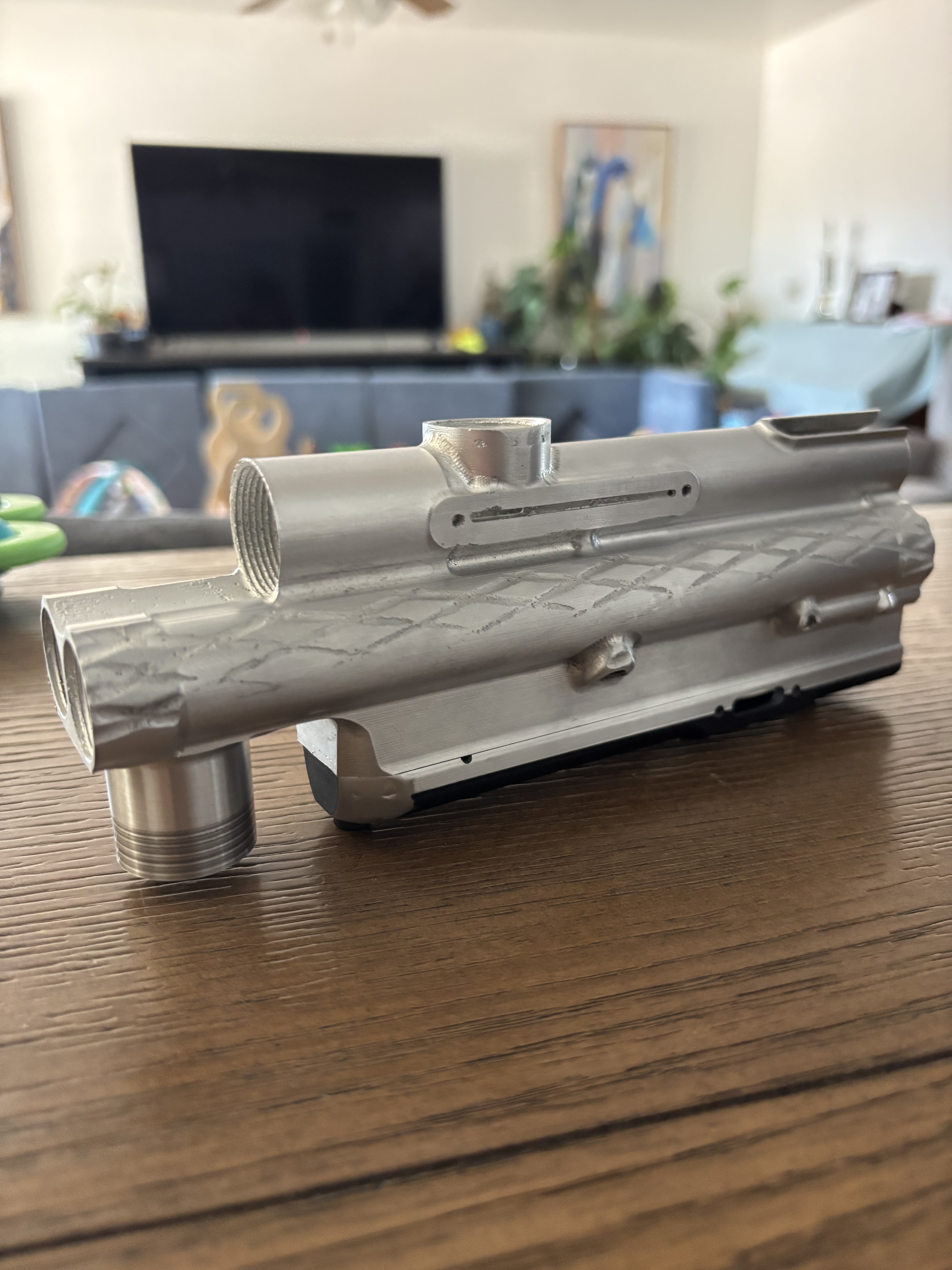

          had a coworker give it a quick polish before I send it out for ano…
          • TwonTamal
            TwonTamal commented
            Looking better! Any attempt to tackle the top tube yet or you gonna wait til it comes back?
          • Frmrspec
            Frmrspec
            commented
            After it comes back for sure… I didn’t want anything I do to impact the feasibility of ano.. there’s no second shot at anno on this thing

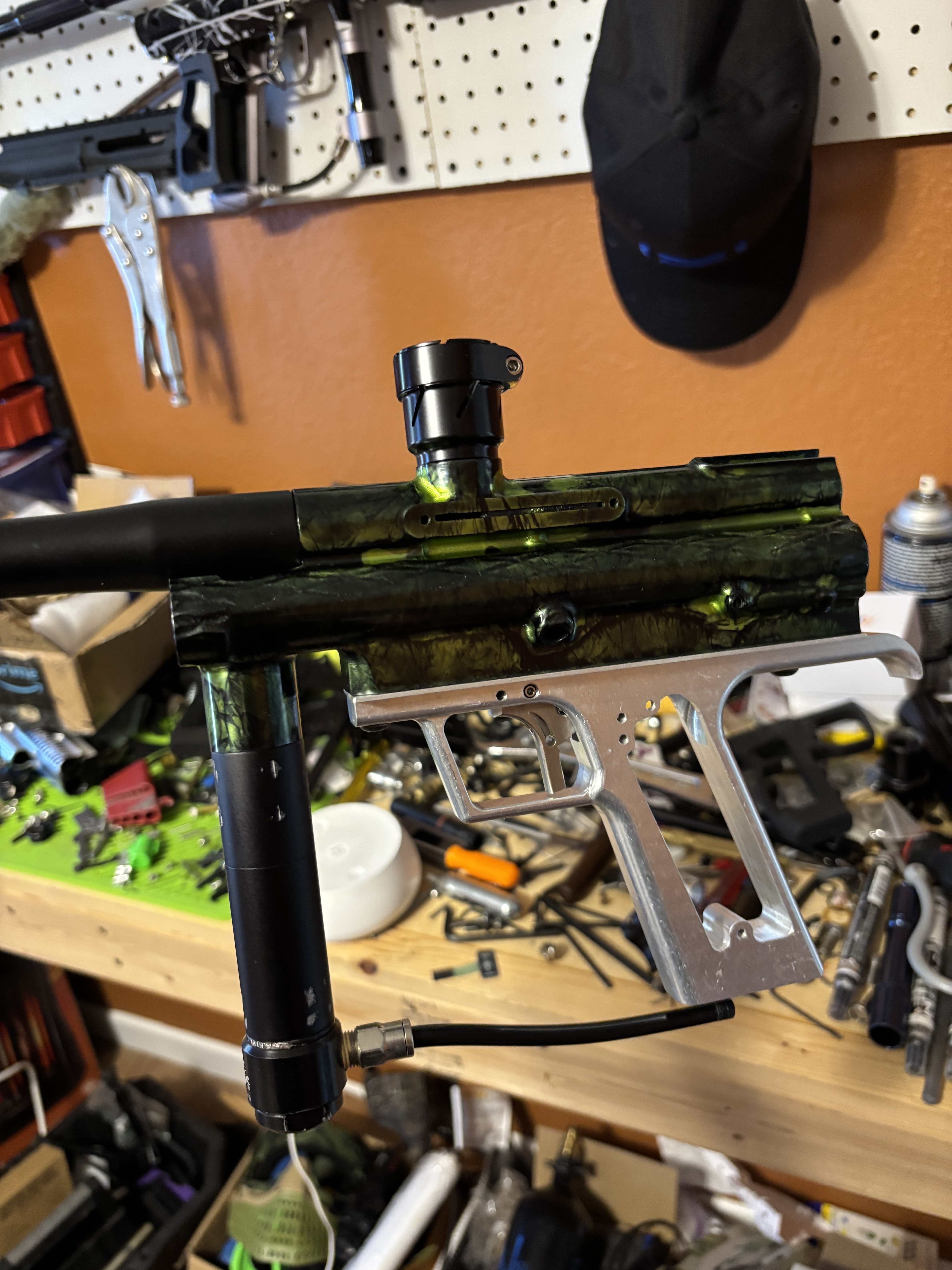

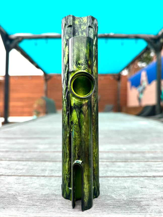

ID:	682239 Sneak peak from the anodizer
            • Grendel
              Grendel
              commented
              I really like the colors and how the wash was done. This should go a long way in masking some of the imperfections.
            • TwonTamal
              TwonTamal commented
              Wow, looks good especially considering what it looked like before. That was pretty quick turnaround, who did you use?

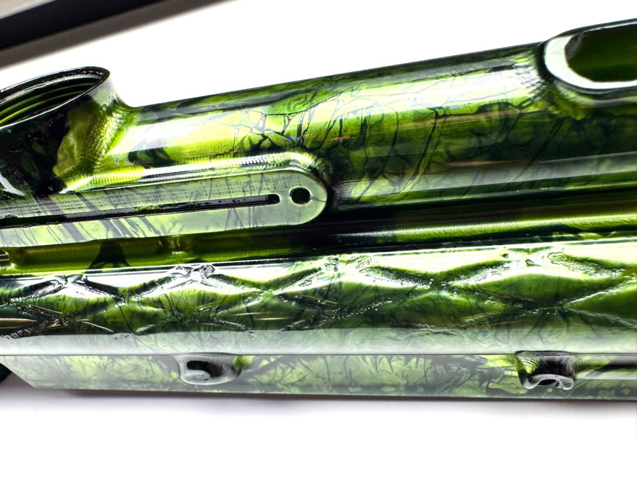

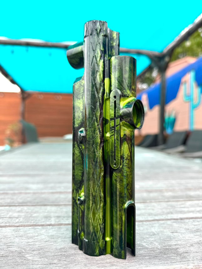

ID:	682394 Click image for larger version
ID:	682395 I’m am excited
            • Frmrspec
              Frmrspec
              commented
              No frame yet.. the body by itself wasn’t much to get anodized.. I didn’t want to send a ton of parts if it ends up not being functional.. plus I’m working on a single trigger eblade frame for it and everything else
            • TwonTamal
              TwonTamal commented
              True, that makes sense. Jury is still out on whether this will be functional given the pitting in the inner tubes.
            • Frmrspec
              Frmrspec
              commented
              TwonTamal I’m not actually too concerned about those.. biggest concern is the solenoid area.. the wall where the air goes to the solenoids is pretty thin.. if it leaks there, nothing I can do.. maybe make a custom solenoid manifold and use some permatex gasket maker compound.. and all the threaded air passages are going to take some work to seal.
              The valve bore and hammer bore were in surprisingly good condition but the bolt bore was baaaad.. I think I can get around that though, I’ve got a few plans
            Wow love the color. Something I would totally go for. A very Swamp Thing look to it.
            FredMnkyDad10 Feedback
              That’s awesome! Reptilian!
                Very cool, who did the ano?
                • Grendel
                  Grendel
                  commented
                  Pooty
