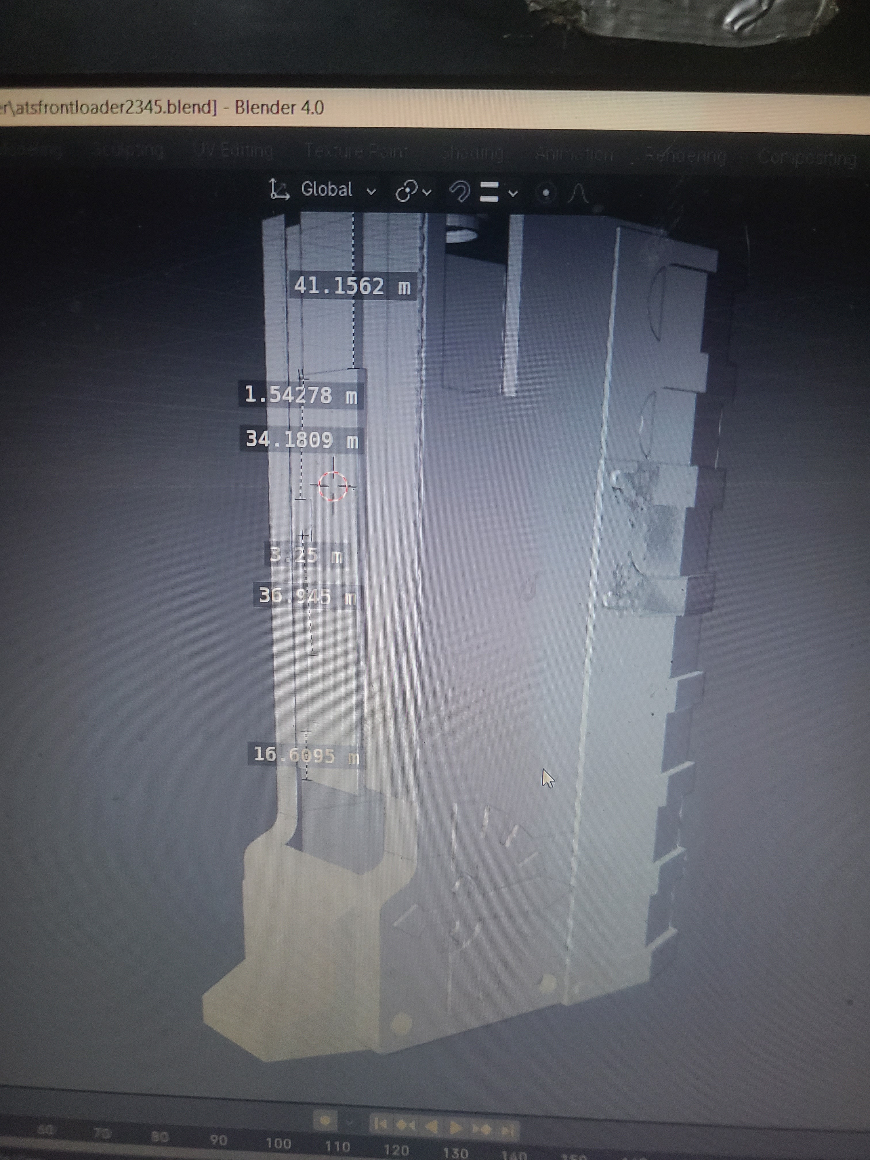

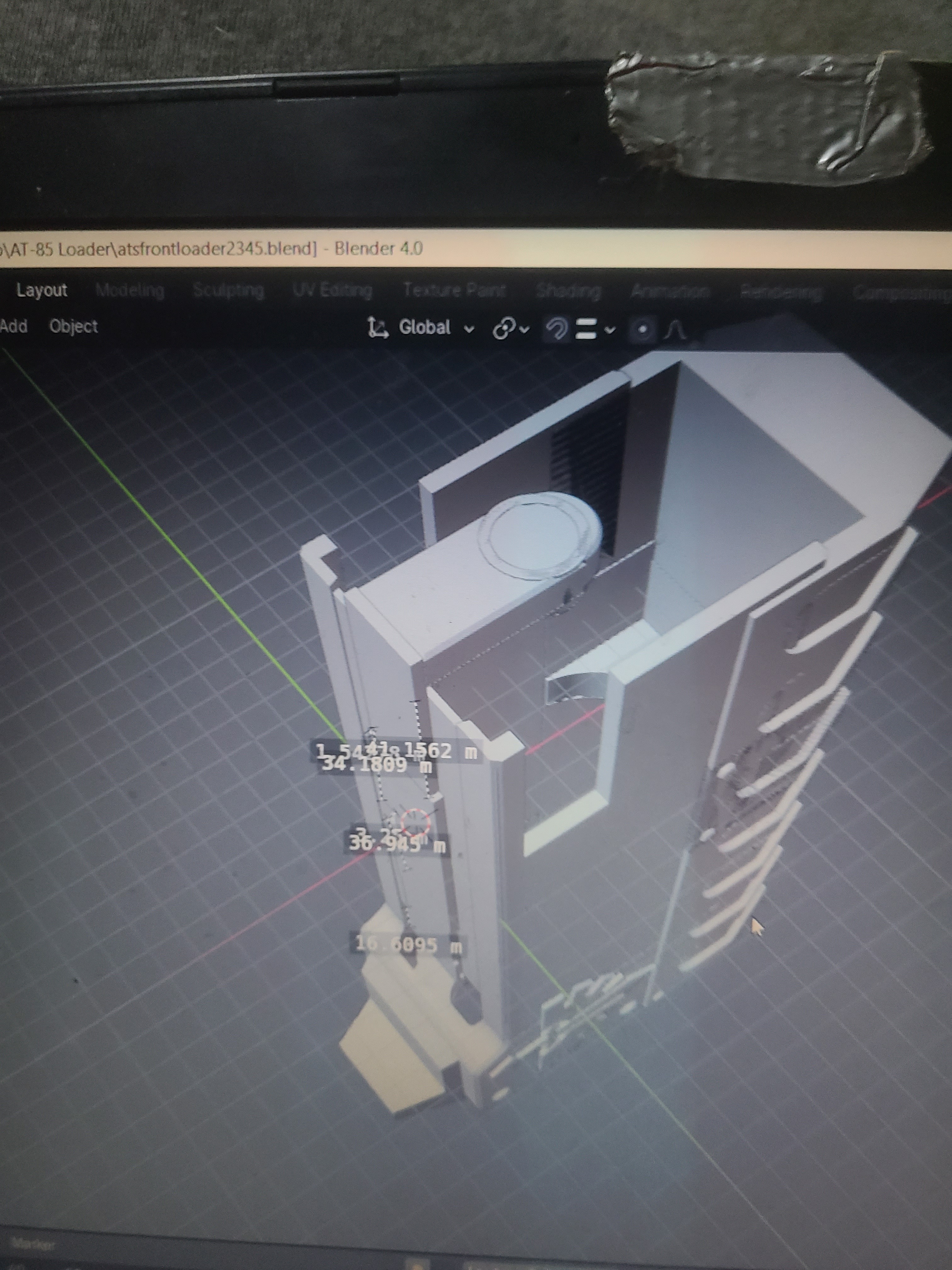

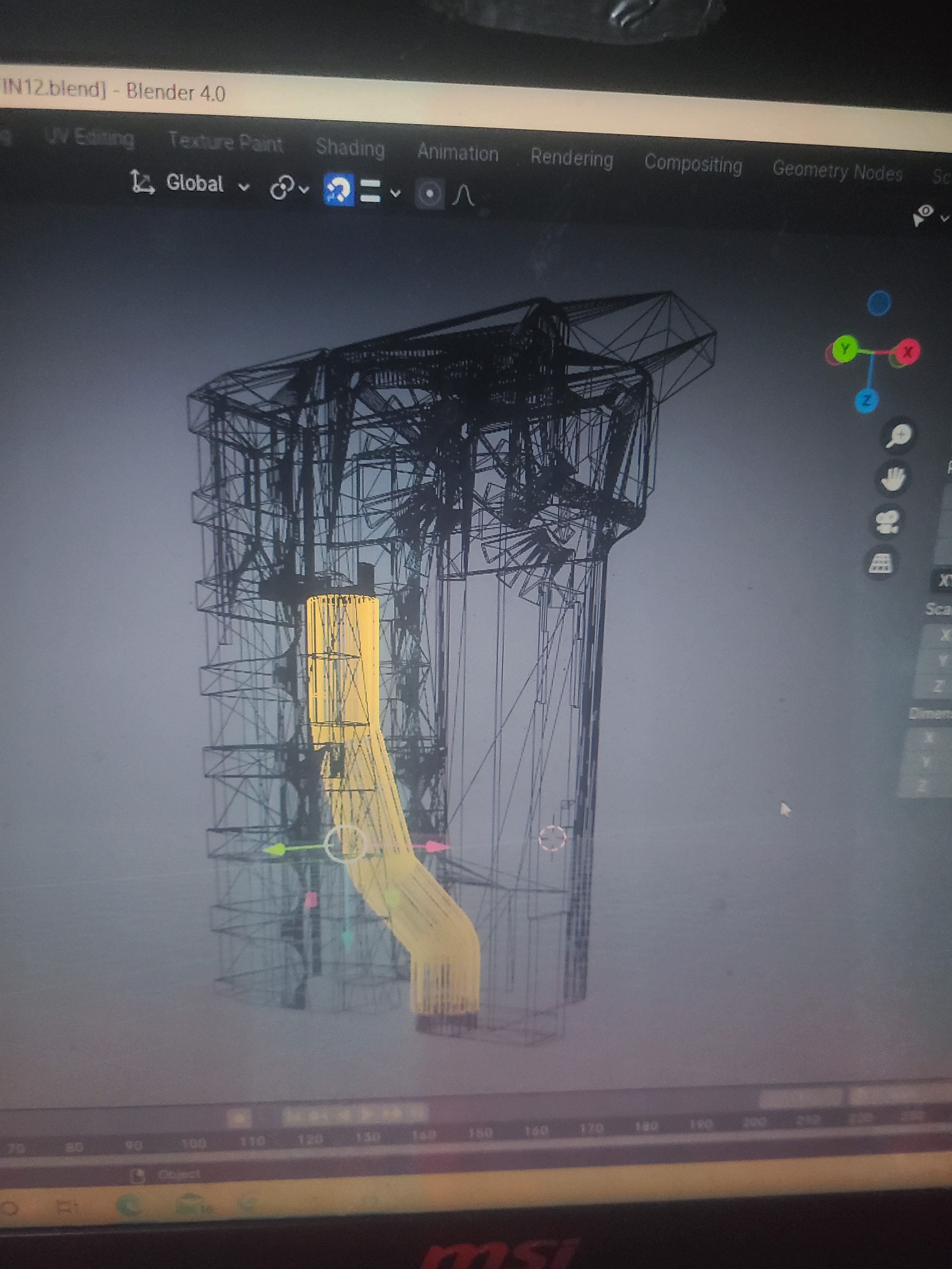

    Today I spent a whole entire 3 HOURS!! Designing and making a prototype Front end loader.
    It will have the ability to feed paint into the mag with force thus no more blank firing.

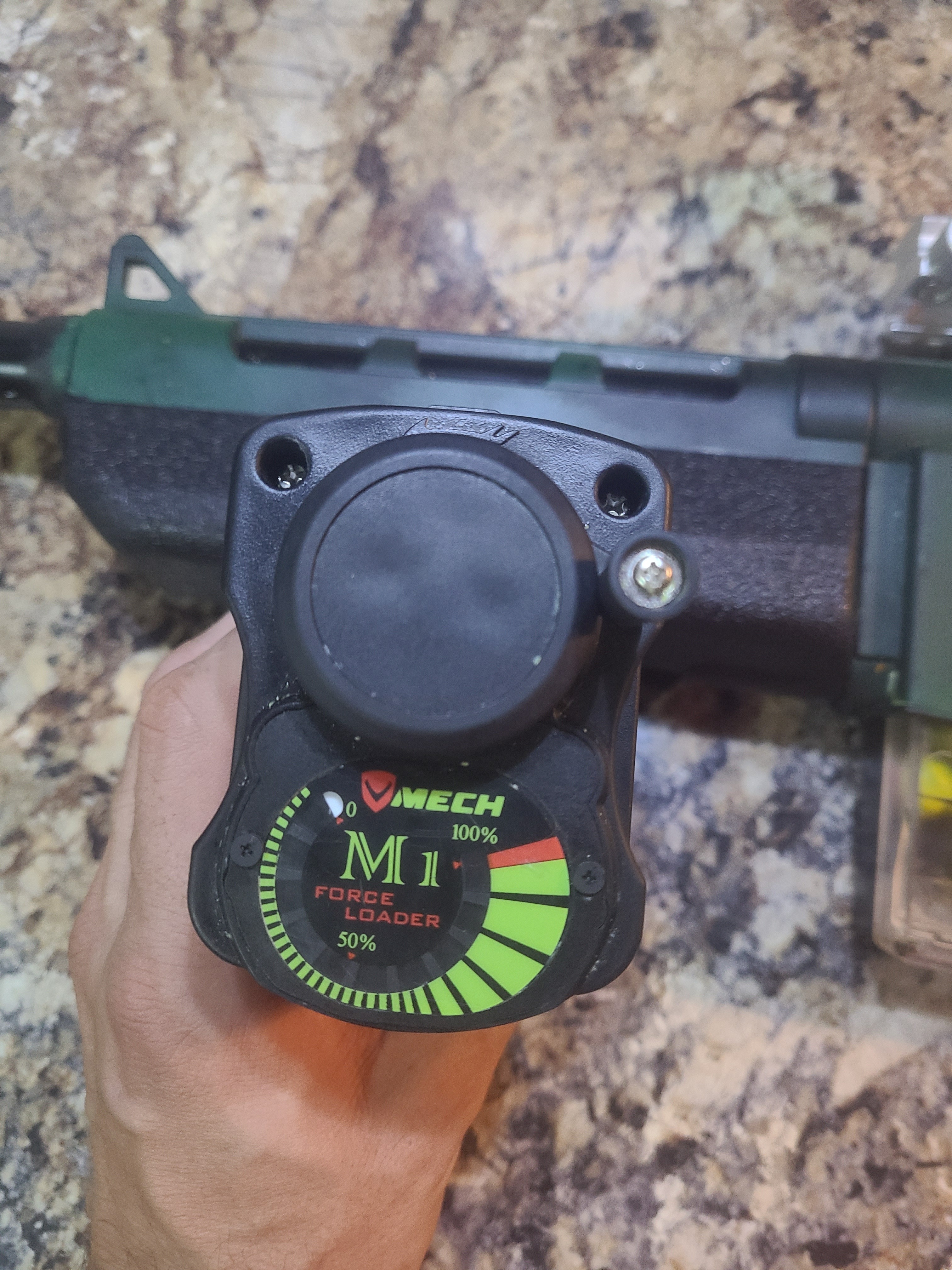

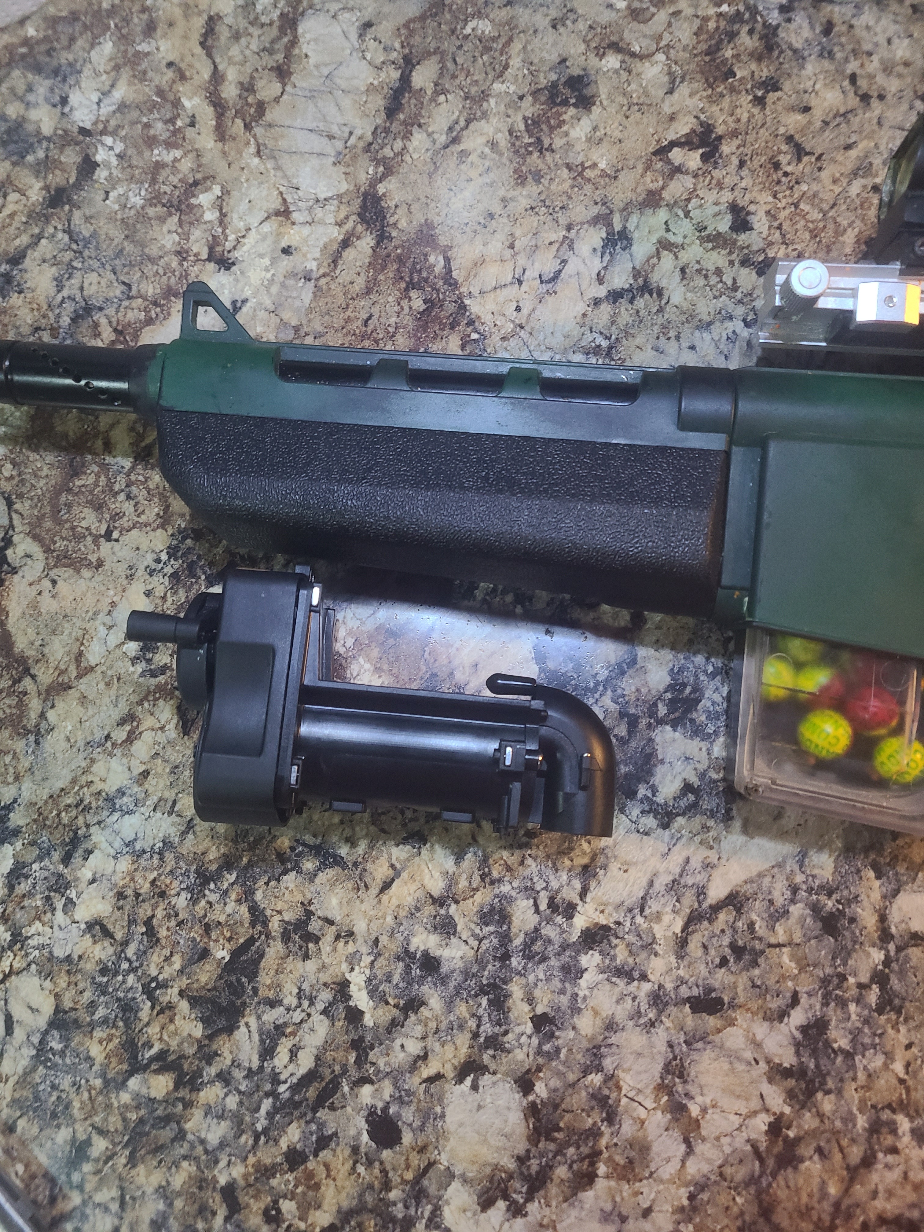

    It will be using the M1 vmech hopper internals to push the balls from the front to the fingers of the mag, basically the same thing as the hopper mag but the hopper will be built into the front end loader.
    ALSO it will have a feed lid on the side to be loaded with pods, hopping it will hold 100-120 balls instead of the 60 in the stock loaders.

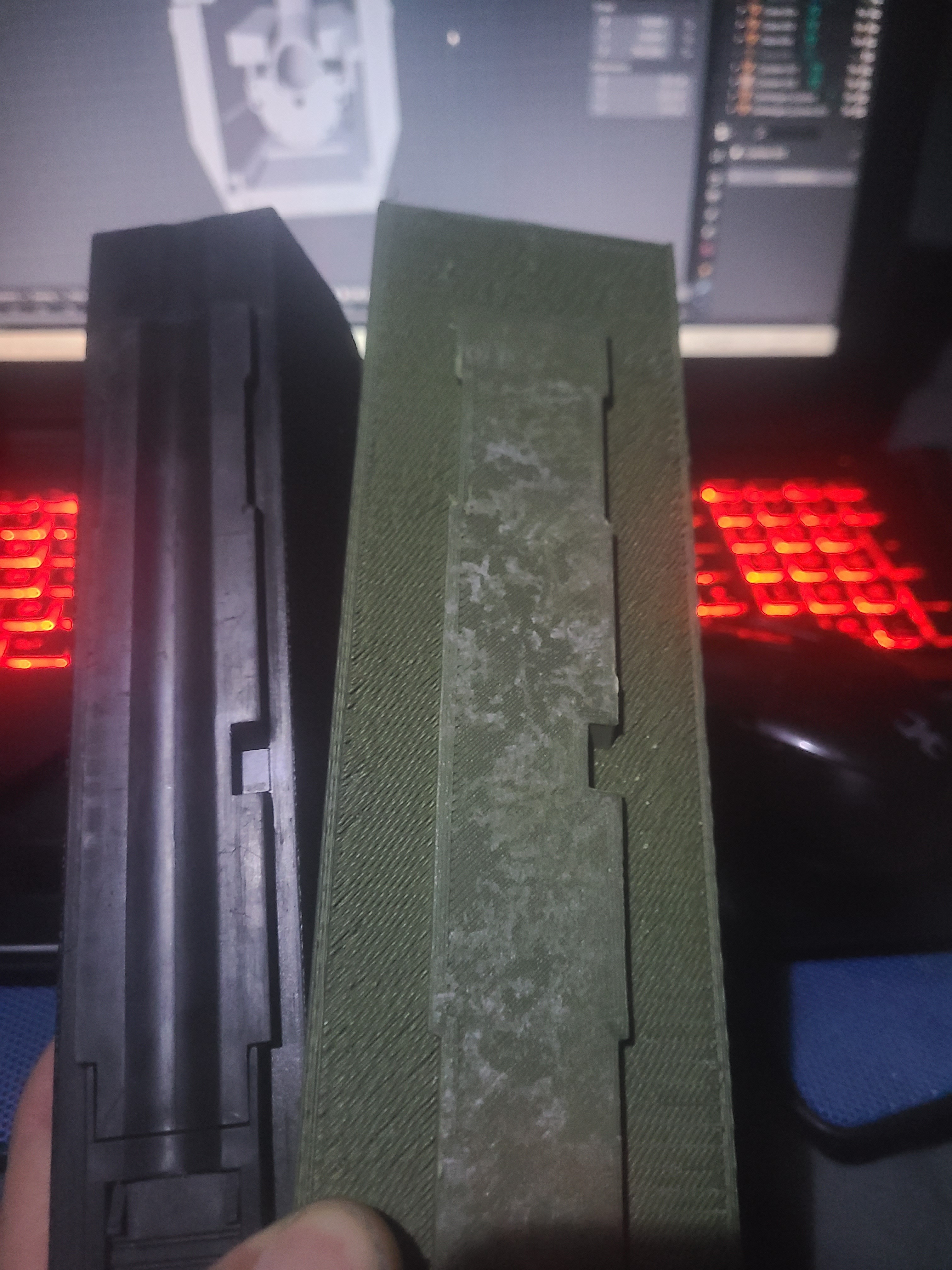

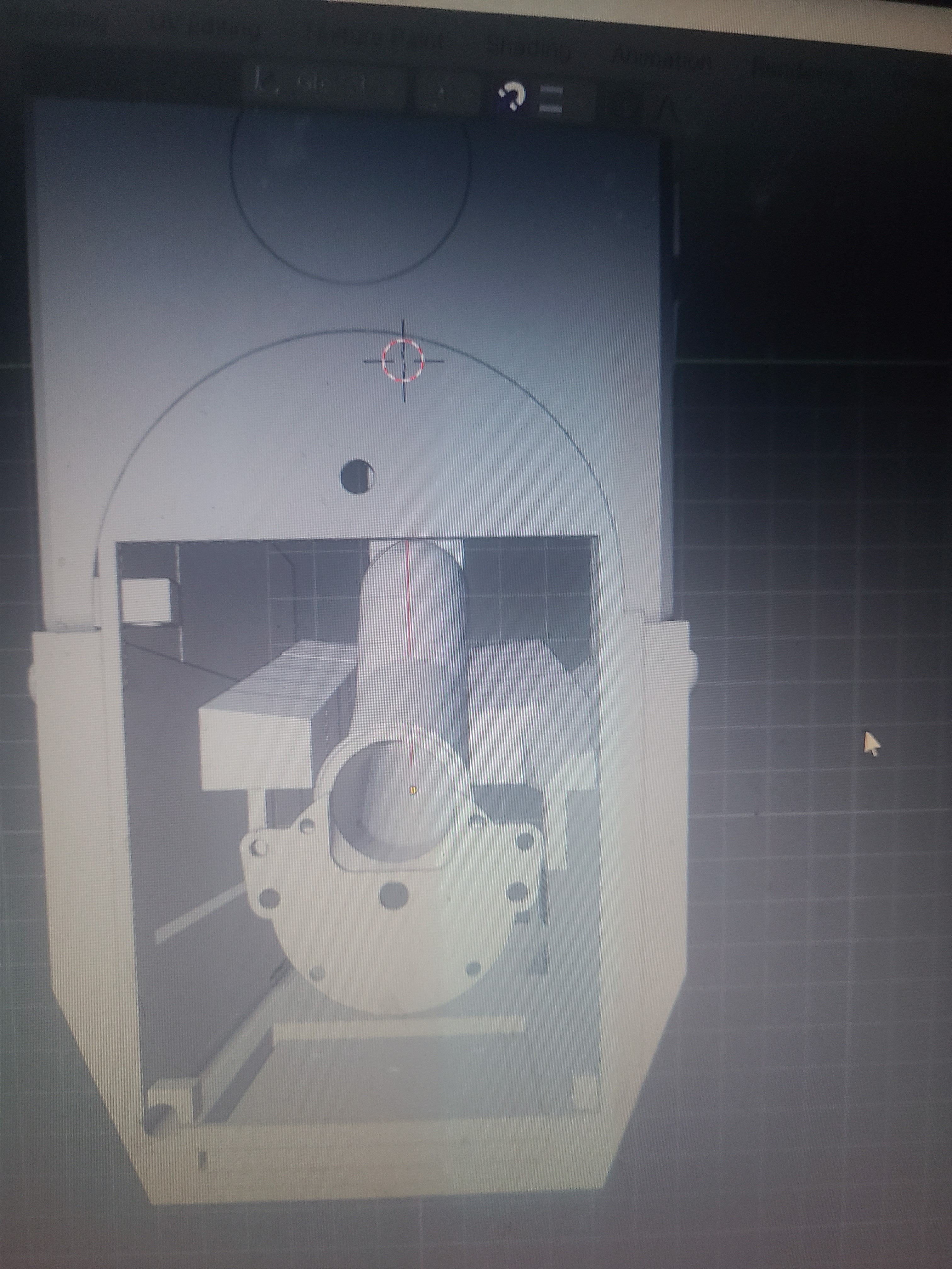

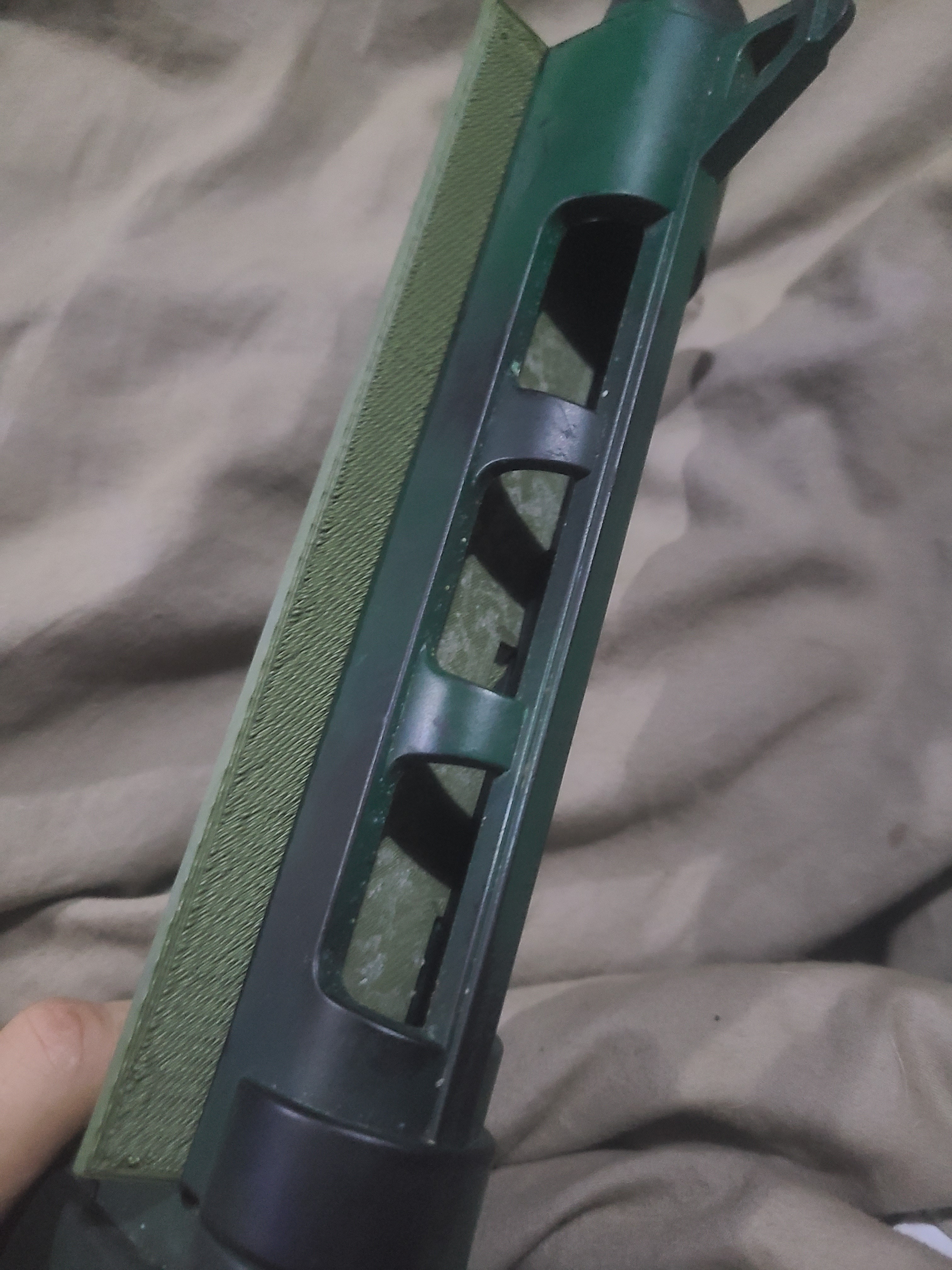

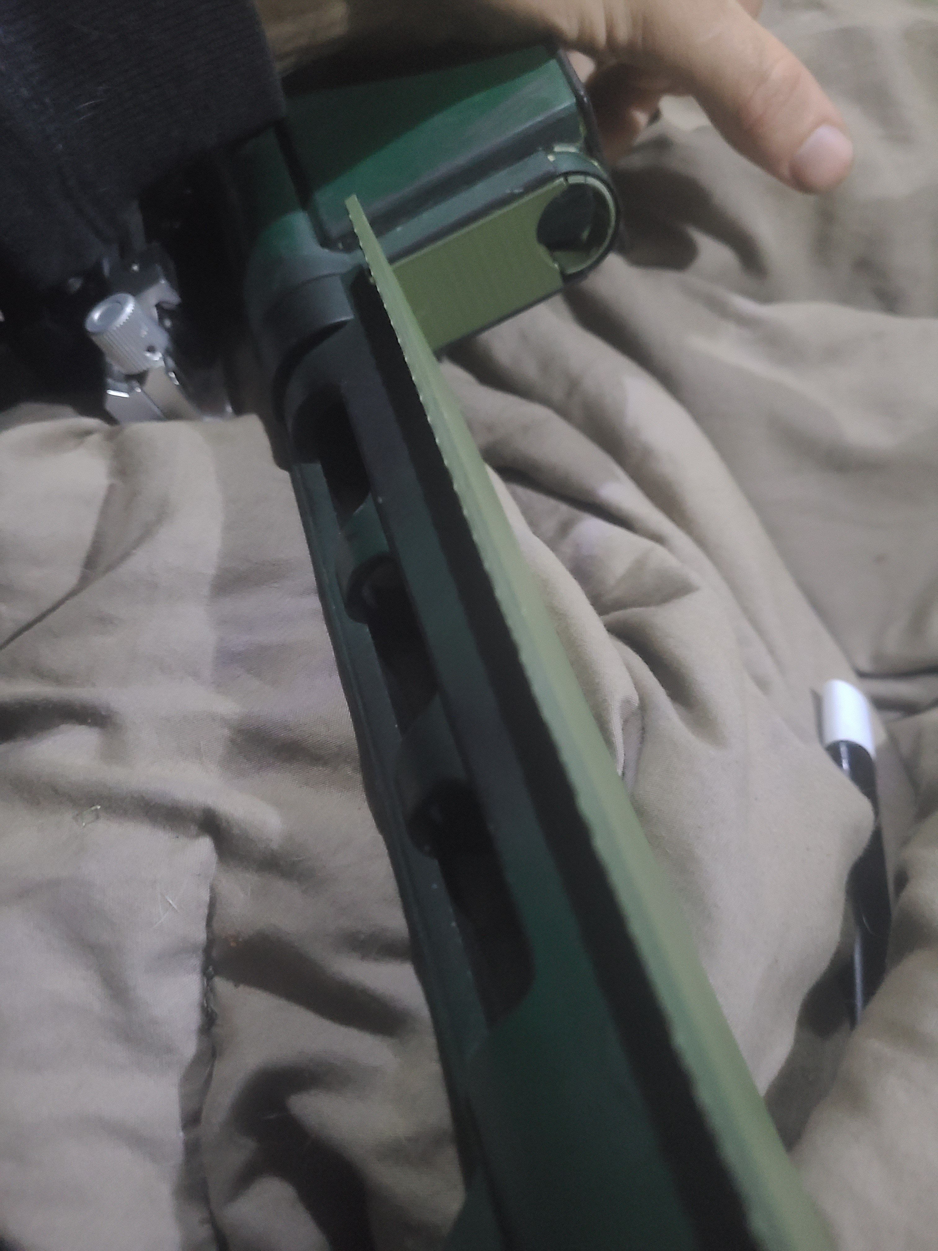

      Update
      i did a test for print . First print and she almost fits/ I forgot to put the bevel for the barrel down the center middle of the lpader so it dosnt fit perfect but all my measurements were pretty much spot on,
      I made up the tubing but I might op out and use qloader hose instead
