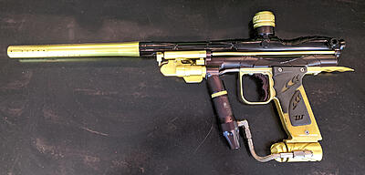

    I'd like to upgrade my stock Karnivor feedneck to a clamping feedneck and have no idea where to begin. I did contact Inception and they don't make anything that will fit a Karnivor.
    Any advice on where to look / threading for a locking feedneck?

    Unless I am very much mistaken, Karnis take "standard" autococker threads. Your best option, IMO, is a Master Sconi feedneck. They're like $15 and really solid.

      Master Sconi feed necks are great for the price. If you want a low profile option, you can send it to a machinist who will cut it: Bearded Works / superman https://www.mcarterbrown.com/forum/c...-works-section, Angry Antles Autocockers (FB), BMC Fabrication (FB) or Nummech for a press-in neck.

          Do you have the Karni twist feedneck with the W in it?
            Looks like it. It is an E1 Karni with a fairly low serial (1300-ish)

              Id keep that baby on there.
