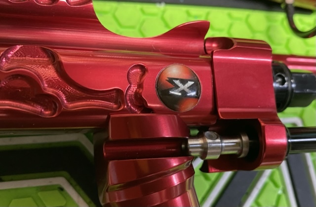

    I was originally going to build a pump, but plans changed and now I am building a mechanical System X Dragon. I haven’t done a mech building over 10 years (if not 15). So I’m a bit rusty.
    I have built a few Snipers in that timeframe, though and I had this body up and running as pump, having borrowed CCM trigger frame from another gun. My Slice kit has since been moved over onto my Black Magic, replacing my older CCM kit. After this project is down I might have to build another Sniper out of spare parts….
    For this mech build I’ve stuck with the original ram and LPR. The Dragon was an e-cocker, so ram and LPR should be able to handle mechanical speeds without issue. For 3-way I’ve gone with an ID 3-way. I have one on my Ressi and really like it. Nice short pull and very easy to adjust.
    If you’re not familiar with System X, their LPRs are unique in that they replace the banjo bolt. So the front block is a little more streamlined than standard. you can put the 3-way a different position from a standard one as well. My 3-way runs under the LPR and ram instead of sticking up beside it.
    For the frame I’ve gone with an ID Hinge Frame. I really wanted a Nummech hoseless frame but I got tired of waiting. I haven’t shot the frame with air yet, but it’s very light in your hand and the action is very smooth. I’m really looking forward to getting to shoot this frame.
    For the internals I had intended on using the stock valve, but after encountering a leak after I disassembled it, so I popped in an ID valve and spring. It was a simple drop-in upgrade and worked immediately with no leaks, which I always nice.
    As it stands I am waiting on my timing rod to be able to complete the assemble. The rod was out of stock when I ordered the 3-way (of course) but came back in stock once I had received my order. So along with the timing rod I have Trident bolt and a fancy gun case coming so I can gets the free shipping….
    I currently have a Shocktech bolt, which is a very similar design to the ID Trident. Both have the three air passages. I’ll be sure to test out and see what the difference is. I know the trident bolt in my Empire Sniper has good FPS gains over a standard open faced ID bolt, and I expect some increases with Trident bolt over the Shocktech bolt, the question being how much though.

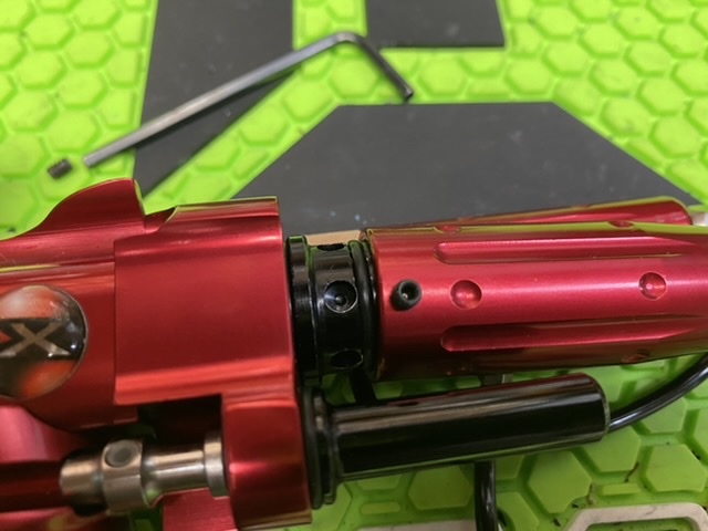

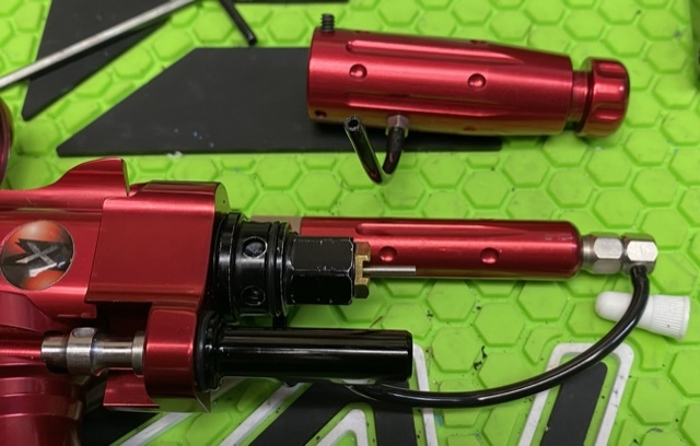

            Still waiting for parts. Will likely arrive on Monday… so left with making sure things are ready. I thought I’d show a few pictures of the LPR assembly, for those that aren’t familiar with a System X LPR.
            And the cap fits on with grab screws, but there are only certain places the grub screws can fit, so it makes positioning the 3-way a little annoying as it changes depending on high tight the LPR is attached:
            You can also see how the front block attaches, around the sizes of the body and not below, like a standard WGP body.

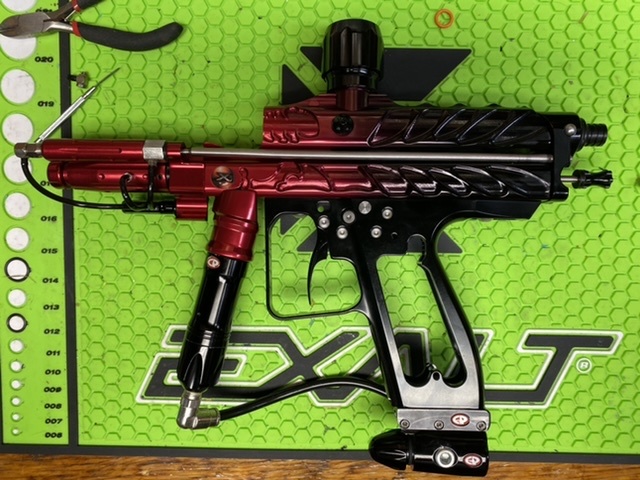

              Parts finally arrived. Timing rod installed. Grabbed a new Trident bolt as well. It’s a little tight and there’s a small
              section that rubs (System X’s famous tolerances). I threw an air tank on to see if anything leaks or my hoses decide to pop and it was all good.
              My scuba tank is under 1k air so this weekend’s goal it to get an air fill and start testing and adjusting.
                • 4560
                Timing a cocker is much easier when you’re not running out of air. Got my scuba tank filled so I can fill my tanks to about 2.5k. A little adjusting of the 3-way and we’re full functional now. It’s raining heavily today so need to wait until tomorrow to throw some paint.
                Once this project is done I need to time my FBM cocker. It’s nice to get back to something a little more technical than fixing old A5s.
                  • 4560
                  Weather was good so threw on a hopper and flung some paint. Everything was good, the started to stuff the barrel with balls. Switched to a larger bore, same issue. Then realized the gun wasn’t cocking even though the bolt was cycling. And finally noticed the cocking rod came loose.
                  After screwing in the cocking rod properly everything was back to being happy. Shot nice and smooth. Light trigger pull and tight timing. Let my kids shoot it (4 and 7) an they didn’t even short-stroke it. Need to chrono it and finish getting it dialed in.
