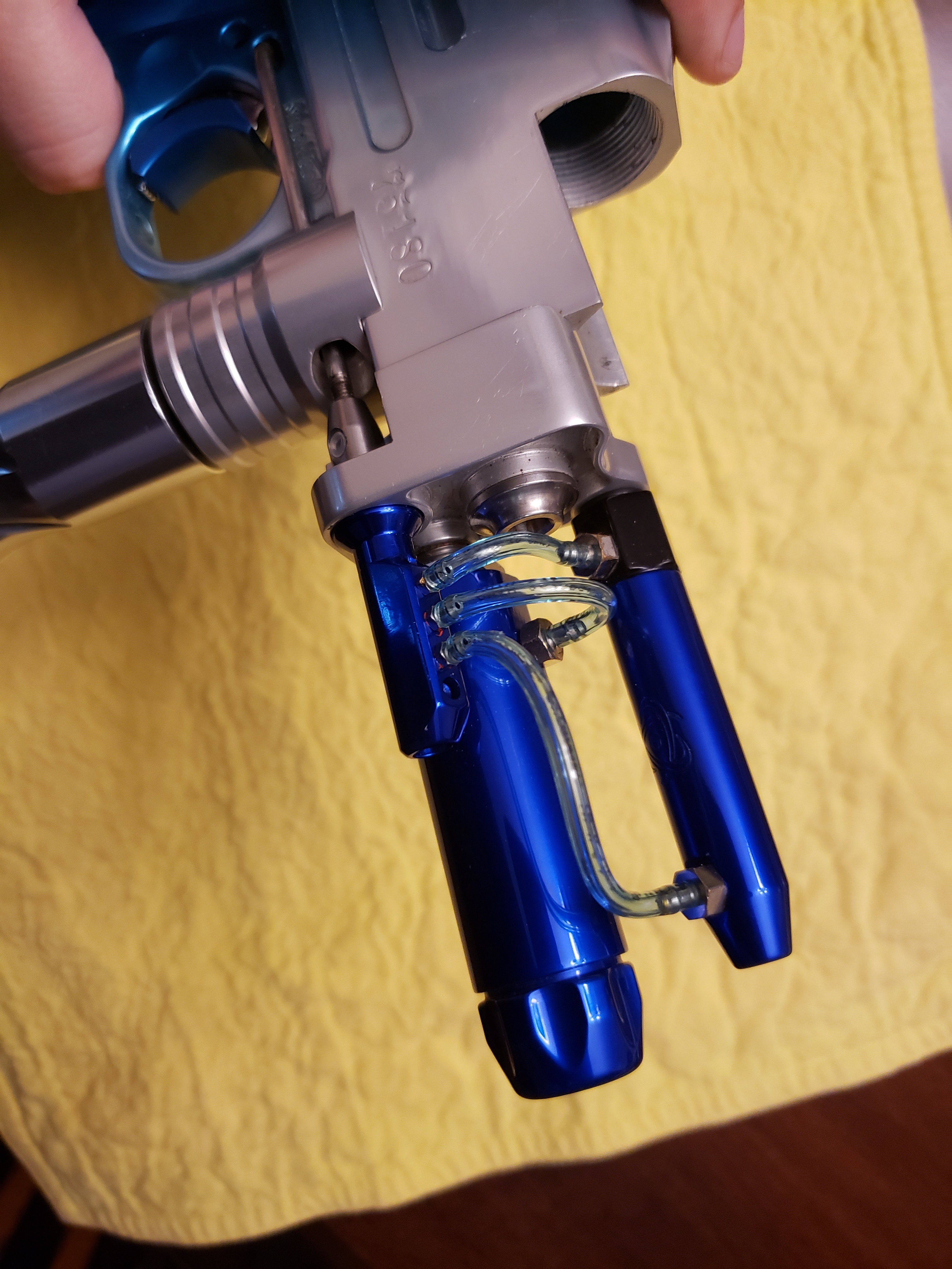

        Definitely recommend inception pneumatics, very easy to time, and have wrench flats where you would want them.
        👑 Pump Kings 01 👑
        💰Ragnastock 01 💰​
        • BlindFaith429
          BlindFaith429 commented
          Funny you say that, the gun is coming with a set of new Inception pneumatics on the front. Was considering swapping them for a set of Shocktech parts, since it is a Shocktech AC.
          HOWEVER, the set of Inception parts were custom colored blue to match the gun, so I may leave them for the time being.

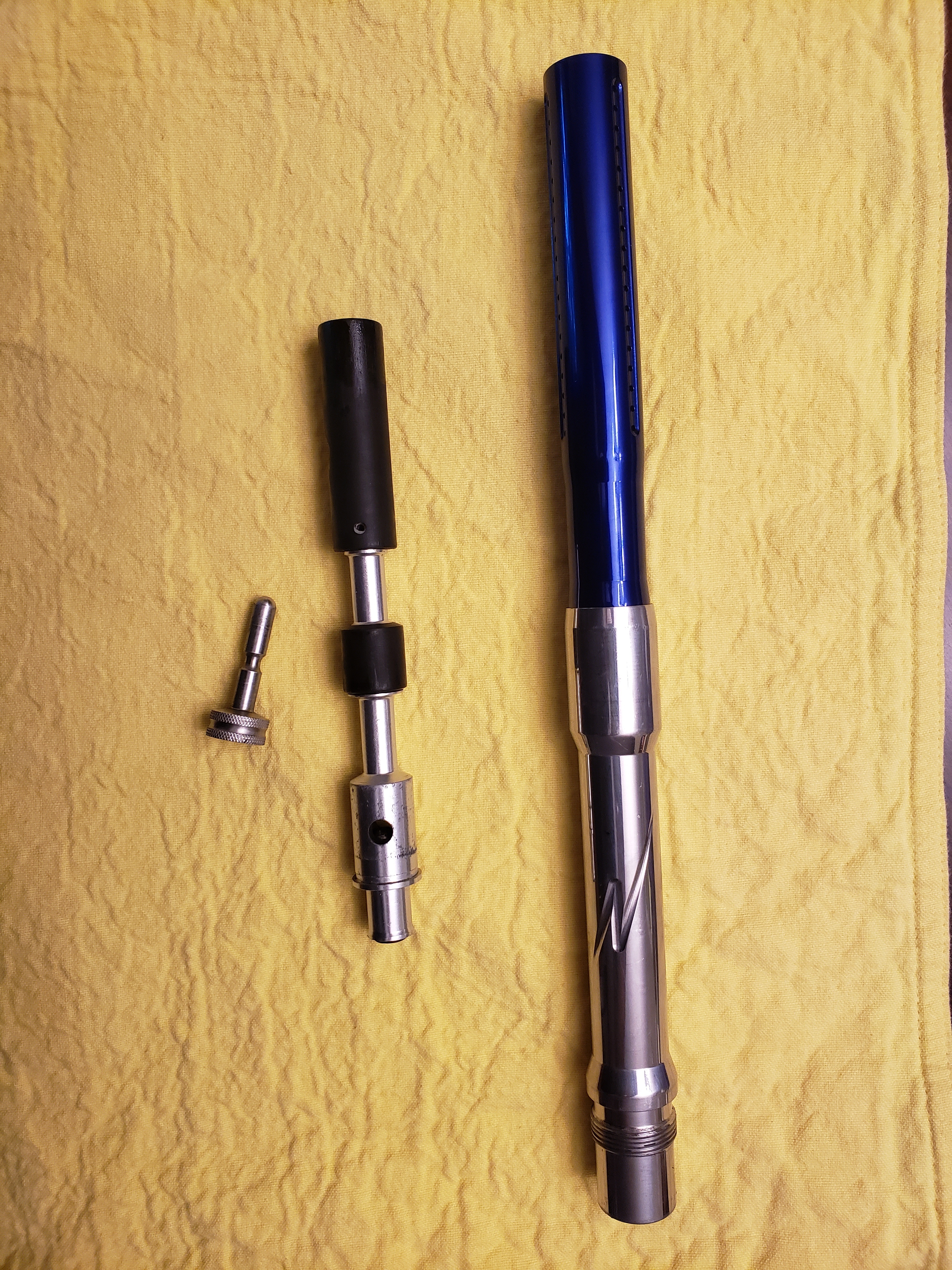

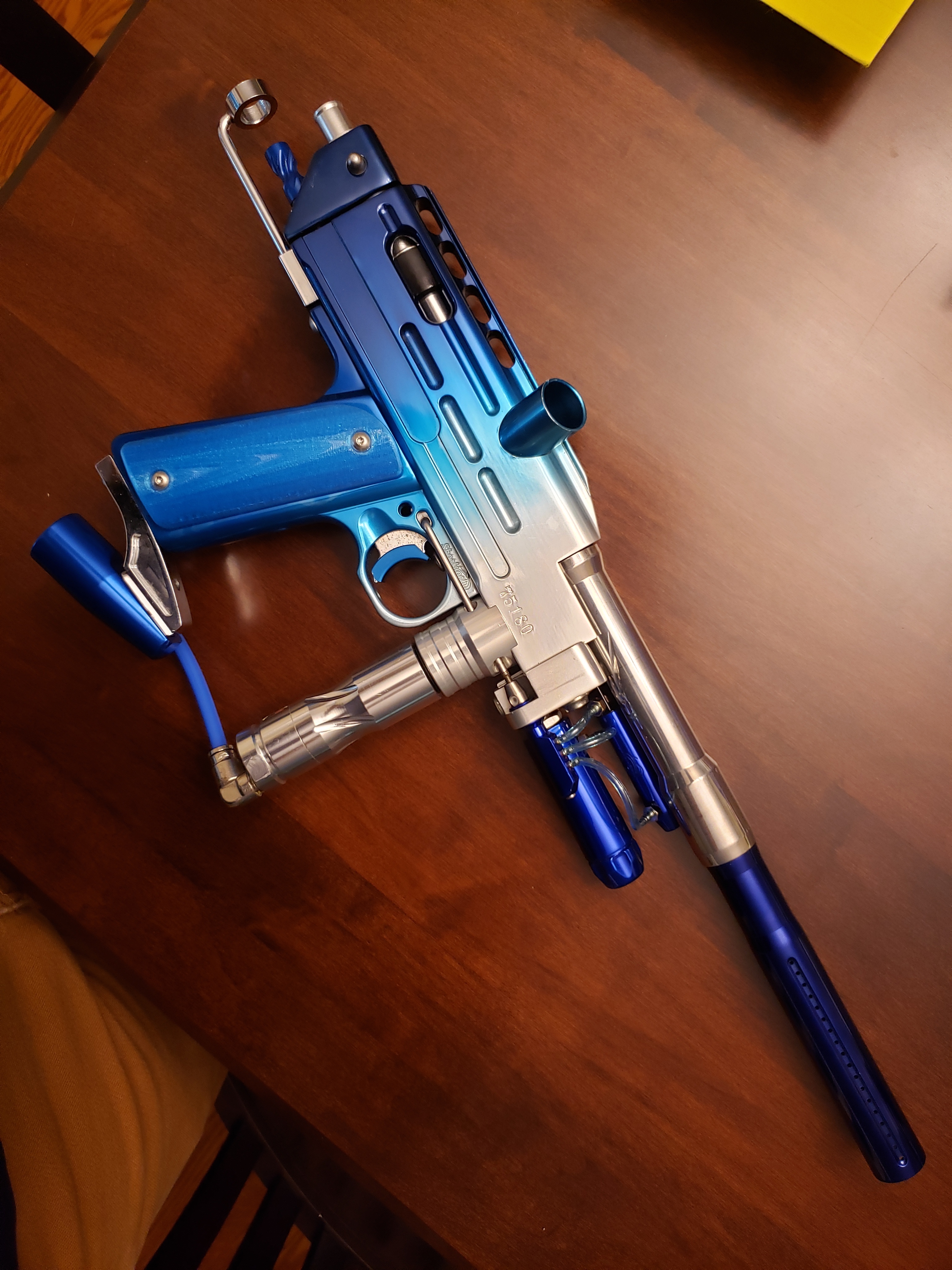

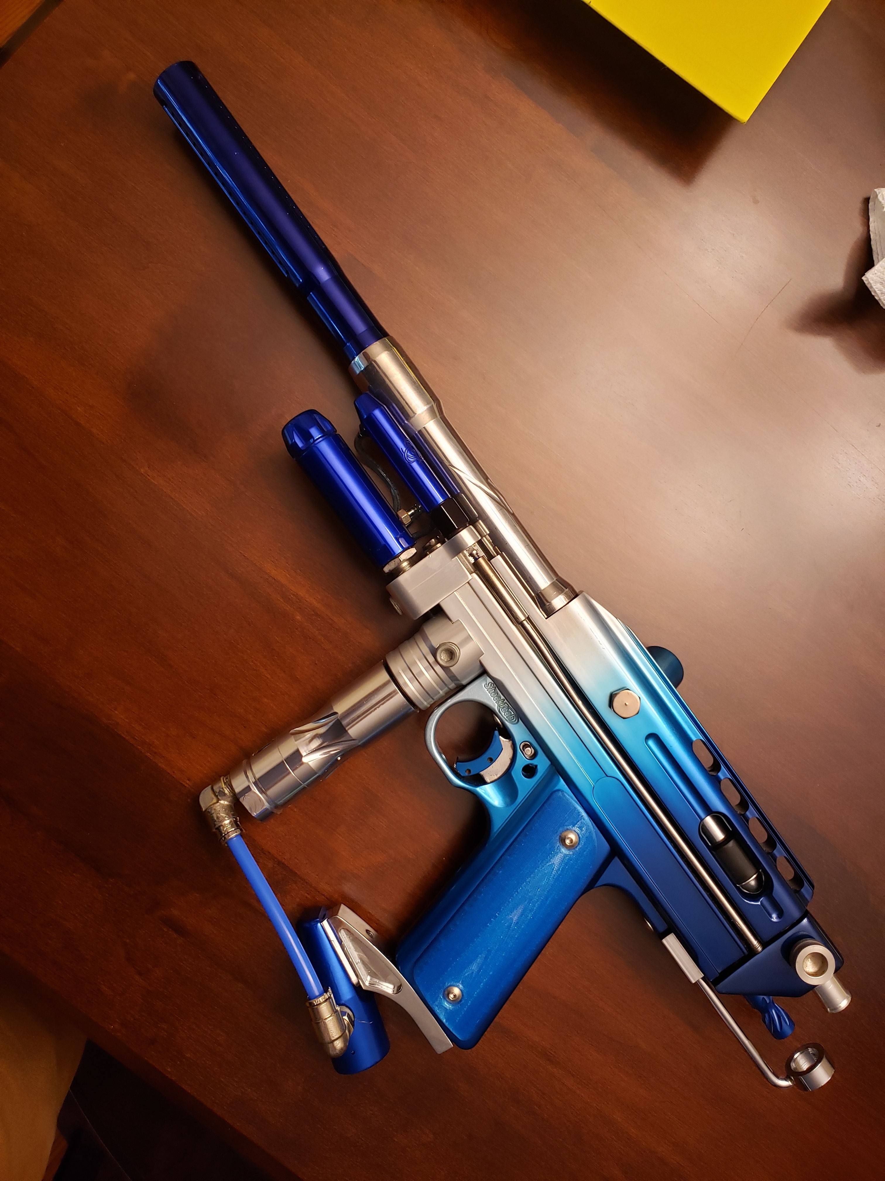

        Okay, got the gun tonight. Very pleased with it for the price I paid and the condition. I probably paid a little too much by the standards on here, but im pleased and that's all that counts.
        It is the standard IVG as previously mentioned, so win on that.
        Not sure who makes the barrel, but it looks pretty nice. Will have to try to measure the bore, as I dont see any marks (and was probably made prior to people caring about the bore size).
        Not sure what brand the bolt is, looks like a combination of delrin and either stainless or aluminum.
        inception parts look brand new, other than the marks on the ram shaft where it looks like the wrong wrench / adjustable was used, and boogered it up a little.
        Have some parts for it en-route, to make it a little more my style / liking. Will also be doing a full tear-down and rebuild with new o-rings.
        • OpusX
          OpusX commented
          That is a Shocktech SupaFly bolt
      • Hellion360
        Power Lurker
        • 2514
        That barrel is a J&J BTW
        Looks like the ones that came with WGP STO 2k2 year
        old PBN feedback
          MCB member
          • 3511
          • Montreal, Qc, Canada
          Nice Shocktech Vortex, from what I understand its quite rare with only 25 made in this fade blue to silver pattern.
          I use to have one and still regret selling it (had the jewel on mine).
          With the inception pneu you got a really nice machine (usually have shocktech front end with the shocktech bomb 3 way)
          Seem to be missing the shocktech trigger plate but the rest of the part seem all there.

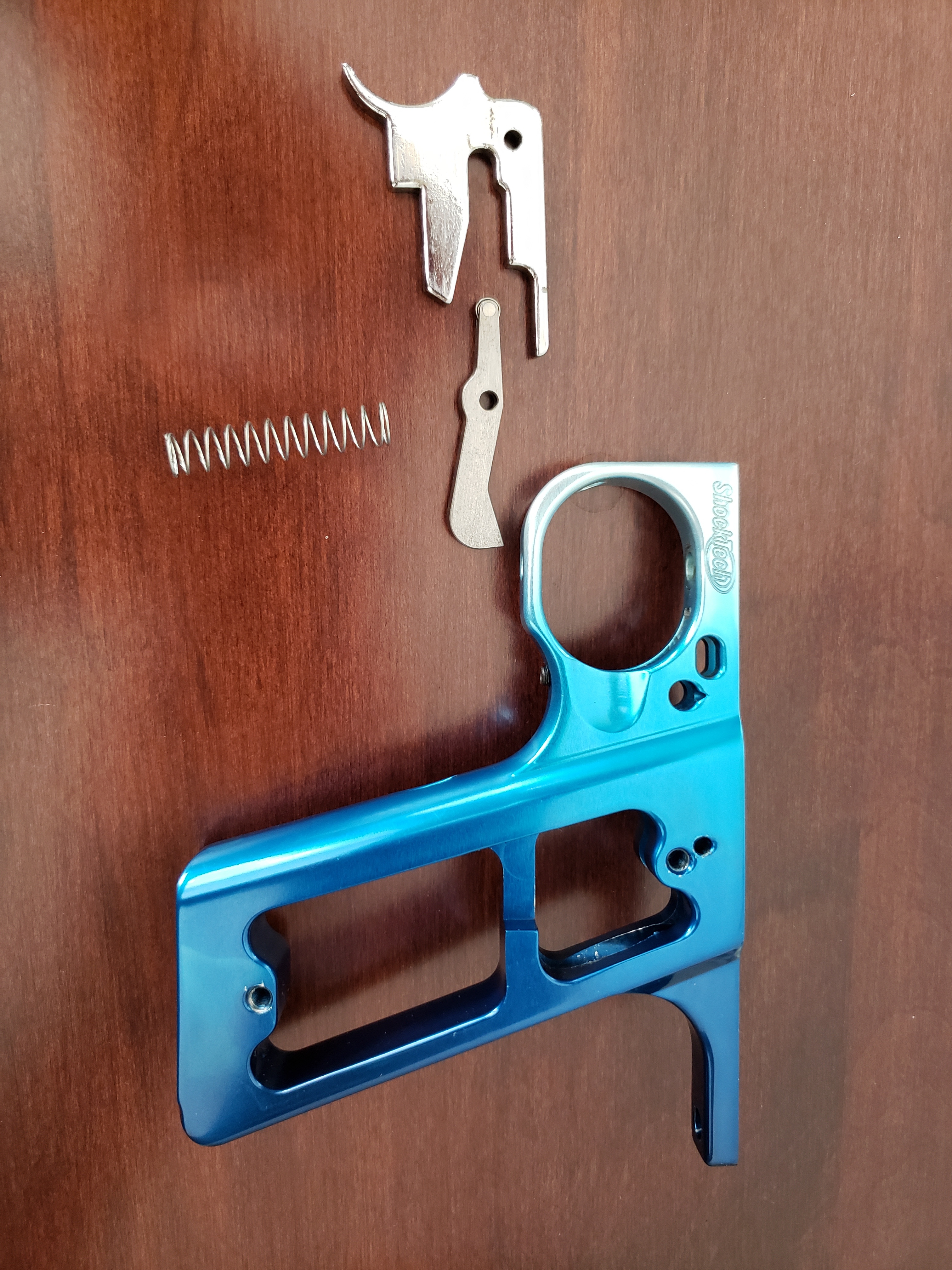

            Here are the guys to my slider frame. I'm missing the trigger return spring, but already have one en-route.
            I don't like the looks of the trigger plate. That chrome chipping off doesn't look like it would slide nicely on the aluminum body. Plus it doesn't look like the original trigger plate. Will be ordering a replacement for sure.
            On the plus side, the current sear is a roller variant. May give it a quick polish prior to re-installing it.
            • latches109
              Always Sciencing
              • 2075
              Order a new shockteck plate & sear.
              What hammer and valve are in there? I have an abundance of ST hammers.

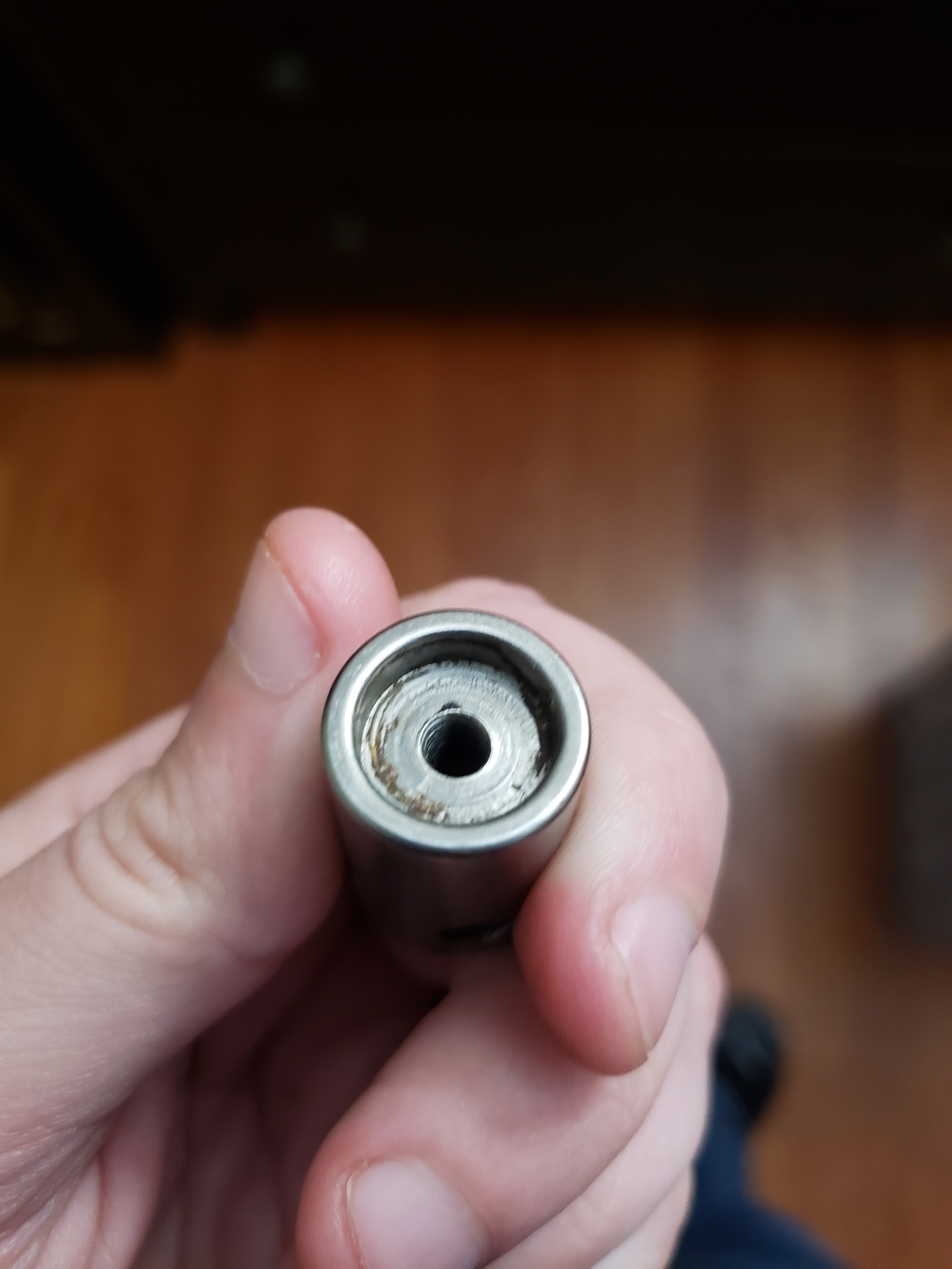

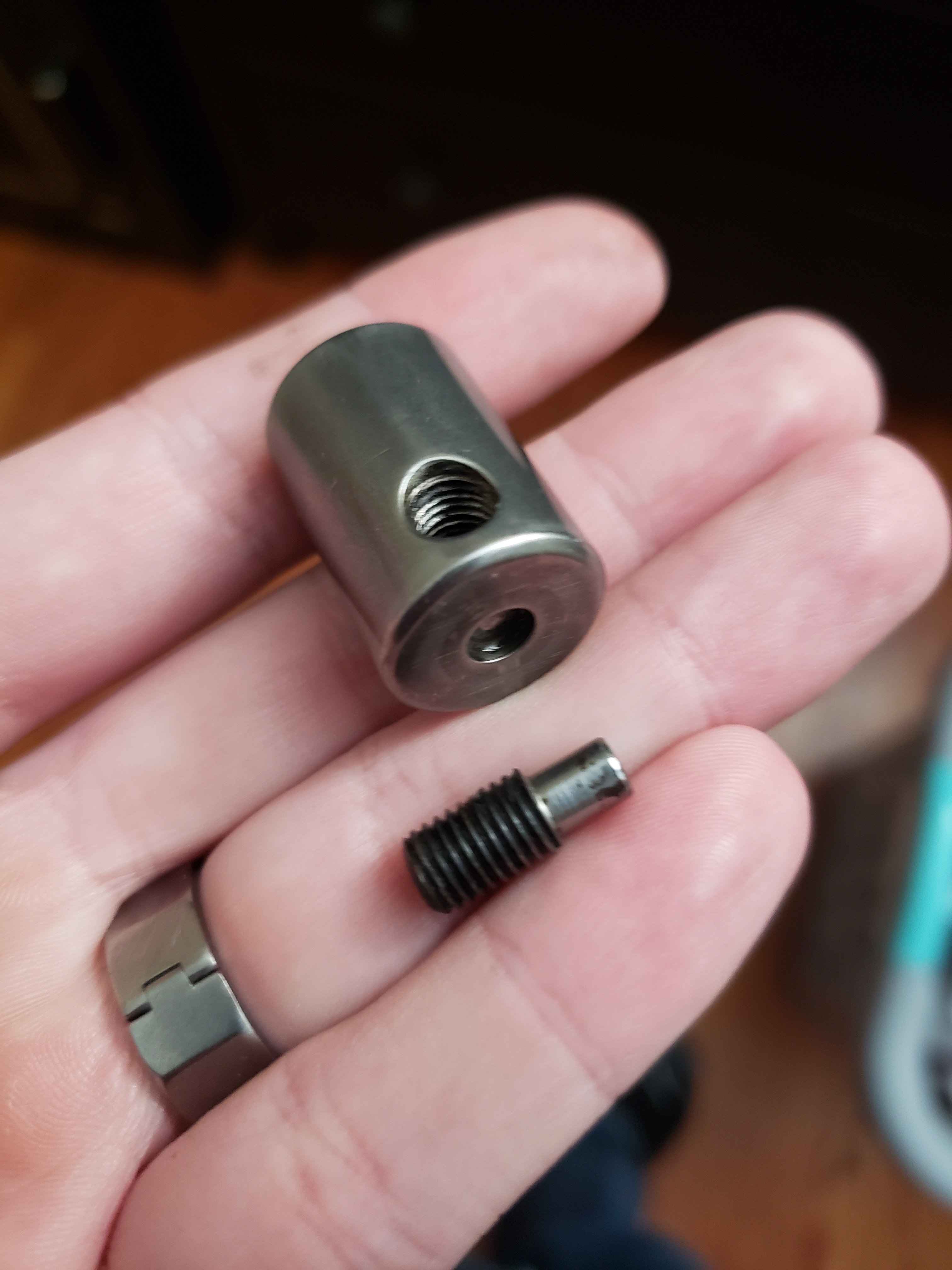

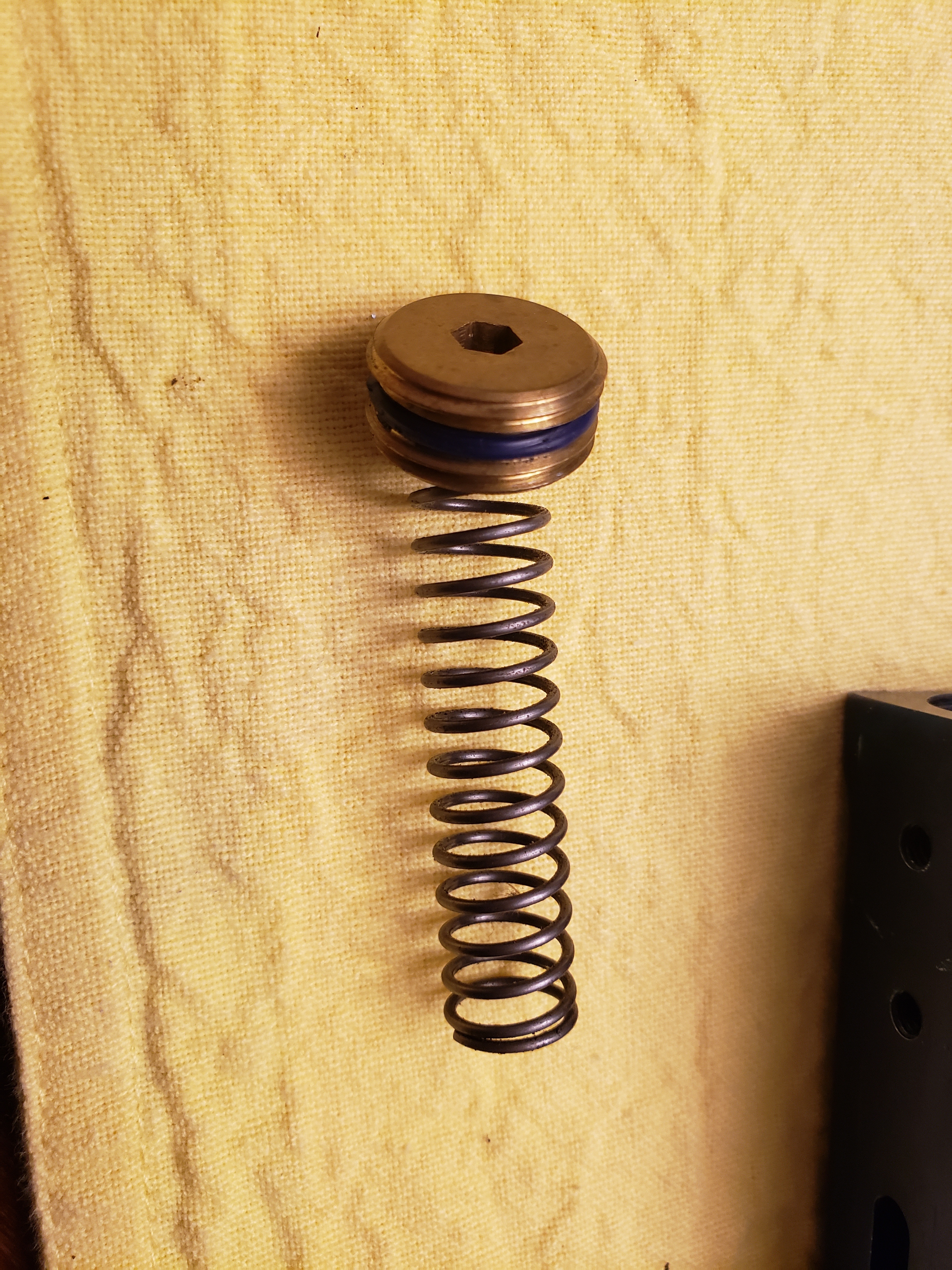

                    Out of curiosity, I pulled the valve lock set screw and looked down the hole. The valve looks to be brass inside, which would make me think stock WGP.
                    • BlindFaith429
                      Thanks for the heads up. Any way to tell once it is out?
                    • latches109
                      latches109 commented
                      high flow stock, eclipse, ccm, and palmers are all brass too. If the valve is drilled all the way through it can only be stock, eclipse, or palmers. The old rat valves were flat on the bottom, ccm have the cone divet. Seeing your hammer is stock I would guess the valve is too.
                    • BlindFaith429
                      The valve was brass, and it had a flat spot for the set screw to seat onto. Based on your description, it sounds like an old Rat Valve.
                      Nice to know considering I was expecting a stock WGP valve to match the stock WGP hammer.

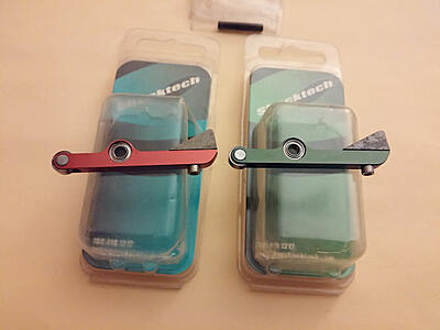

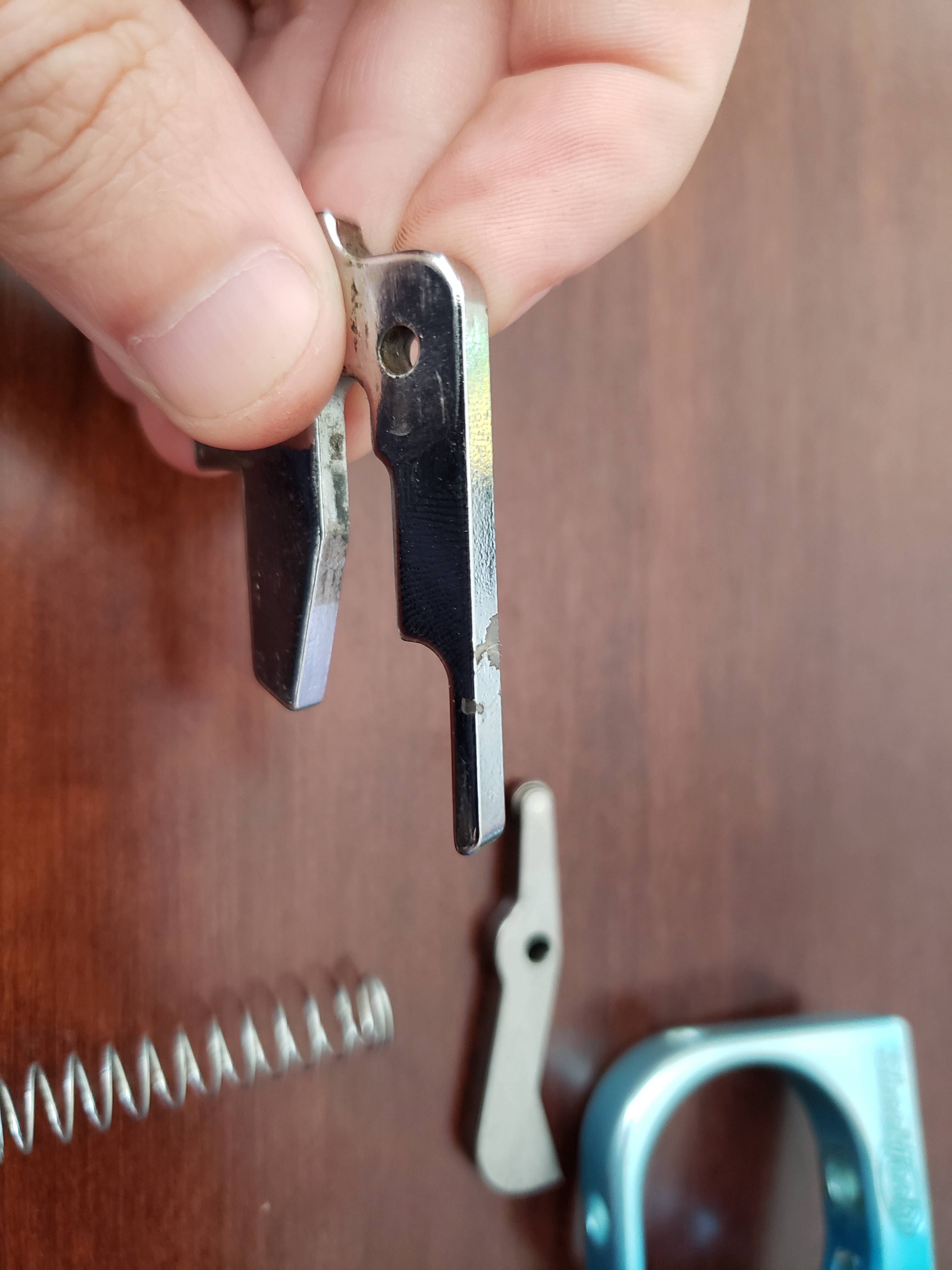

                    How are the older aluminum dual roller bearing sears? The ones with the bearing at the frame cross-pin and the roller on the trigger? Gimmick or actually worth it?
                    • Brokeass_baller
                      Brokeass_baller commented
                      Aluminum? I don't know of any aluminum sears. I imagine they'd get chewed up pretty quickly.
                      Roller sears in general are pretty nice. But I couldn't tell a big difference between my Shocktech, Telios, and WGP roller sears. I can tell you that the Telios roller bearing trigger plate has made a massive difference in the trigger pull, though. I run the full Telios kit now.
                  • BlindFaith429
                    • Oct 2021
                    • 496
                    Brokeass_baller Here's a pic of the one's I'm talking about. I assumed they were aluminum due to the colors and the bolt-on "wedge" for the sear contact point.
