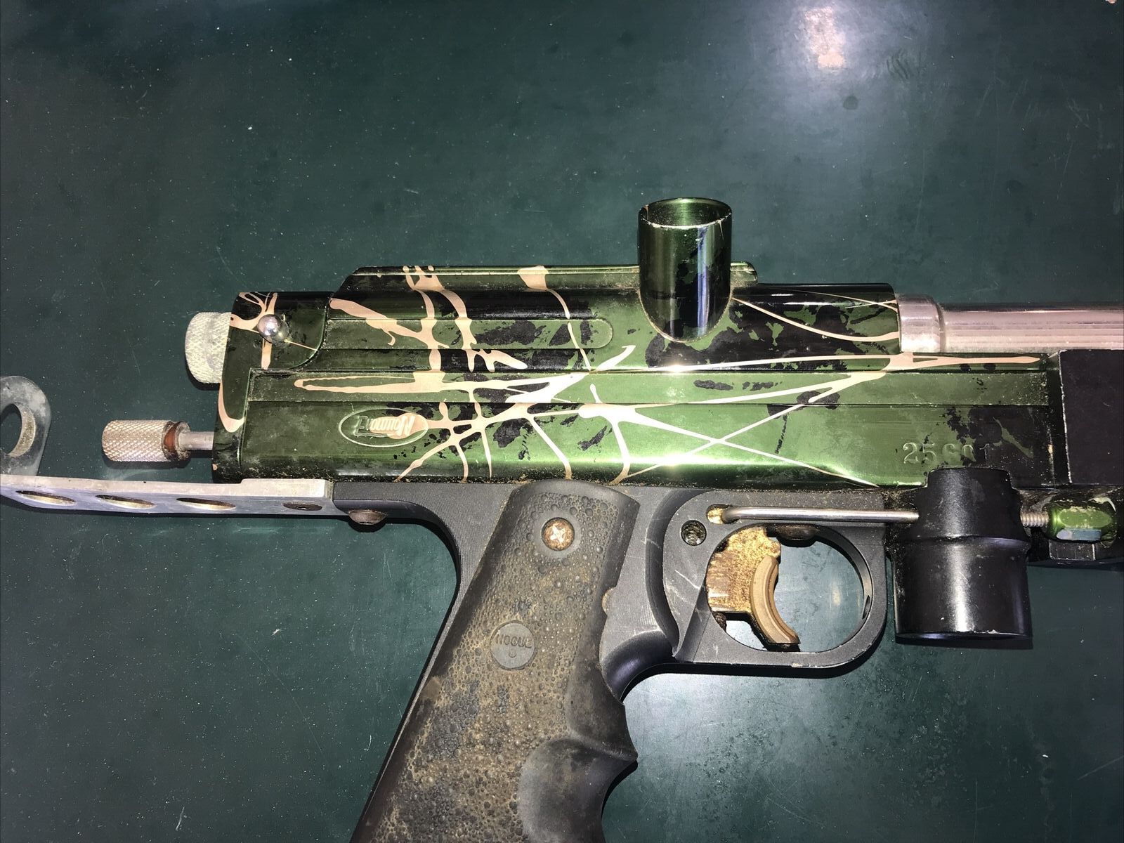

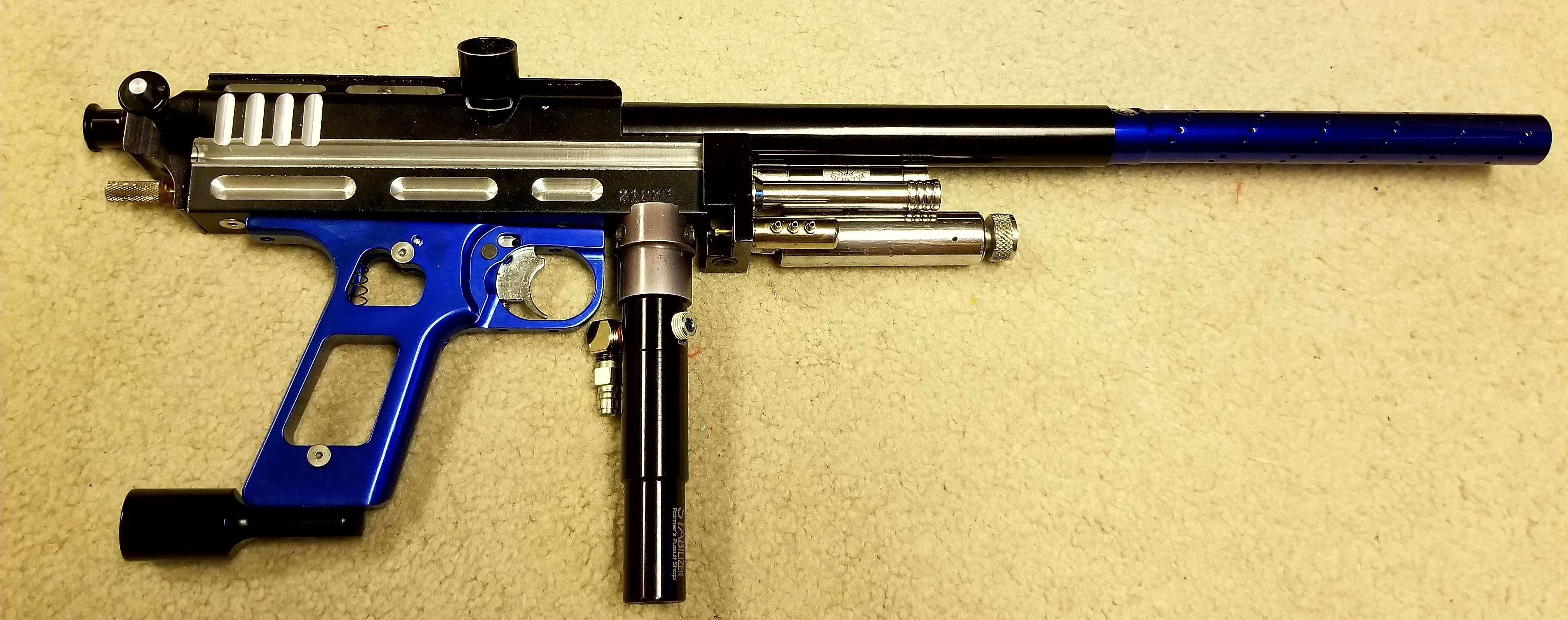

    Just starting out in paintball, I lusted over all the various cut, carved and anodized autocockers out there, and as many I was in no position to buy one.
    I loved the splash patterns in the Smart Parts / Eclipse catalogs (quite specifically Banzai Green) and the simple cuts on Carters (the sight rail through cuts, vertical 1911 style slide cuts, and long ball end mill bottom tube cuts just looked so great).
    So that was the goal, Bonzai Green splash with a Carter-esque homage style of milling.
    Some inspirational pics:
    Belsales Evolution in Green Banzai Splash
    Click image for larger version  Name:	green_splash_evo_97.jpg Views:	0 Size:	294.0 KB ID:	185704
    Earon Carter ABC Autococker (pic from baccipaintball/paintballhistory)
    Click image for larger version  Name:	abc_paintball-left-body.jpg Views:	0 Size:	56.1 KB ID:	185705

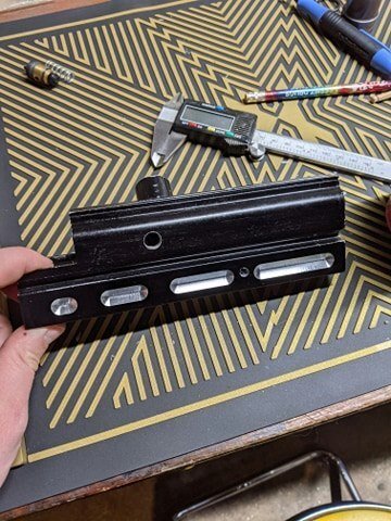

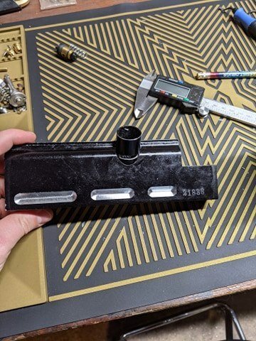

      Another major aspect for me was thinking back to watching Mark Jacobs, who at the time was the Jaegers airsmith and machinist work on carving up cockers. I wanted to try and relive that local craftmanship experience, with something for me.
      I got so very lucky in that regard. KCCockerDoc is the current resident airsmith and machinist at Jaegers and when I approached him with the ask of “hey can you do some Carter-esque cuts on a cocker body for a bad ass build?” he was almost as excited as I was.
      His work could not have been better, and really brought the dream together.
      Teaser pics during milling (in process/incomplete):

      • gabe
        gabe commented
        It's for venting blowback. Older autocockers usually didn't have too bad of blowback but if the timing slipped it could be pretty bad. They also didn't have great hoppers either so a little blowback would really mess things up.
      • OpusX
        OpusX commented
        Yep, like gabe commented, it was to allow for any blowback, if it occurred, to escape the feed without bouncing the ball stack, similar in concept to a powerfeed.
      • KCCockerDoc
        KCCockerDoc commented
        Sorry, always forget to check my mcb. Insanely happy with how well this turned out, and honored to be part of bringing an old dream build to life. Pardon me while I get back to working on a p block for nobbie333!

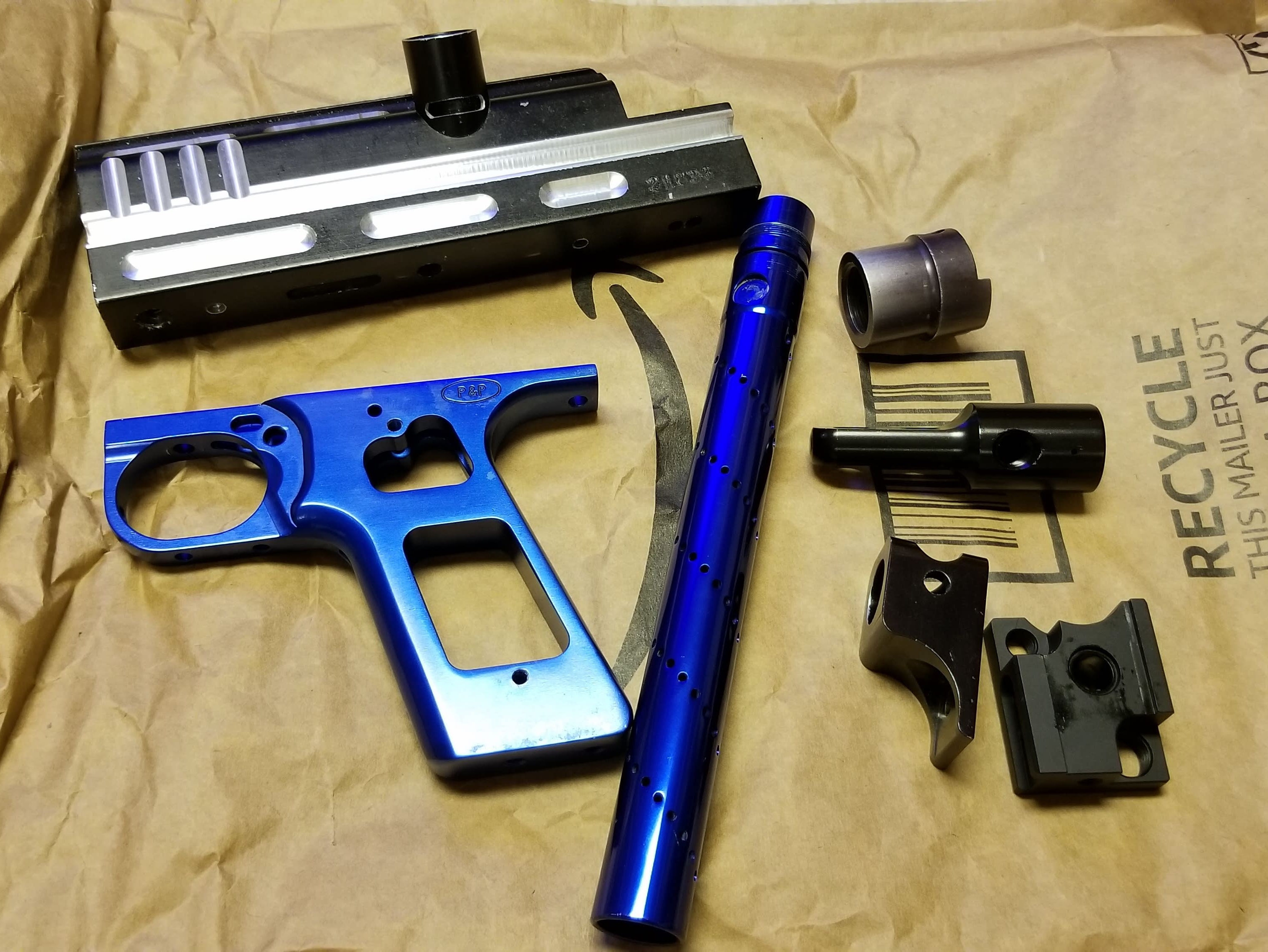

      Ok so I had a body and a HPR, but at that point nothing else. I wanted to try for all the period correct bits. For me that meant you had to go with legendary Palmers bits. Velcor be praised for he headed my offerings of 12 grams and 10 round tubes!
      I ran into this big ole lot of bits on the local-ish craigslist and there was a whole set of Palmers goodies in there, plus mostly everything else I needed; P&P 45 frame, Evil valve, vasa, shocktech bolt. Things were coming together nicely.
      Got the whole pile of parts together and did a quick test fit on things. The reg indexed in the vasa perfectly, front block bits just look great. Yep we’re ready to get this lot sent to anno. This went out with a few other markers, so now nobbie333 and Myrkul all match.

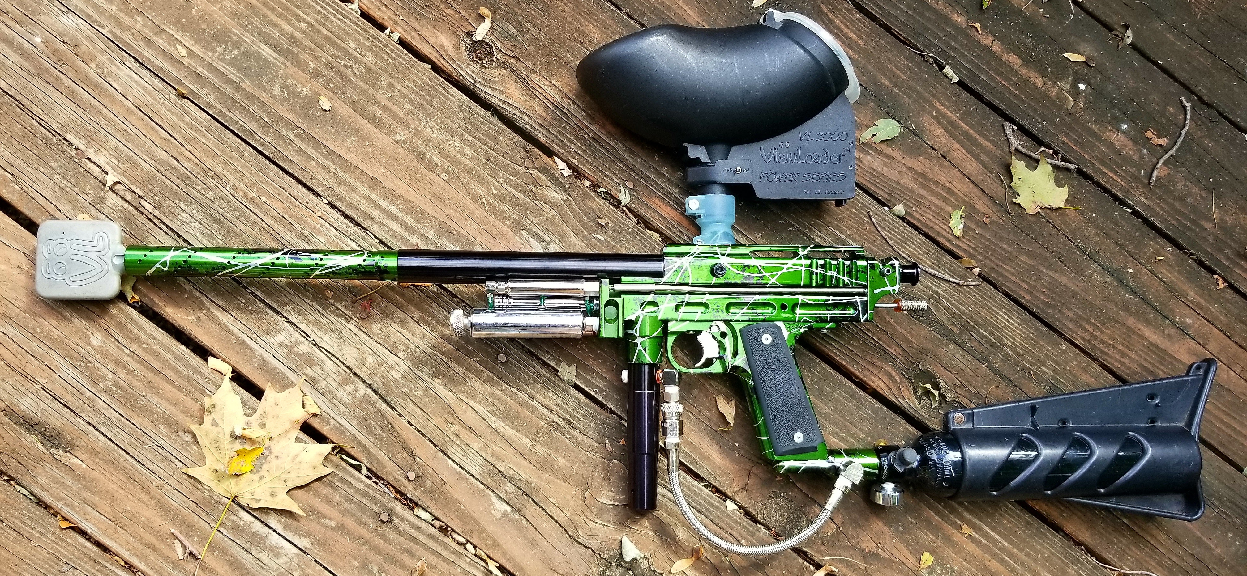

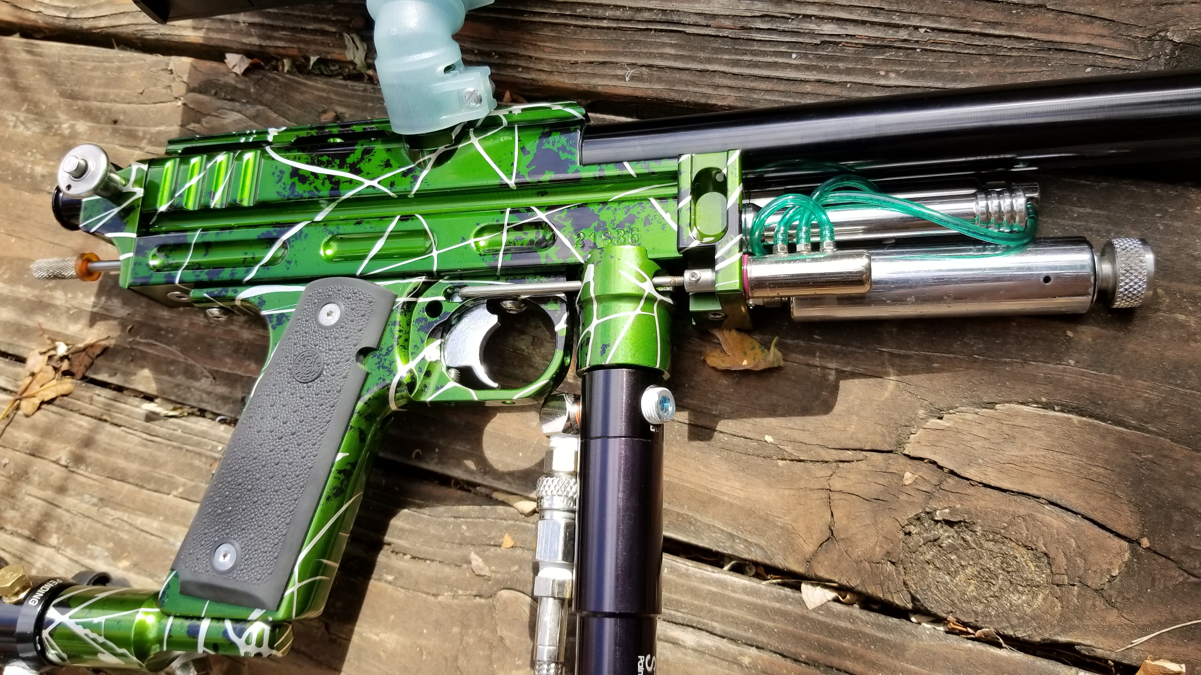

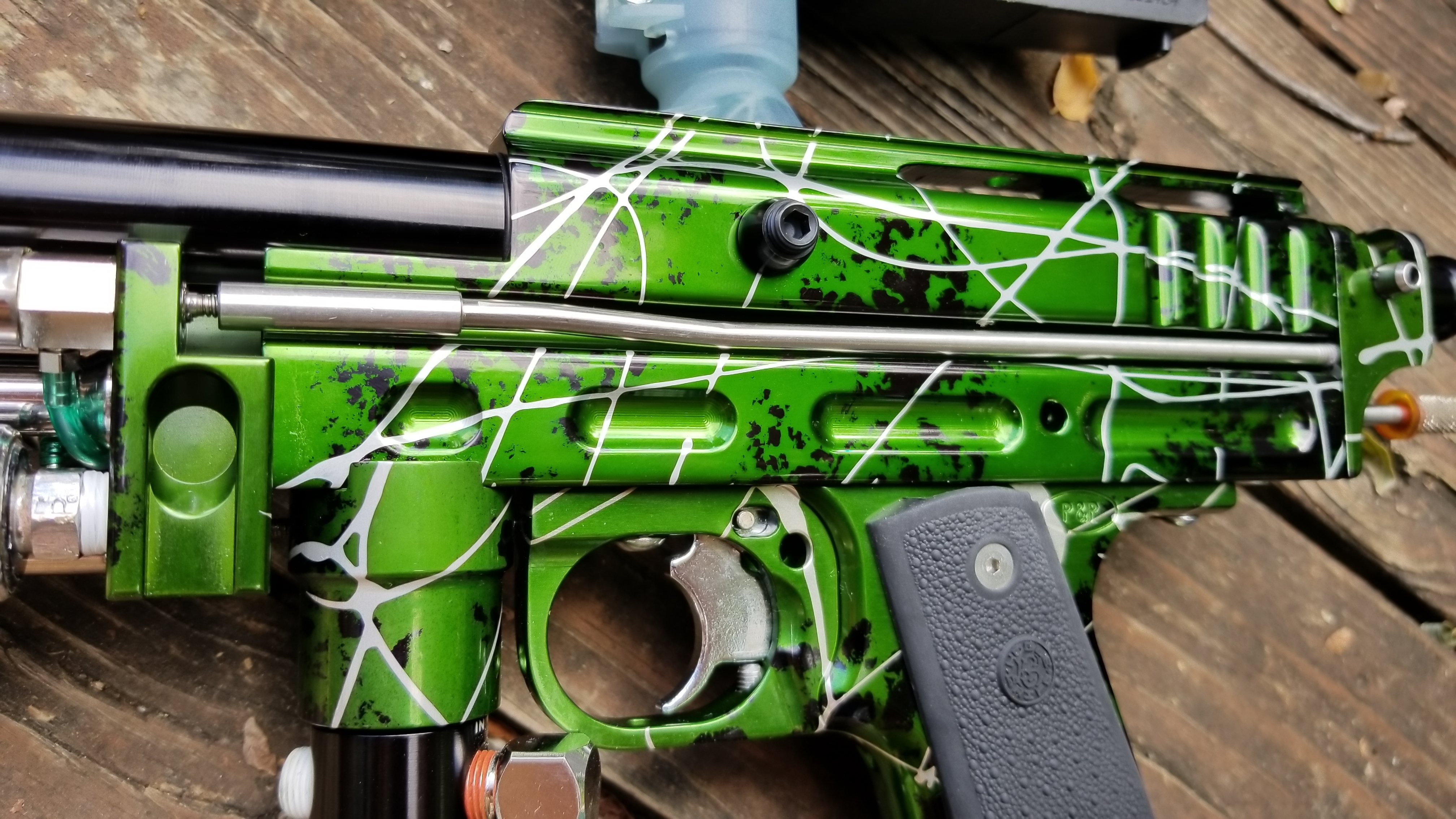

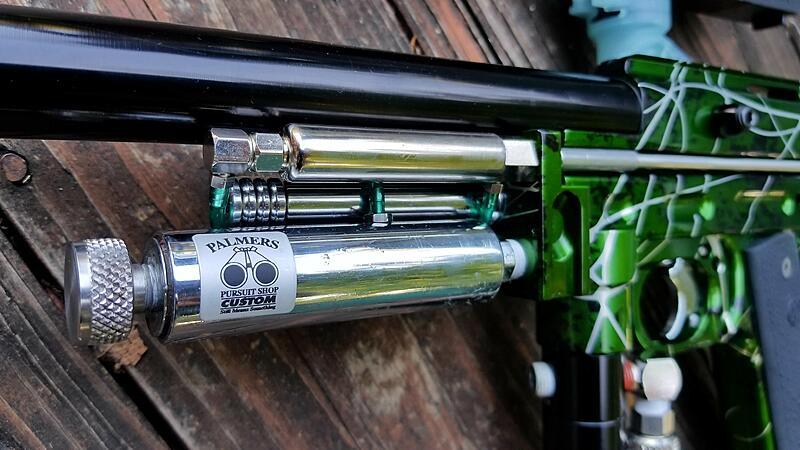

          After several months of waiting, and some very gracious and rapid resolution to a small issue, all parts had finally come back from anodizing. Everything was perfect. Assembly and timing was relatively easy.
          I rebuilt the Palmers Rock and QuickSwitch, but decided to go with a NOS WGP ram and my vintage QuickRam has a bent shaft. The best small bit was getting new silver Palmers decals to get things dressed up.
          I have yet to play in a game with this one, but it is chrono’ed and ready to go. Me, and 14 year old me, could not be happier.
          Parts List:
          -WGP Factory Autococker Body serial #21836 (1995)
          -Custom milling by KCCockerDoc
          -P&P 45 grip frame
          -Proline pre2k back block
          -Meteor front block
          -Shocktech pre2k SupaFly bolt
          -Belsales Rex Dialer and hammer kit
          -maggot SLPS spring kit
          -Evil high flow valve
          -Palmers Stabilizer HPR (CO2 capable)
          -Palmers Rock LPC (full size, CO2 capable)
          -Palmers QuickSwitch
          -WGP factory ram
          -KAPP low pressure chamber
          -Smart Parts All American Freak tip
          -DocsMachine FreakXL Bull Barrel
          Click image for larger version  Name:	20211003_131230.jpg Views:	0 Size:	6.79 MB ID:	185863
          Click image for larger version  Name:	20211003_125126.jpg Views:	0 Size:	3.62 MB ID:	185862
          Click image for larger version  Name:	20211003_125209.jpg Views:	0 Size:	3.87 MB ID:	185861
          Click image for larger version  Name:	20211019_170054.jpg Views:	0 Size:	1.67 MB ID:	185860
