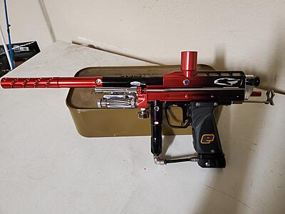

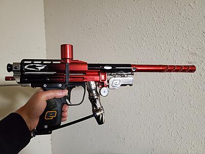

    OK so my son attended a PB bday party 2 weekends ago and it got my PB juices flowing again after about a 15-20 year break!
    I'm dealing with some information overload since in my spare time I've read every post and reply in this Autococker forum, downloaded and read the eblade manual, as well as trying to catch up on changes in the PB world for the last decade or two.
    Dug out an old cocker I got in a trade years ago and getting it ready to go play. Ordered some stuff online (no actual PB store around here) like seals, springs, valve tool, macroline, pneumatic hose, vert ASA, CP reg, ID on/off ASA, new eye, JT lenses, and sent my tank to be Hydrotested.
    This forum has been a great resource of information, but a few questions remain. I apologize if these have already been answered or are "obvious" answers, but my brain is fried now.
    Questions in no particular order:

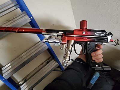

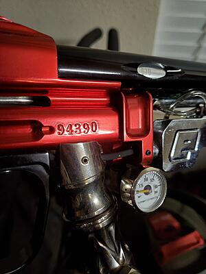

    1. Going off the serial # looks like this is a 2000 or 2001 body and other than the KAPP logo, dont know much else about it. Is this just a "FrankenCocker"? Don't know details about LPR/RAM, back block is Shocktech. Has a Rex dialer, some kind of Venturi bolt (getting blowback), and a green valve (just got valve tool in today, will disassemble tonight).
    2. I was under the impression Rex dialers were "older" parts? And it seems there are the "longer" 2" springs in there? Haven't got a chance to chrono it yet, but I feel that's gonna be an issue. New spring kit are 2" also (for the most part) I'll measure those too. Probably gonna need an IVG?
    3. Gun had a WGP reg on it, how do those compare to CP regs? Changed it out for comfort/looks mostly, tore it apart and cleaned it, looked fine. Just curious.
    4. I have a Hyperflow 420 bottle reg in my parts box, was going to put that on my tank when it gets back from Hydro. Tank is a Pure Energy/Empire tank, the reg I pulled off didn't have any markings on it. Wondering if the Hyperflow will still be better or have they improved on that technology and 6 year old bottle regs are just as good? Like I said, no markings on reg so I don't know anything about it. Side note: also have a LP MaxFlo manifold reg I could put on the bottle if I can get the gun running on that low of pressure but don't know if I want to try and then same question about newer regs as above.

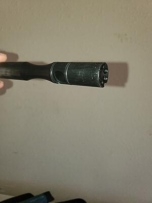

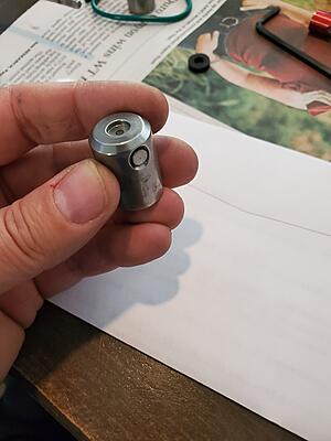

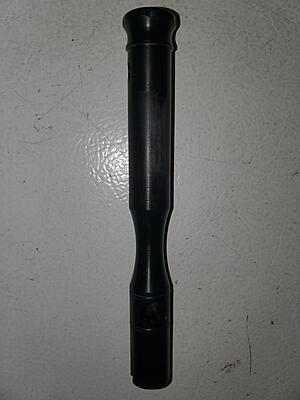

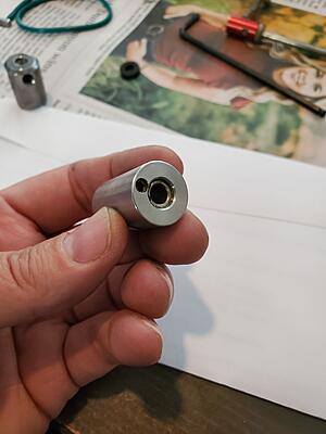

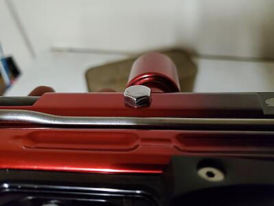

    5. I mentioned the bolt and blowback, bolt has a 90° air hole path and the venturi face, seems like that would restrict airflow, or does that not matter? Has the 2 Orings on either side of air hole, but not at tip, next ball shoots up from feed neck about 2ft high.
    6. This not a removable feedneck correct?? I tried turning it but didnt want to wrench on it too much. Want to do a adjustable feed next mod if not, any recommendations for that?
    7. Got a new eye since old wasn't working, wasn't showing a difference in sensitivity with bolt open or closed, hoping new eye gets that resolved. But if not, I have 2 VL 12v Revolutions, I think those should still feed fast enough (hopefully) correct? I reset the eblade to factory settings (fast), it's an E1 board I think? V1.06 when I turn it on.
    Well, I think that's it for now. I'll probably remember 4 more questions after I post this. Any help, input, or recommendations from you guys will help! Now to see if i can actually post some pictures!

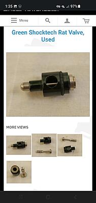

    Last picture is the only "green" valve I could find on the internet search. I'll look closer when I break it down tonight.

      I don't have a ton of information for you, except that the bolt is a delrin EVO bolt, made by besales.

          As for blowback on that bolt, just replace your bolt o-rings with something fresher and they will seal up better.

        • coyote
          • 966
          The body is what is refered to as a Kapp Classic. It's a desirable custom house body kit produced at Kick Ass Paintball products in Santa Rosa CA. Around 1999/2000.
          It looks like you upgraded with a full "Nexus kit" which was available as an upgrade over the eblade kit and included a bolt, lower tube internals, and front end components. Some of those parts seem to have we been replaced.
          Frankencocker for sure, but with nice parts. If it was a good shooter back in the day there's little need to swap parts out.

          Welcome to MCB! That cocker’s a great guy with some very nice upgrades. You should be able to get it up and running. And you can easily change it to a mech cocker or a pump if you decide and electro is too much or doesn’t work well for you.
          3) The WGP regs are generally considered good. Looks to be a black magic reg, which are nice. The CP regs are great too, offer alrighty different ergonomics. I run CP regs on most my cockers/sniper but have a WGP Karni reg on one and it’s need been a problem. Go with what you think looks better and feels nicer in your hand.

          lpr is a kapp, ram is clippard (looks bent in pic, maybe just the pic?). only green valve i could think of is shocktech rat valve.
          rex dialer is good parts, get it running and see how it shoots/check velocities. they came with matched springs
          personally like WGP regs and they work well
          unmarked tank reg is likely cheepo or possibly pure energy, modern regs are better. dont think maxflow lp may not output enough psi u need to check the range on it
          thats a good bolt -as stated check the orings on it, and check/adjust your timing for the blowback to start. also check that ram- it looks bent in the pic -its also not rebuildable (likely need replace, definitly if bent)
          that feedneck may be removable, almost looks like it in pic. take a pic of the bottom of the feedneck from the side, if there's a seem its probably removable (oring prolly dry and stuck)
          12v revi should feed that thing well. unless u can really walk that trigger faster than around 10-12bps

            On the RAM does the front look slightly higher that it should be?? Because I kinda thought that but attributed it to my old eyes. Since it's not rebuildable how do I know when it needs replacing? When it totally fails or is there something else to look for? If it's a little bent, but still cycles the boat fine, you think I'm good to still go with it?
            Upon tear down, it is a rat valve. Main seal was smashed down pretty good, that's probably why I needed a dowel and rubber mallet to get it out! Haha!
            That MaxFlo starts bleeding off at 240psi (I'm quoting the manual, I haven't actually done it), so that's a long shot on getting the gun to run 220ish I think.
            Gotta reread that eblade manual for terminology on the settings again. But basically set the bolt to start cocking a little longer than currently set to reduce blowback? Is that what you're saying?
            That's exactly what I was thinking for the feedneck! I saw that seam, took a picture. There are already some tool marks on a few places on the gun so didn't want to add more, but thought it should come off, doesn't look like a solid piece.
            And I suck at the electro trigger, so can definitely say I'm probably not at the 12bps!

            yeah thats a threaded feedneck, ur lucky. i think my kapp has one too (would have to dig it out to check). try some heat (heat gun or hair dryer) and a strap wrench or something similar to get feedneck off (a leather belt or rubber piece will help so u dont damage the feedneck)
            i would replace the ram, its going to further destroy itself when it cycles. u dont want it ruining anything else on the gun. it could be part of ur blowback problem too.
            i would- replace the ram, recheck the mechanical timing, and set the eblade to a factory setting and see how it shoots
            excellent eblade/autococker info- http://www.moodypb.com/cart/index.ph...a0377htlbsu4n2
            yeah 220-240psi is to low for blessed autococker.
            its lookin better already btw. do you have the original back block?
