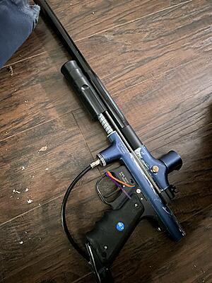

    So I have a trilogy and I had it working perfectly. It was shooting well with no problems. Then I was having problems with the hammer all of a sudden getting caught in the frame so I added a little bit of Teflon tape to the hammer pin so that it wouldn’t move involuntarily and that since I stopped any hanging up. But now it seems like no matter how far in a screw in the ivG or how I adjust the regulator , The ball doesn’t leave the barrel and I don’t get a solid pop whenever I dry fire.
    Is there a trick to setting up the high pressure regulator with the ivg without a chronograph? To at least get it going ? No leaks anyplace.
    Also has anybody seen this regulator before? It was working fine and now I’m not so sure

    Those Trilogy models work great with a gas through , no need to regulate. Throw a new spring in and get that regulator off and you should be in business

      Obvious question here also but is your bolt in upside down

        The reg is a Crossfire RDB.

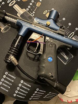

                  There is threads on the bolt that the thumb screw screws into to engage the hammer. It’s not a pull pin design.

                    So I put the air directly in and it still didn’t fire. Screwed in the IVG all the way and it barely shot the ball out 5 feet . Have 3000 psi in my tank , no leaks . Trilogy sport valve and everything .

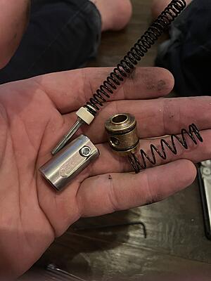

                        These are all the internals . What am I doing wrong ?
                          • 6182
                          Valve could be in backwards. Big hole goes towards the front

                            No, the valve was in the correct way. What I’m noticing is there in pictures of a trilogy sport the valve hole is a little bit smaller than mine. I’m wondering if somehow my valve is a low pressure valve? Because it’s got a bigger hole for the cup seal to wrap around. I just don’t understand how I had it working a few weeks ago and now I can’t find that sweet spot again
