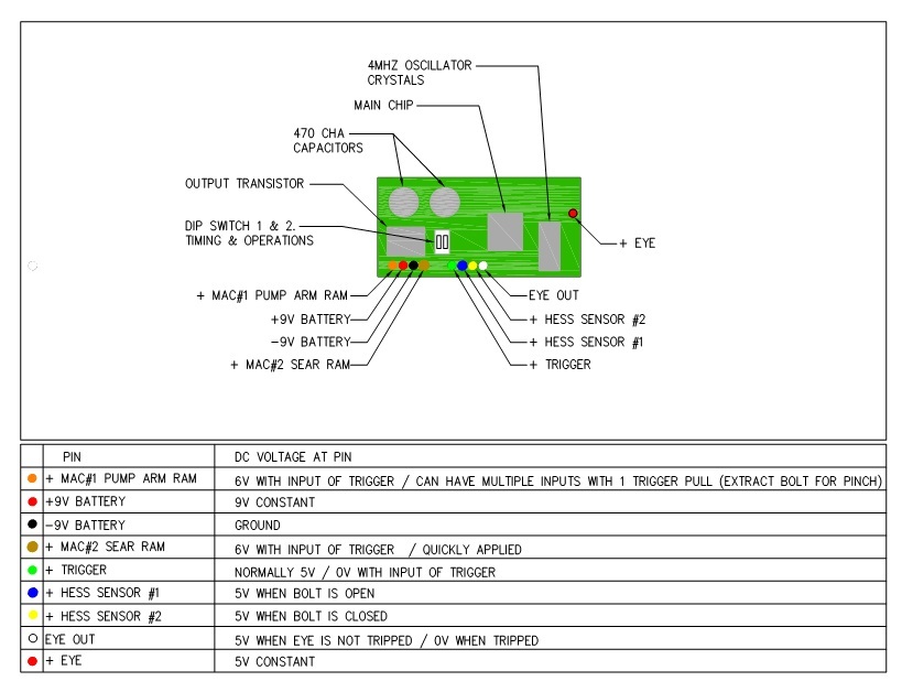

    Click image for larger version  Name:	afNE416.jpg Views:	0 Size:	91.0 KB ID:	347046 I recently got my Sandridge TF5 up and running and I have a few questions: Can I replace the 6v/1.8w Mac solenoids with more common 12v noids?
    Which dip switch is used for timing and which one is for uncapped mode? They both activate the timing led when switched on. Lastly, does anyone have the measurements on the sear ram? Clippard thinks it's 5" long and I don't want to disassemble it as it currently works, but leaks. Thanks for any help.
    Also, the board capacitors are Panasonic part number EEE-HA1C471UP for those that need them.

    I have a couple of the sear rams, though new-in-the-tube. To use on a Sandy, they need to be milled at a slight angle on the mounting face. The ram cannot be disassembled, it's crimped shut like the old 'Cocker "mini" rams.
    The Clippard part number on the tube is SDR-05-1/2
    And if you need one, the yoke type fitting- the saddle that connects the ram to the sear- is Clippard part number RC-0581
    Doc.
