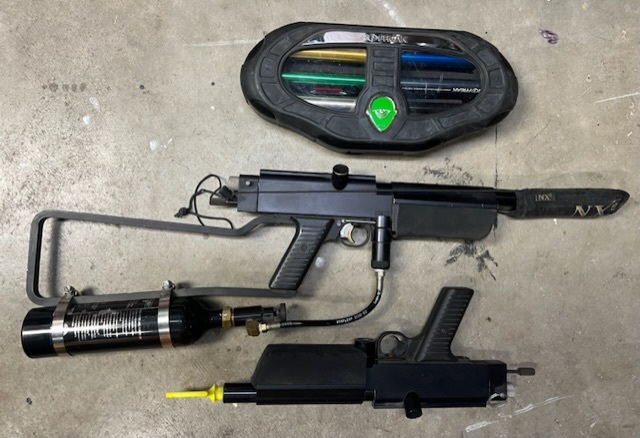

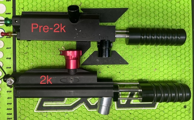

    While this likely common knowledge to most MCBers, I have a pre-2k and a 2k body on hand so thought I’d do a quick comparison for people looking to learn more about cockers. This is my first pre-2k cocker, so please feel free to correct me and/or add information.
    As is usually the case, what I have on hand is a little but of a hodgepodge, and not the purest examples of Pre-2k and 2k, but will give people the general idea. I’ll point out the oddities and people can chime in and expand on this as well.

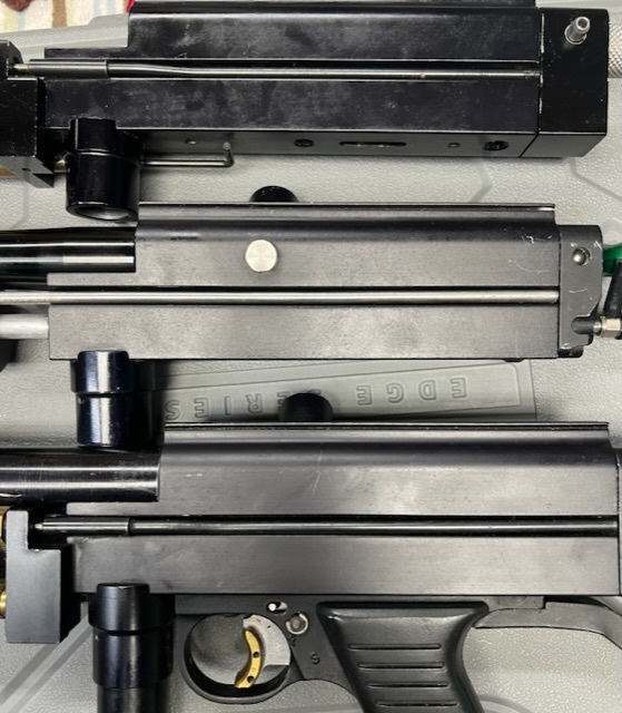

    with all that out of the way, I present to you a late pre-2k cocker body (approx ‘95) and a 2k System X cocker body.

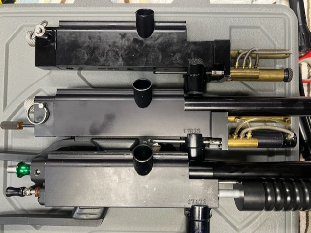

    UPDATE: ended up with a couple more pre-2k cockers so will be updating with more info. One is approx 1992 and has Sheridan internals and the other? I’ll find out when take it apart.
    Click image for larger version  Name:	63135D52-04DF-4F81-A790-D26E695DF461.jpeg Views:	140 Size:	107.0 KB ID:	379063
    I don’t have the cocking rod installed in the 2k body, but it will appear later. Note the back clock has a more angular design, almost a P-block, but it uses a standard 2k bolt.
    Now the Pre-2k has a 2k back block, which means it can run a standard 2k bolt. Stock Pre-2k back blocks are larger, and stick out more, so pre-2k bolts are longer. Either bolt style can be used on a pre/2k body as long as they are used with their proper back block. So 2k back block with 2k bolt or a pre 2k back block with a pre 2k bolt will work.
    Update: And here’s the couple more correct pre-2k lined up with my modified pre-2k body:
    This lets your really see the difference between a 2k back block (shown at the bottom) and the standard chunky back block on the middle and top bodies.
    For reference, the body that has the stock attached is serial number 17875 making it approximate 2005. My modified pre-2k the pump handle is a closely numbered 17472, making it the same vintage. The top body is 6805 which I believe is about 1992. Externally the bodies are all very similar if not the same. Internally, not so much.

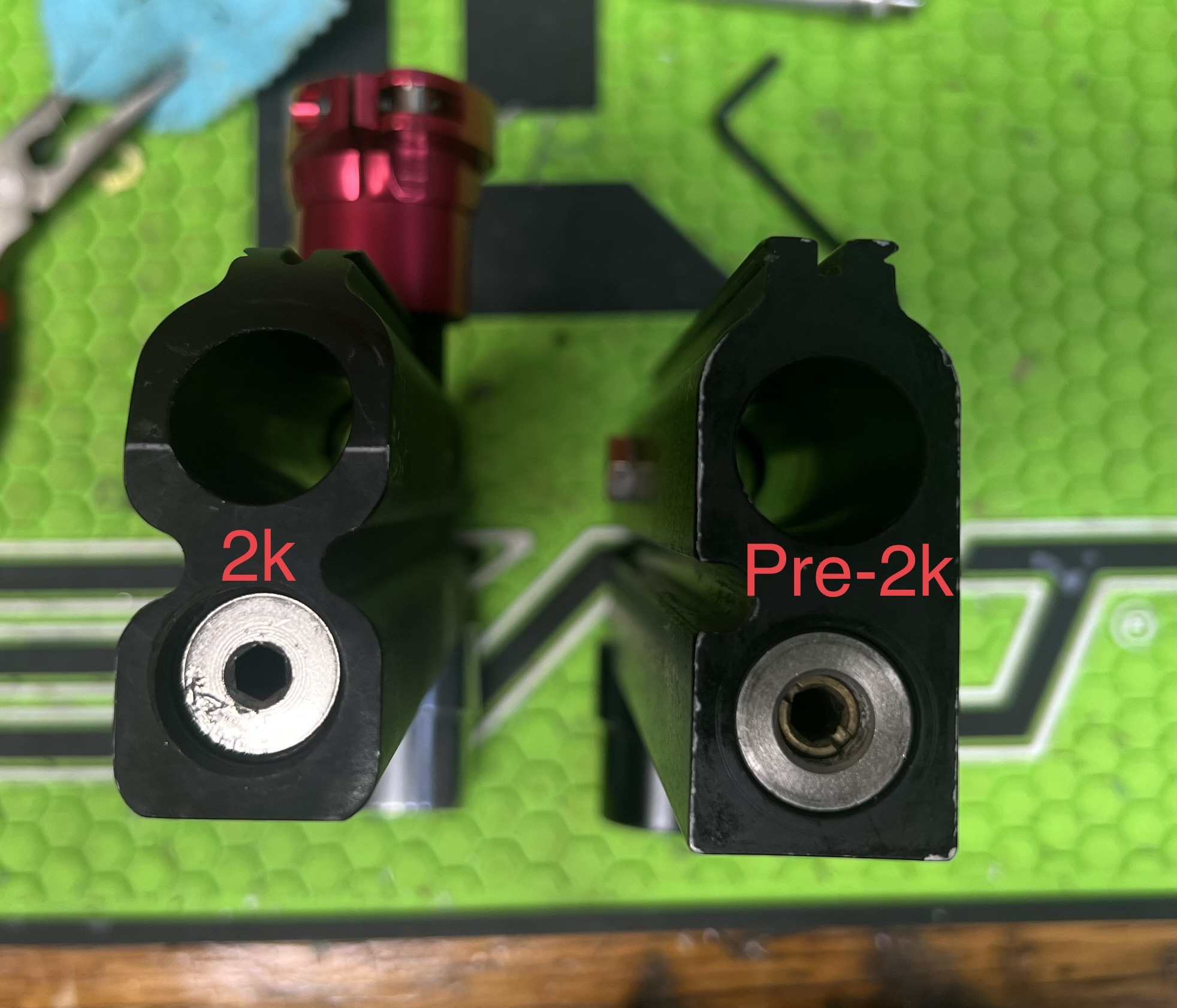

      • 4561

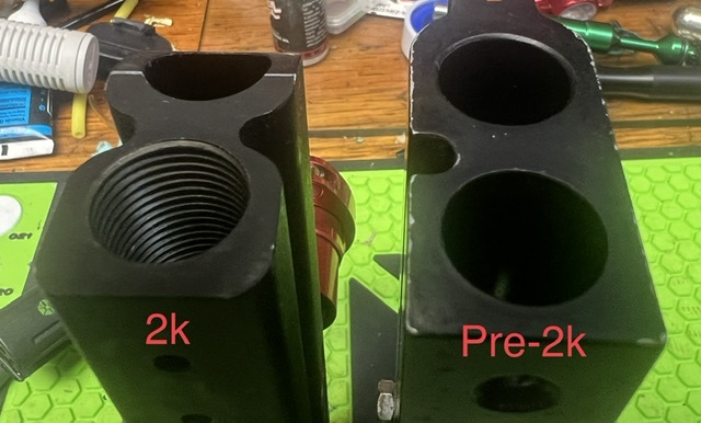

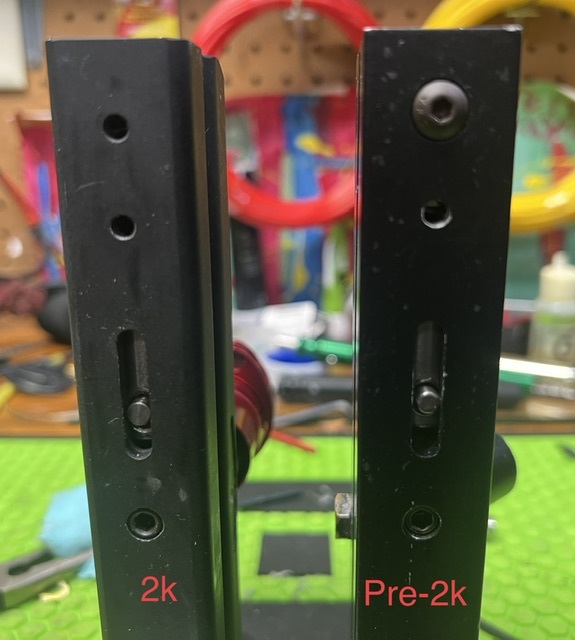

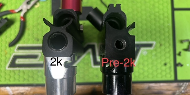

      Next we’re going to look at the body and see the differences in how the internals are setup.
      First, the view of the back of the markers. At first glance it looks pretty similar, but the IVG on the Pre-2k looks a little odd:
      Click image for larger version  Name:	430505AF-3526-4A75-8CE4-2299CBE77990.jpeg Views:	0 Size:	619.4 KB ID:	379074
      This is the second major difference. The 2k body has threading in the lower tube to allow for the IVG to adjust the velocity. The Pre-2k body does not have any threading. It uses an insert similar to what’s used in Spyders to hold the spring inside.
      Click image for larger version  Name:	F76FFDCF-1FF1-4DCC-9DC3-314CCDC78669.jpeg Views:	0 Size:	75.1 KB ID:	379075
      The IVG for the Pre-2k body is held on by a screw in the body. The 2k bodies have a similar screw hole, but that is used for mounting the beaver tail.
      Click image for larger version  Name:	D91A4209-C704-42F3-9D7C-8278CE74CBB0.jpeg Views:	0 Size:	75.8 KB ID:	379076

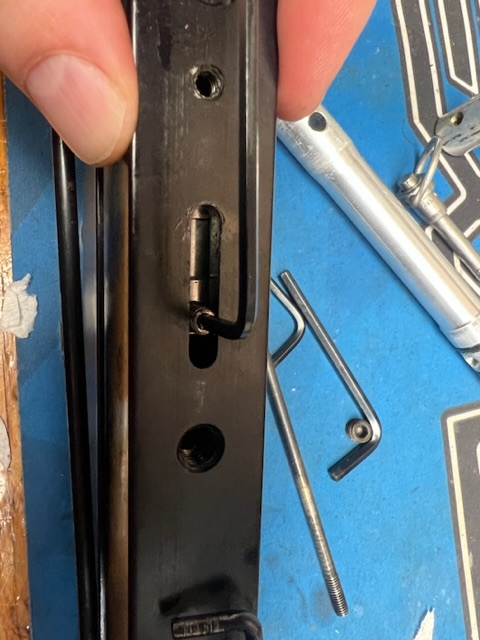

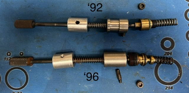

      Now here is where my older pre-2k differs from the other pre-2k markers. My 1992 cocker had Sheridan style internals, so different hammer, springs and valve.
      As there are no holes drilling into my body, you need to unscrew the hammer lug from under the body. In this photo my hammer’s lug has been install upside down, so you can unscrew it from the bottom. This is just a standard lug flipped.
      Click image for larger version  Name:	18DD7000-DCB0-480D-AD6D-2C63204EB12E.jpeg Views:	11 Size:	87.0 KB ID:	381672

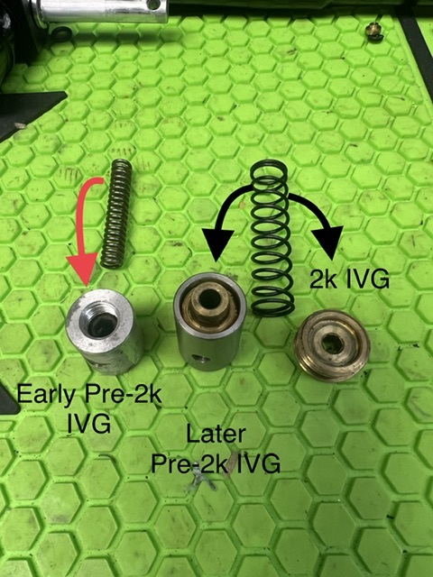

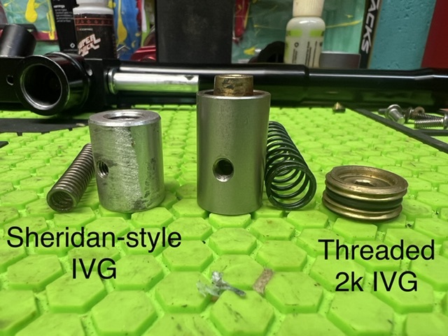

        And let’s look a those IVGs now. There is a sizeable difference between the three IVGs, with the 2k being much smaller and lighter. The early 2k is also needs different springs and is harder to adjust.
        In these next shots you can see the insert used to adjust the tension on the spring for the Pre-2k IVG. This version of the IVG is compatible with standard cocker main springs. The older version is not compatible with standard cocker springs and spring need to be trimmed to change velocity.

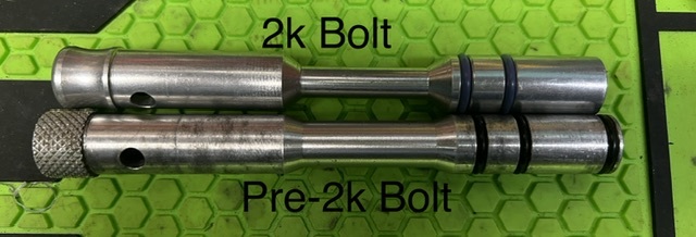

        And simply because I have room here, here’s a comparison of the 2k and pre-2k bolts. They are interchangeable as long as you use the matching back block (pre-2k back block with pre-2k bolt, 2k back block with 2k bolt):

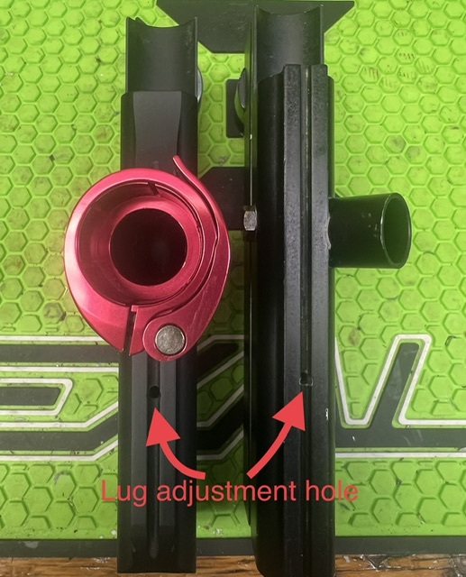

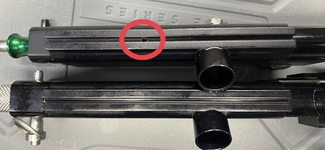

          Next we’re going to look at the hammer lug adjustment hole. Later model Pre-2k bodies will has this adjustment hole, but earlier models do not. Without having this adjustment hole you cannot adjust the hammer lug, which needs to retract to remove the hammer from the body.
          Pre-2k bodies with hole and without:
          Click image for larger version  Name:	DD34624C-34AF-4617-9097-60A3B8FF65B7.jpeg Views:	0 Size:	60.7 KB ID:	381674
          Hammer Lug Adjustment hole:
          Click image for larger version  Name:	09CD6927-A572-40F8-8F1E-23EC4798E249.jpeg Views:	108 Size:	111.6 KB ID:	379084

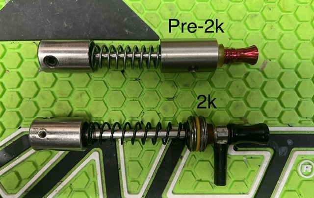

            To put things all together, here is the 2k and Pre-2k hammer to cocking rod assembly:
            Click image for larger version  Name:	6809A2DB-E029-416C-8E42-170EF6B28152.jpeg Views:	105 Size:	99.1 KB ID:	379089 Please ignore the strange spacers on my 2k cocker’s cocking rod. It came to me like this.
            my two other, non modified Pre-2k cockers have slight different internals, with the older version having full Sheridan internals and the new one having a standard cocker hammer, instead of a Sheridan hammer. The newer cocker has a very different valve though.
            Click image for larger version  Name:	4D7F0830-2432-4433-B2CD-AA8EA43FAF14.jpeg Views:	1989 Size:	76.9 KB ID:	381998

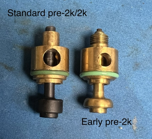

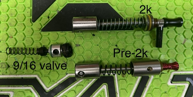

              Past the hammer, the valve is the same for both markers. There may be a difference in pre-1997 bodies, but I have no experience with them.
              Here is the power tube for both 2k and Pre-2k from valve spring to cocking rod:
              Click image for larger version  Name:	5E40452C-06C8-4680-BB16-F5C87EF2A397.jpeg Views:	0 Size:	87.9 KB ID:	379101

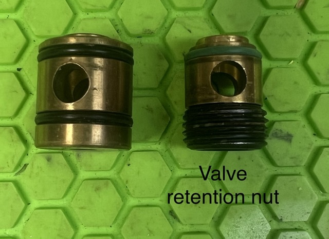

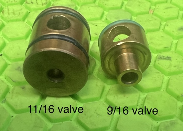

              And for reference, I’ll note that there are two different valve sizes for cockers/snipers. The 9/16 valve as shown above, for most Pre-2k and 2k bodies, and there is a larger 11/16 valve for 2k5 bodies (half block Black Magic etc) and Trilogy cockers:
              Click image for larger version  Name:	4E23D0CC-B100-41B3-929C-CD2309F97F3E.jpeg Views:	0 Size:	80.6 KB ID:	379102
              The 11/16 valve does not require the use of the valve retention nut and can be disassembled without the use of a cocker valve tool. For the 9/16 valve, so most Pre-2k and 2k bodies you will need a cocker valve tool to remove this nut to access the valve.
              Click image for larger version  Name:	B7807A77-DA9C-4B08-9C75-DB7DAF7EC8A6.jpeg Views:	102 Size:	84.9 KB ID:	379104
              And just adding in my early pre-2k valve compared to the standard cocker valve for reference:

              The earlier Pre-97 autocockers there is often a smaller valve chamber size as well.
              These like a shorter valve spring.

                  WGP moved to threaded IVGs before the increase in banjo size. Pre-2k bodies can have threaded or non-threaded IVGs.
                  You can use a non-threaded IVG in a 2k bodies. For example, I use a Belsales rex dialers in many 2k bodies.
                  IVG weight is negligible when you use an aluminum non-threaded IVG. (OTP made one)
                  non-threaded bodies have a slightly smoother finish in the lower tube.
                  The banjo size is really what those terms refer to, wether it was
                  Pre-2K = 3/8-24 threads
                  2k = 9/16-24 threads
                  within the pre-2k group there were a lot of design revisions / editions.
                  for example pre-95 valves were smaller with shorter valve springs. Stock WGP valve port size increased over the years.
                  Pre-2k VASAs are squared off - 2k VASAs match the body bevel.

                    • 4561
                    Found two more pre-2k cockers and I’ve updated the thread with more info and more pictures!
                    Click image for larger version  Name:	6B22A20A-8E61-4491-A2BE-E3A1C6F8C35F.jpeg Views:	0 Size:	95.2 KB ID:	381538
