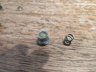

        Leave the brass fitting on the LPR attached to the marker. Unscrew the LPR from the rear brass fitting. Remove the Pressure adjustment screw, make sure your LPR seat is good, post picture. If it is bad you are venting HPR pressure to your pneumatics. If it looks good, double check it is seating correctly: screw the adjustment screw all the way in until the reg seat meets the LPR piston. reassemble and air up. the back block should be loose with no pressure. this will check your seat.

          You know the spring is bent and kind of rusty and the seat has kind of some markings in it where it looks like the spring has been digging into it. I ordered new ones and I have them but I thought I would just try to keep them as spares but I'm going to go ahead and replace them. I am unfortunately out of air because when a hose blows off who would have thought lol it uses lots of air I'll have to circle back and let you guys know if I can get it working once I replace the seat and spring

            material looks okay - try flipping it. Replace is best. replace spring. Empire, wgp, HPR & LPR reg seats will all fit. inception should fit too but I have not checked.
            Check and post picture of HPR seat also. include the new & old spring in that photo.

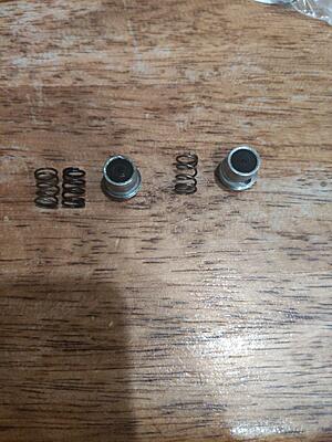

                LPR on left. Old spring far left, new seat. HPR on right. I threw the old spring out. New seat installed.
                • latches109
                  latches109 commented
                  try the old spring in the lpr
