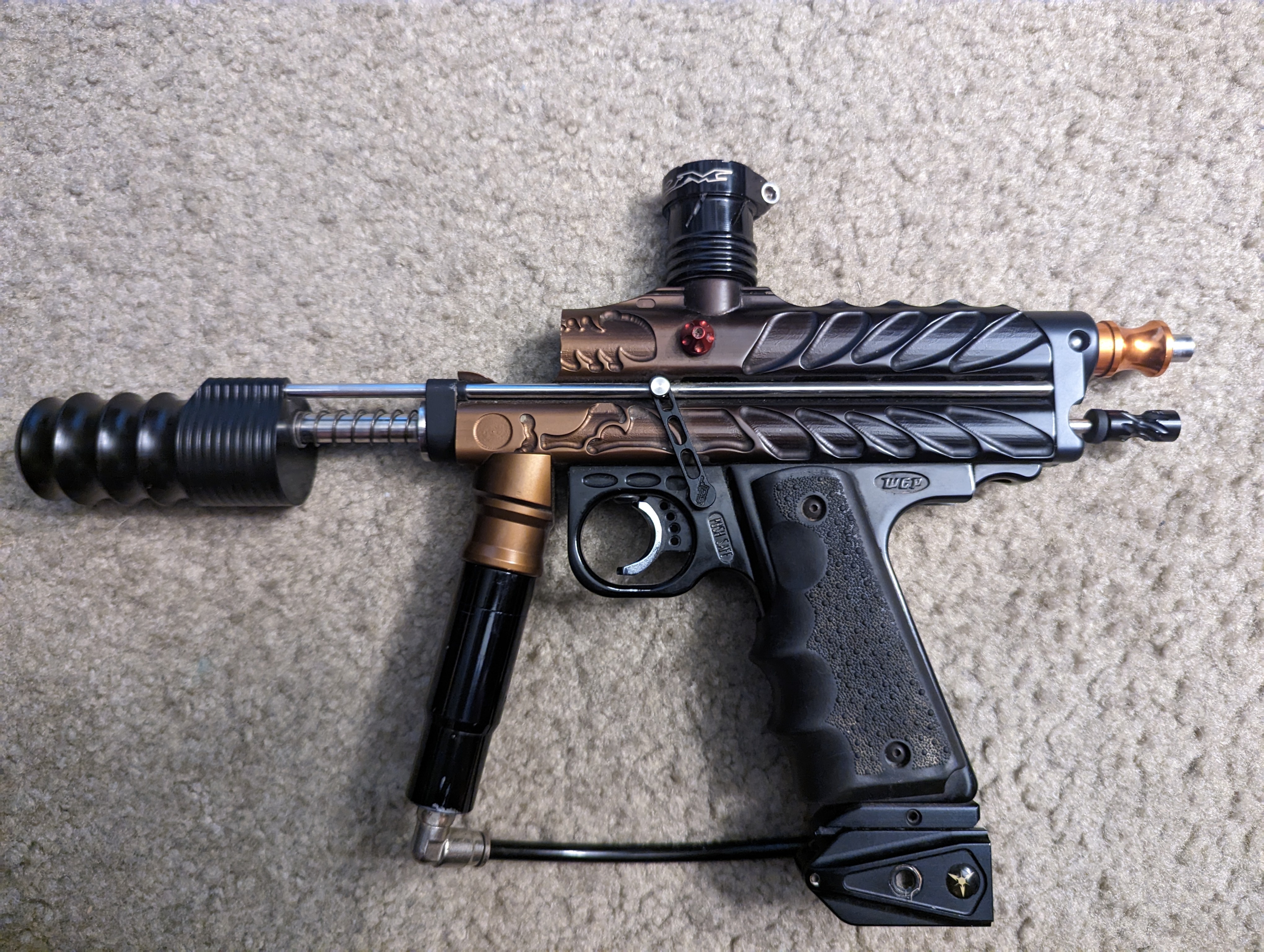

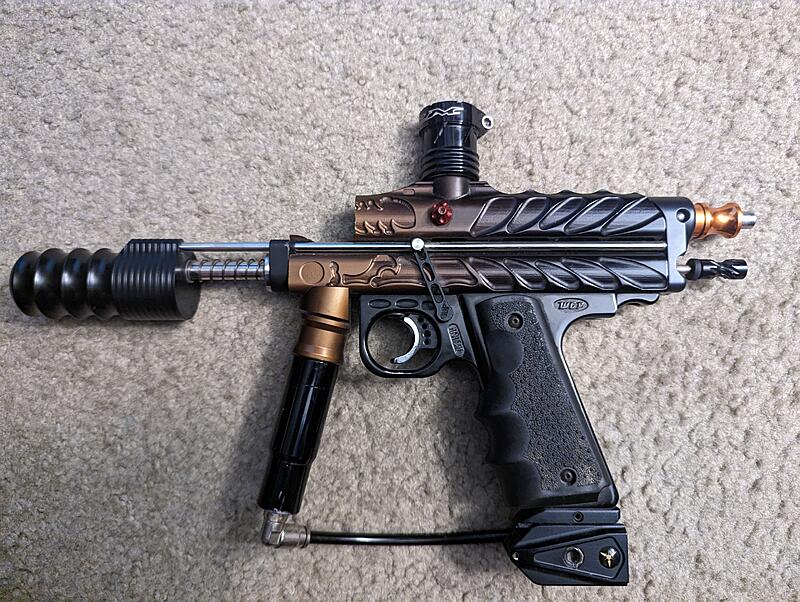

    I've been playing with the dragon for a few months now and something just feels off. I think I'm not used to the sliding trigger, are there any pivot trigger frame recommendations that will work here? Does a pivot single trigger even exist? I'm not even sure what frame I have other than its WGP. Cockers are still a mystery I am unraveling.
    Also having an issue with the auto trigger. Normal pump/fire works fine. When I auto trigger it doesn't catch the hammer and wont fire. If I play with the hammer screw a bit it may catch every now and then, but when it fires it has just enough air behind it to roll out the barrel. I've tried going from one extreme to the other with the screw. Any other settings I can check?

    Timing sounds off. Adjust the hammer lug so that it fires 1/8” before the back block touches the body. Adjust 1/4 turn at a time till you get it right.
    If you have orings on the bolt put smaller ones on and it will smooth the pump stroke out. Pretty sure that return spring goes inside the handle to not the outside.
    You could always grab one of Mozaks frames he makes some nice stuff in various popular styles. CCM stuff is really nice as well but you will pay the scalper tax.
    If you swap out the frame I would go with a dust black Mozak if it were mine. I really think it’s just a timing issue.
    That’s a sweet dragon body BTW.

      I'll keep playing with the timing. Superman mentioned the trigger plate adjustment, which I haven't tried. Bought this one 2nd hand, and that is where the spring was, I don't see anywhere else for it to go. I'll keep an eye out for Mozak

    ccm frame. I have some listed in the misc section.
    auto trigger should be timed so that it fires with an 1/8th in gap between the back block and body.
    If your frame has trigger plate adjustment screws make sure they are adjusted so that the plate sits flat on the bottom of the body and is not sloppy as it will cause those timing issues.

      Everything about the trigger feels sloppy, I'll try adjusting the trigger plate. You have a link to your frames? I got lost going through your sales posts lol

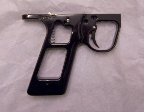

    Dye made a single swing trigger frame for WGP Autococker/Snipers:
    You can also use old school Sniper Pot Metal Frames were stock with swing triggers. They did not become sliders until the advent of the Autococker (derived from the Sniper II). You can also adapt AGD CF Frames to work with snipers. Pretty much any AGD spec frame can be adapted to work on a sniper with a swing trigger but you would have to find the correct swing trigger. superman has some currently I think.

      I do have the trigger/sear or whatever.
      Those frames were really nice for pump play but not using an AT.
      Autocockerparts makes copies of those too.

    They aren't easy to find, but Sanchez made a single trigger hinge frame for cockers. IIRC he may be back around again so it's possible you could find a new one.

      Another option would be the inception designs single hinge frames. those were nice too. Not all came with autotriggers, but can be modified to accept it. I have done a few.
