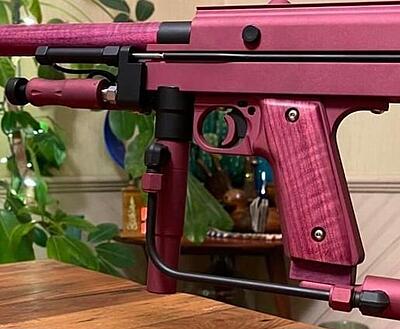

          Cerakote imo is probably the only option. I have done quite a few smaller detail parts with pretty awesome results. Don't forget to properly prep the surface so the coating sticks. I blast with garnet sand and that seems to work. Trigger control is very important. Overspray is very easy because cerakote is very thin. You can most certainly spray threads and assemble components. All of the black parts in the picture are creakote "armor black heat cured".

            Nice. Yeah I think I have just accepted that this is the way since some of the parts are nickel plated brass, some are steel. May just accept the actual barbs as being silver colored or I may get the raw brass ones and color those as that’s a much easier and safer process and I am not sure how easy you could shoot the barbs them selves without issue.
