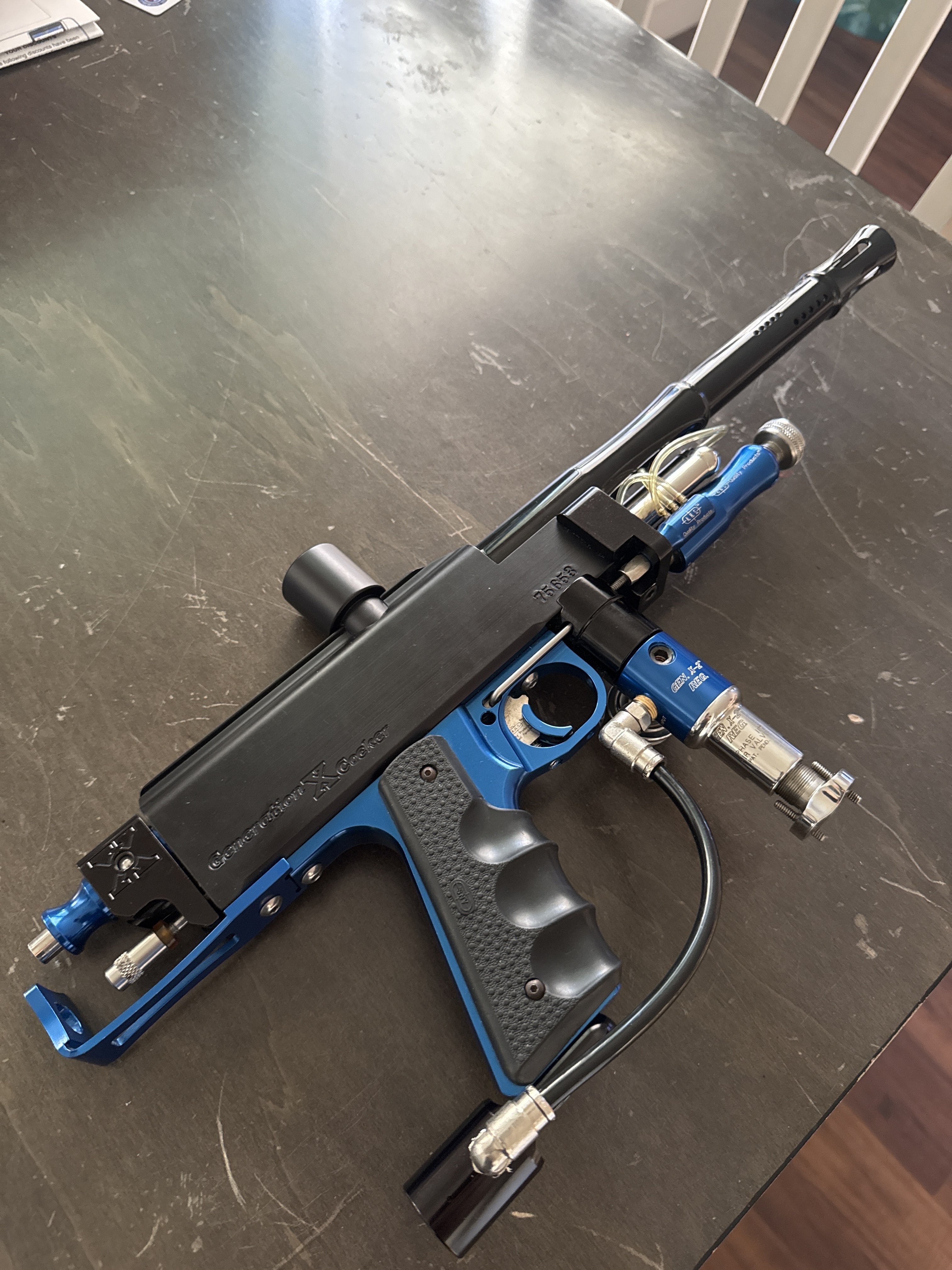

    I bought an Autococker for the first time since 2001. Thing is MINT and I want to grab a couple barrels for it and a possible minicocker build. I have a couple questions regarding size and bore. I’m planning on an OG Dye Boomstick (yes I know they are heavy lol) and possibly a SmartParts All-American.
    Can either of those barrels be bored for Freak inserts? What is the most efficient barrel length? I think the Boomstick I had as a kid was 14” but honestly I don’t even know if barrel length matters all that much

          those early vert feed WGP spec bodies are awesome! nice pickup. Get a late 90s style 14" barrel, freaK, UL, OR any once piece that can be freak bored.
