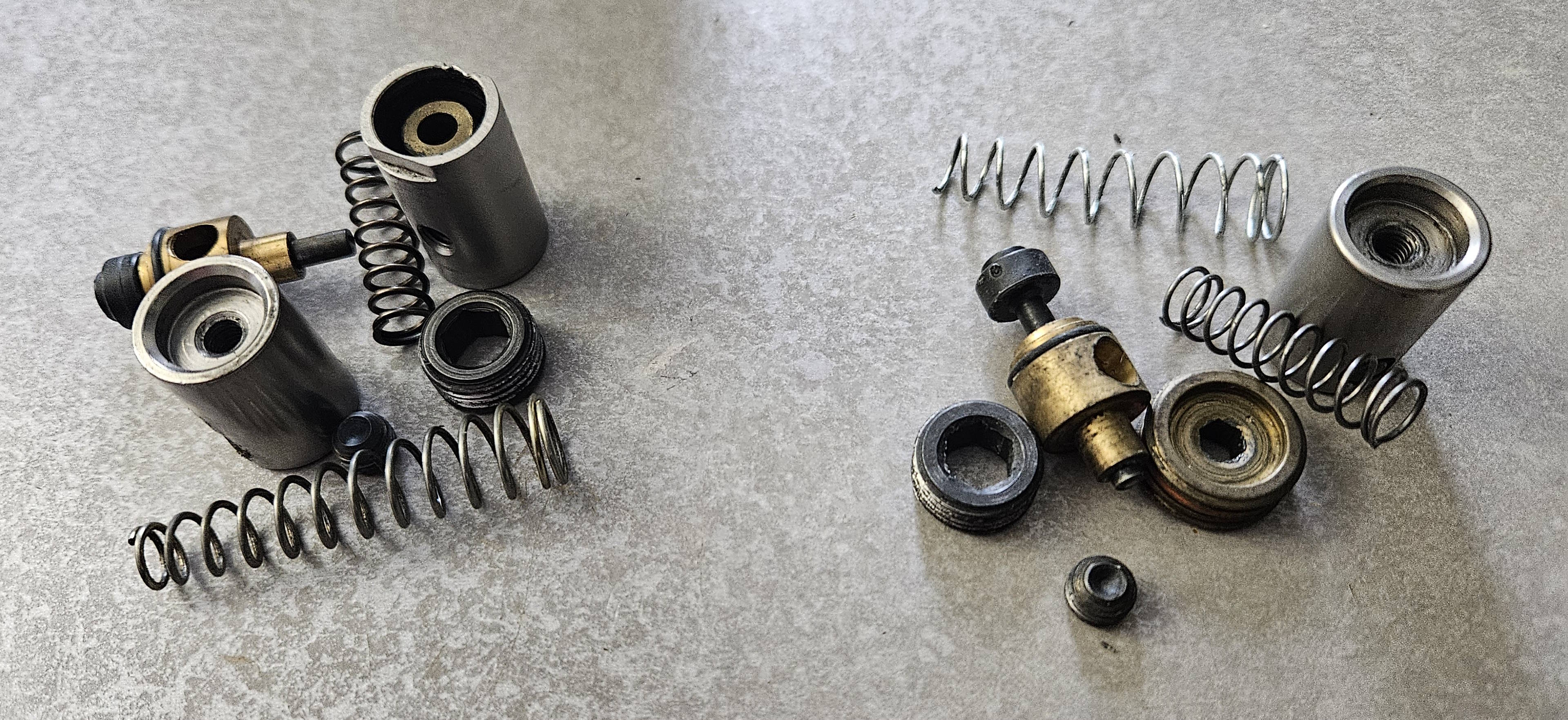

    I don't recall coming across conical springs before, but just found two in a row in what looks to be otherwise-mundane 2000-2004 cocker's valve sets.
    Are / were these common? Is there a specific outcome/application for them? Not getting anywhere on the googles

    Not super common there was one of the suppliers over the years that used them but I do not remember who. For our purposes not necessary but will no hurt operation given the spring rate is correct. I have used random compression springs in my setups from all sorts of sources I just pick one that has the rates, diameter and length I'm looking for. The one on the Right side has been clipped by someone which I will do but they should have dead ended the spring after clipping for less wear damage and better spring rate consistency.
    The one advantage is you theoretically can use a longer lower rate spring when using a conical spring to get less valve bounce and farting but I never tested out this theory as I rarely care about a little farting I do it often

      Main benefit that I am aware of is they are naturally resistant to bending. If you compress one it should be less likely to develop a sideways bulge than a straight spring will. I've used them in Nightmares for that reason.

        Kind of thought the wide end fit the valve chamber and the narrow end fit the cup seal.

          I seem to recall that's how older Spyder valve springs were designed.

        spyders are set up that way (conical on the cupseal) but both the sets I'd pictured had the conical on the hammer side.

          I made the assumption that since the valves were bagged together with a PPS 3-way that they were 'Cocker valves, perhaps PPS as well.
          I'd have to take a closer look at the valve stems. If they are cut for blowback, they likely match Kingman.
          Speaking of Kingman, I have a Spyder I bought in '97 (98?). Way back when.
          The cup-seal spring is not tapered, but centered by a fingered washer. Hard to explain, I'll get pics next time I dig it out.
          For the 'Cocker, I would assume (there's that word again) that being a mainspring the wider end is pocketed into the hammer and the smaller end pushes back against the IVG, being centered by the cocking rod.
