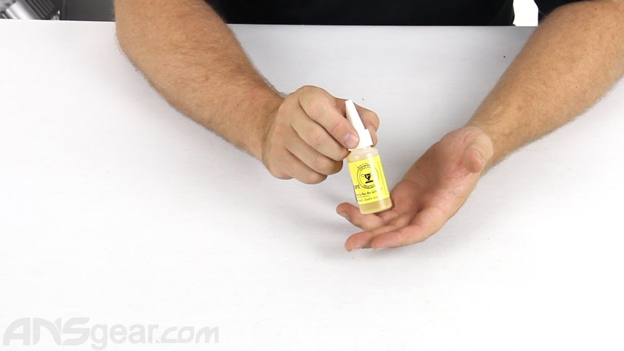

    Gold cup
    Because I got a bottle of it in a lot of gear
    The differences are... Nothing
    • Toestr
      • 2875
      • Poland, Onterrible
      Ya, Goldcup, Tippmann, Eclipse, Empire. Doesn't really matter. So long as it isn't water weight like WD40, you're golden.

        I've used Gold Cup for years, and am now stuck in my curmudgeonly ways.

          I used to use Gold Cup, but once my old 8oz bottle ran out, and I found the price had doubled, I started searching for options. Nothing wrong with Gold Cup, it's just overpriced these days. My old bottle was from around 2000 and lasted till 2015 (mind you I didn't play from 2002 till 2012). When I bought it, the price was $13, and in 2015 the price was $25 for the same 8oz. The Super Lube is far cheaper, and works just as well.

        Absolutely ZERO reason to buy some "special paintball oil" when you can go buy a bag ass bottle of synthetic air tool oil next to nothing.
        With that said (and to be fair) having acquired several gear back sellouts over the years, I have likely had to throw away more bottles of lube/oils/grease than any one individual could EVER use. I have everything from the AKA oil, Eclipse, Gold Cup, and much, much more. I seriously have a shoe box full of various oils and greases.
        I have noted that of all of them, Gold Cup will turn dark and get thick over time. I have not seen any other of the oils do that. I suspect the AKA and Eclipse oils are a "mineral oil" type. They have stayed clear and good for a long long time.

          I've seen lots of people talk about Gold Cup turning dark, but oddly my old 8oz bottle from around 2000 never darkened or broke down before I ran out in 2015. Must have been a lucky batch.
          My bottle leaked all over my tool box. That my only gripe with gold cup.

            Just like Rory... Always have and most likely always will use Gold Cup Oil.
