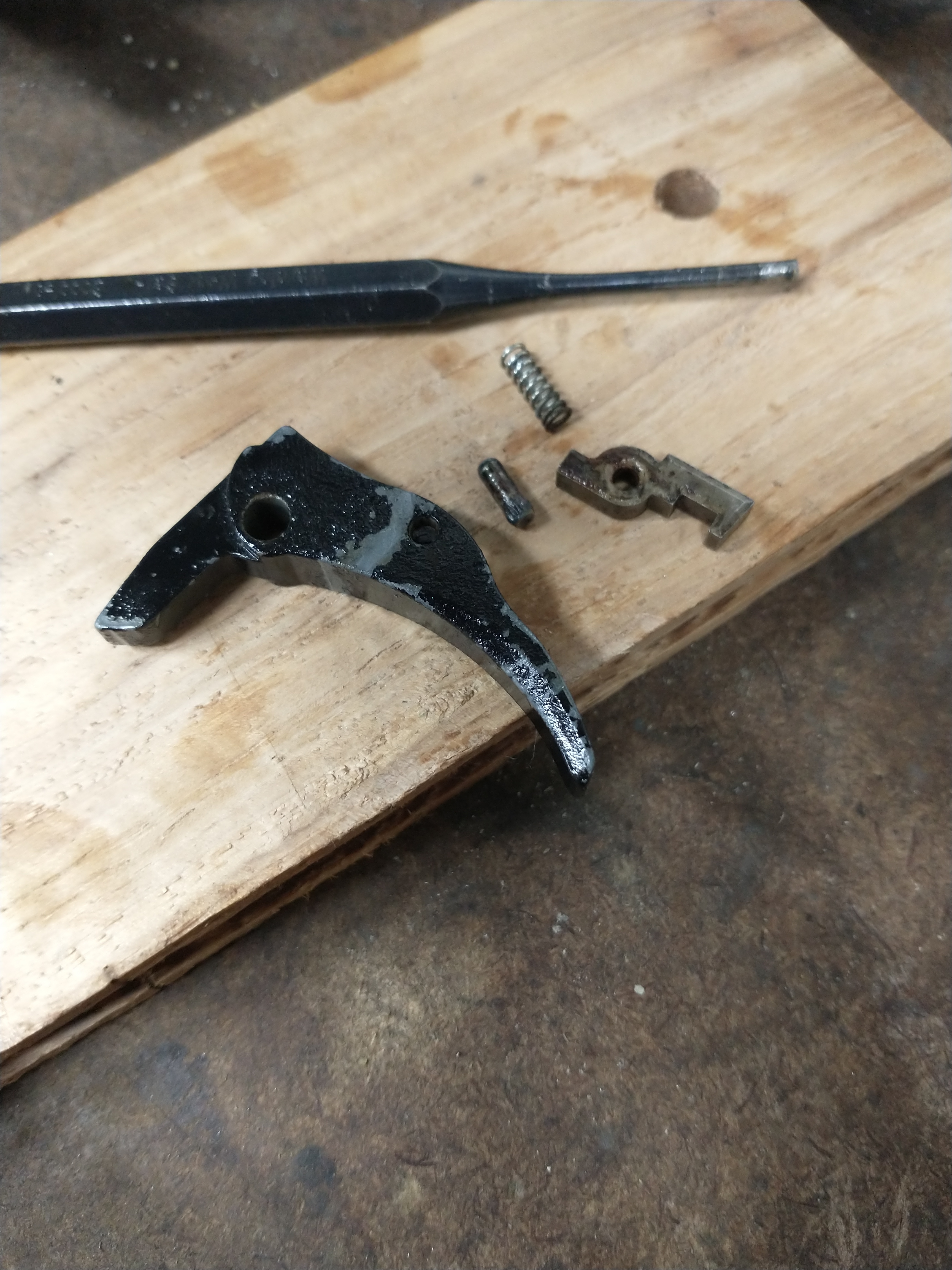

              Some of these markers came back to me this summer with sear engaging "flipper" on the trigger crusted up, which i had failed to take apart and sand smooth before. These get stuck back in the crust and the trigger won't grab the sear; it just moves back and forth.
