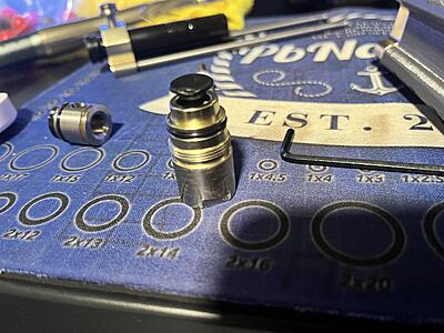

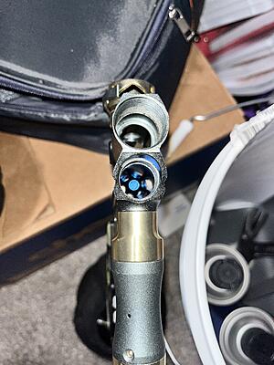

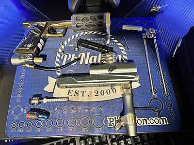

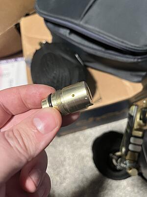

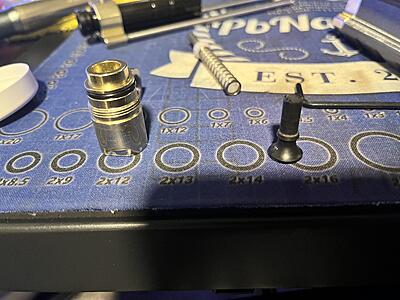

    Whats up guys? I got my lazarus valve in the mail for a cocker build I am doing and got a little antsy to test it out. Fit great, only hiccup was the purge hole in the front pump rod block for the zero system. Plugged it with an old autococker pin I had lying around and we were in business. Shot was definitely quieter and initial testing had what appeared to be a useable shot at about 150psi. I have a chrono showing up this week and should be able to get it into final tune and see where it sits.

    Nice! Does it alleviate the typical fart as well?
    • Slowzrally
      Slowzrally commented
      Without any sort of tuning, there is no fart noise. I will post more results once my chrono shows up and I can get it dialed in. Definitely a hefty sound reduction from the absolute hand cannon they are in stock form.

    Damn thatโ€™s low pressure. How reliable do we think the valve will be over time?
    • Slowzrally
      Its so new, only time will tell. But just judging by initial quality observations, I would be surprised if this valve causes us any issues in the long term.

      Did you have to replace the main spring? I read another thread where someone with an empire sniper had to go with the lightest spring possible after installing the Lazarus valve. Also curious about any other updates in general!
