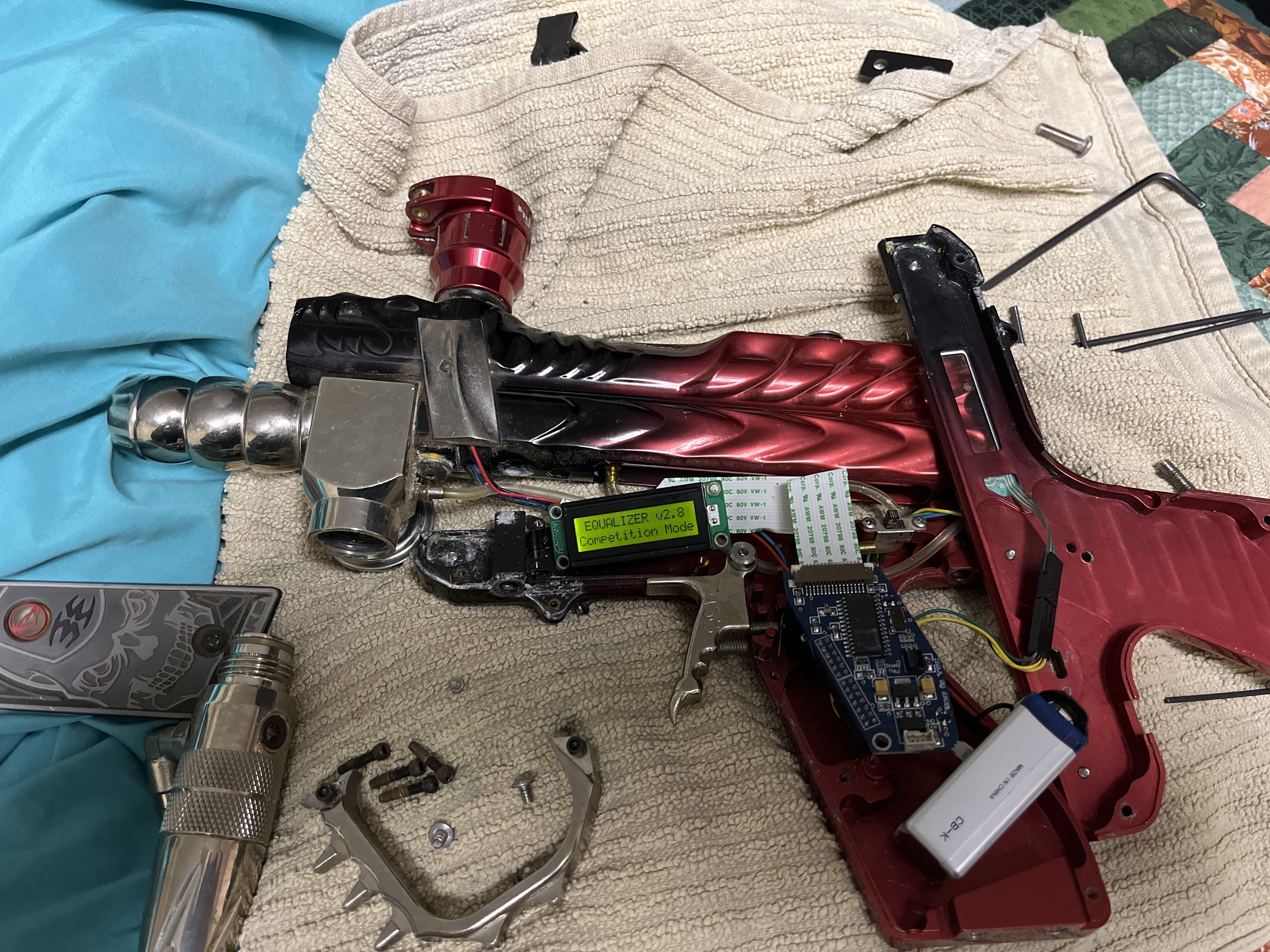

    Looks like it’s in decent condition. Stock torpedo reg, missing one red eye jewel. WAS Equalizer board firmware v2.8. Empire grip scales, hybrid clamping feed neck. Evil delrin bolt.
    The buttons next to the lcd don’t seem to do anything - do the membranes wear out? Any way to replace them? I can get it to turn on and the noid clicks fine but I can’t get to any firing modes besides semi. Il have to replace the power switch or some of the wires going to it - power is a bit finicky.
    I have hose, Dow 55, and an oring rebuild kit so I should be able to get it rocking again. Any ideas/suggestions? Need new grip frame screws - old ones are getting rounded out. Looks like an adjustable back cap is a standard upgrade - this doesn’t have one.

    Nice that it has the WAS board. The membranes definitely wear out, but you can short the pins on the connector with an allen wrench to navigate. An adjustable ram cap is a great upgrade but I don't think it needs much else. If you want to get a fancy install a roller trigger and Sci-Fi board.
