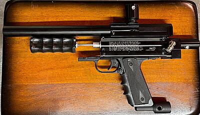

    Hey guys, hope all is well. I have a 1998 Rainmaker that I bought in 1998, along with a refurbished one that I robbed the board and some other parts from to keep my original one running.
    After some videos and reading I decided to turn my leftover parts into a pump. So far I removed the pin in the body that trips the sear, took apart the stock ram to use as a pump arm, and made a slightly shorter connection rod between the hammer and bolt.
    With this I can cock it and all, but not sure which direction to go with a trigger frame. I have an extra stock trigger frame/trigger that I was going to mess around with. Some folks mentioned an Angel ir3 frame can be modified to fit. Was wondering if anyone who did it could let me know what kind of sear situation they used and in what frame?
    Also if anyone has an extra rear block/HPR assembly laying around I’d definitely be interested. Thanks guys!

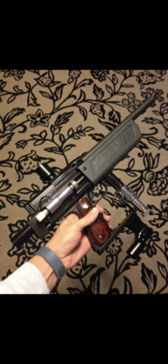

          There’s a decent amount still there. I think enough to make a pump out of it, once I figure out the sear situation that is. But to restore it to its normal semi condition it would need the front plastic covers, ram, and board. The rear block was gutted so it would need either a new one of those, or an Automag vertical asa and hpr like my original one as pictured.

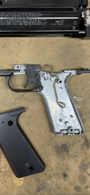

                    I don't know if the original question was answered, but the pump sear tripper was a bent rod directly attached to the trigger on an Angel LCD frame. I can't remember if it was pressed in or tacked. But the rounded part of the bent rod would trip the sear. Bang.

                    Thanks Magoo, I was messing with a straight rod attached to the trigger originally with no luck. I’m glad you mentioned bent rod. One coat hanger and pen spring later I have it reliably pumping and firing. A little janky if I do say so, but it works for now.

                        Made some good progress the last week. My coat hanger sear is holding up well and managed to get a sniper pump handle mounted. Just need to find a non-jacked rear block to finish the ‘ole girl.
