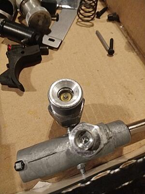

    I am inexperienced with all things Co2 so im sorry in advance.
    Trying to get a Brass Eagle Eagle running again. The old puncture seal isn't sealing properly. I used an oring to seal it but it falls out after removing the 12g.
    Are there any replacement seals? I have a quick changer and it looks like it takes the same seal.
    It looks like phantom may have seals but i don't want to spend $10 unless i know it works.
    ​​​​​​​the picture has the quick changer in top and the valve assembly of the Eagle on the bottom

    I made this tutorial for the splatmaster, but it can be applied to any 12g seal
    Make a 12 gram seal for the splatmaster in 10 minutes with some basic tools. 1/2" teflon rod from amazon $20 1/8" drill bit Hand drill Hacksaw file Vise grips or pliers Calipers or some other measuring tool vise/clamp just make the seal wide enough to press tightly into the valve body. I find this to be around 0

      Thanks quick and easy!
