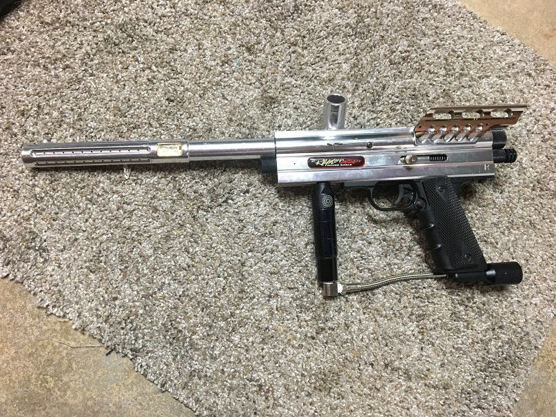

      And the first one up is the first build!
      True to the time period, this is a single trigger frame with a wire detent. It's almost exactly a copy of my Raptor when I first got it. Then I maxed out the bolt-ons - Eagleworks barrel, TASO sharkgill rail, thumb velocity adjuster, LAPCO cocking knob, the ASA is Viewloader because I couldn't find LAPCO but still aftermarket plus the stock WGP regulator that was very common to put onto blowbacks at the time as Cocker owners would upgrade them and sell the old ones for $20-$30. Not everyone could afford a Stabilizer, they were $75-$120 even back then.
      With a setup like this, you could show up on a field, maintain consistent velocity, mount a red dot and generally look badass.

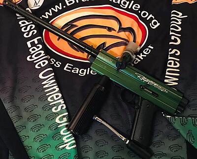

          I kinda wanted to do the same thing, but to a lesser extent. I was looking to recreate my first non-plastic marker.
          Took me a while to track down all the parts, but I basically got a clone of my first 'decent' marker that I had back when I was like 16 in 1996.
          I found:
          NiB Green Raptor
          NiB BoB Long Cyclone Bolt (took me 2 years to find this bastard)
          Taso expansion chamber
          NiB 32* Nightstick (I think - this is a placeholder barrel)
          I'm still looking for an old green All American and nice green smart parts wood grips. This thing actually shoots surprisingly well!

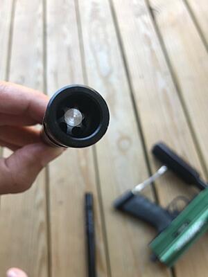

                I want to see the bolt kinda.
                • dartamon
                  • 394
                  It's a venturi bolt with a central insert. Just restricts the flow, cone out the stock bolt or get a delrin one.

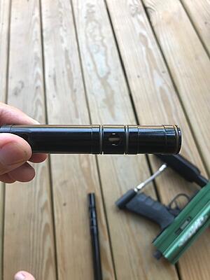

                          gotcha covered! Bob Long Cyclone bolt:
                          • dartamon
                            • 394
                            Neat! Different than I remember.
